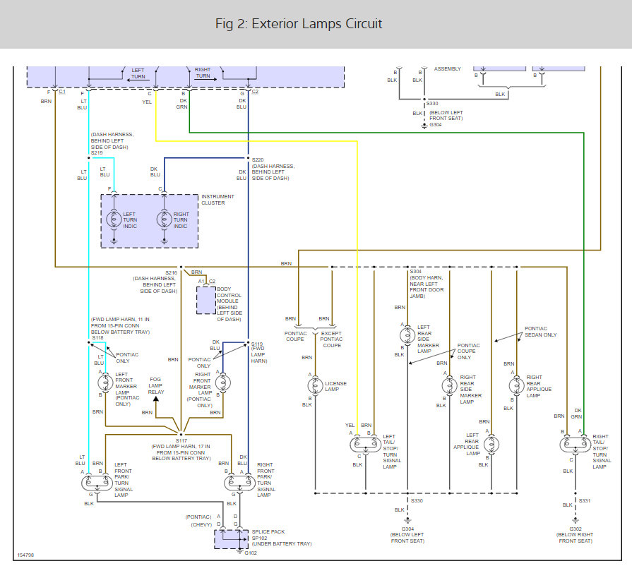

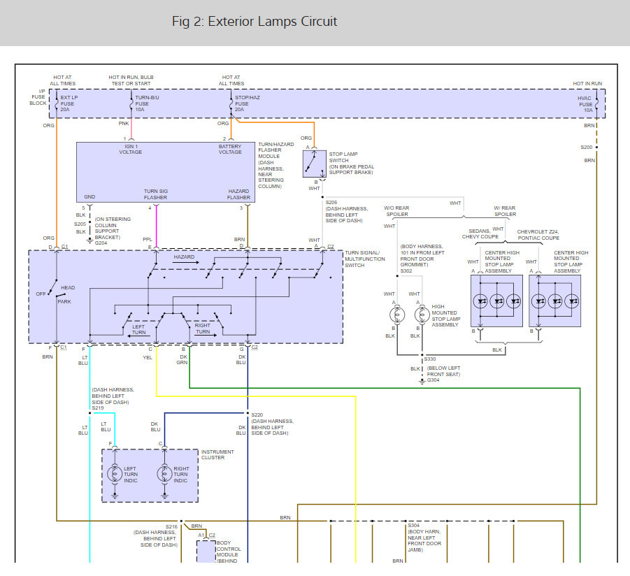

Will not work properly. Replaced the multi function switch, still not working.any ideas ?

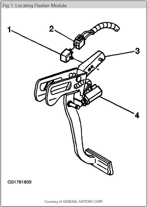

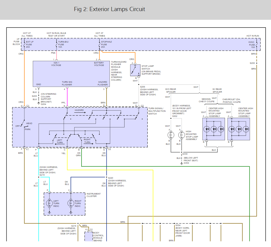

Yes, it sounds like the flasher module has gone out but to be sure here is a guide and the blinker wiring diagrams so you can confirm the failure along with the flasher location:

I replaced the flasher module still no blinkers. So I replaced the hazard relay the lime green one, and bingo I have got everything blinkers and four way hazard lights working. Thanks for your help!
