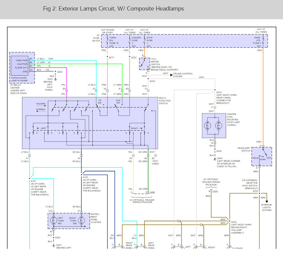

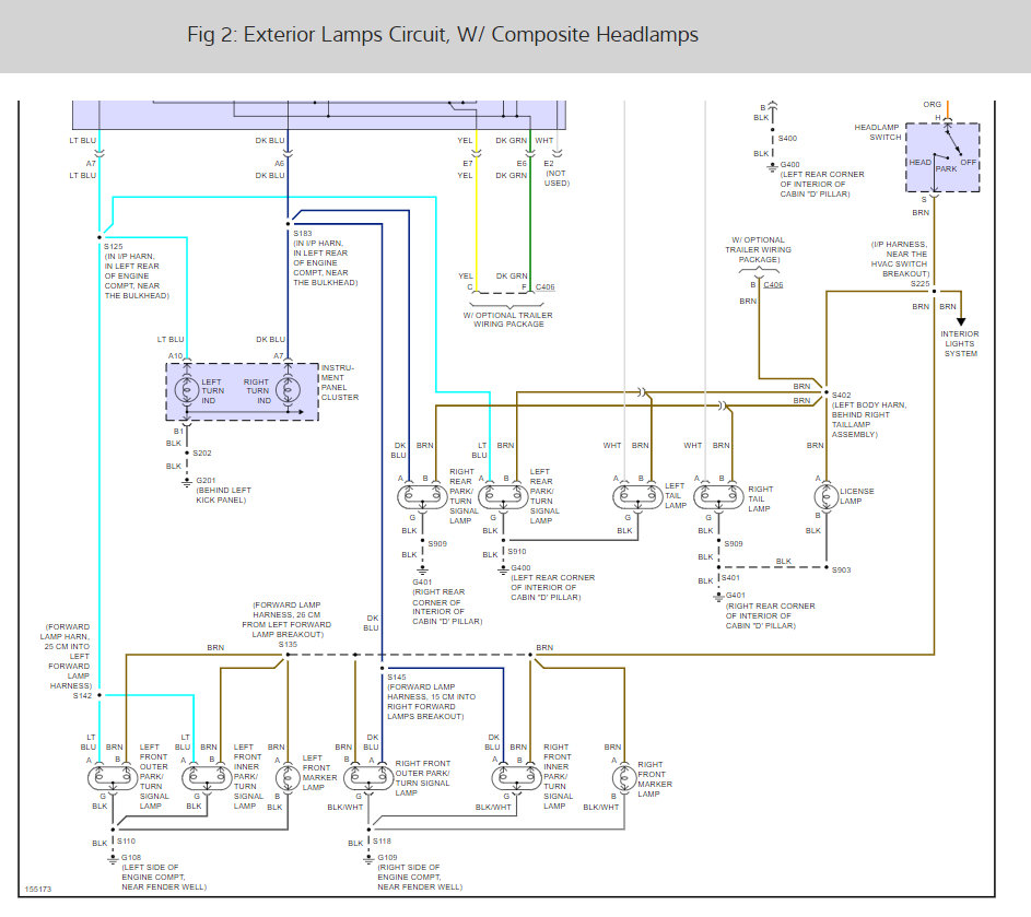

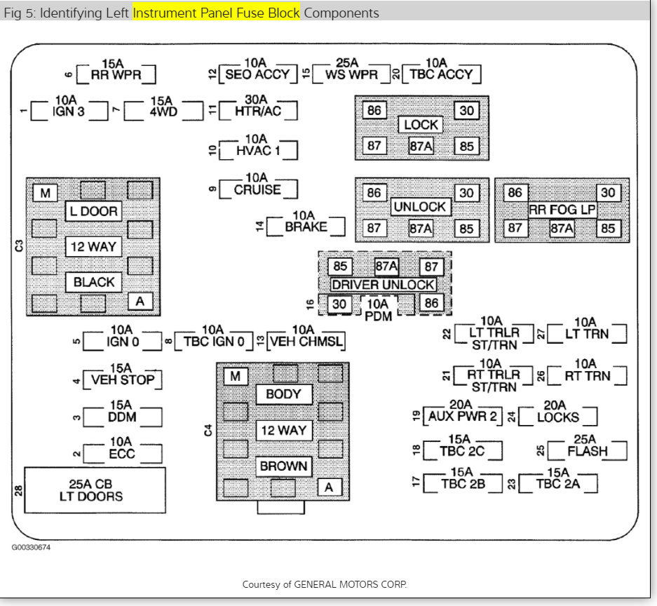

Usually a rapidly blinking blinker means a bad bulb. Changed all the bulbs (2057) on Both sides no change in the problem (right side). Then changed out the entire harness, no change. One commonalty with both harnesses is that the directional bulb burns dim and brake bulb burns bright and when rapidly blinking, tail light directional is very dim. When headlights are on and the brake is depressed, the secondary filament does not go on but when headlights are off, all lights come on when brake is depressed. Cleaned the right side ground up by the tail light. Changed the front directional bulbs as well 2057A. Yes, there is a short somewhere, but where do you start? Especially seeing it is an express van 1500 that has an Emabassy conversion package.

I have seen this problem before I would check all fuses for the BCM. Here is a guide and the locations:

Hmm my bad, this car does not look like it has a BCM controlling the lights. Here is a wiring diagram so you can see how the system works. Use this guide to check power and grounds.
https://www.2carpros.com/articles/turn-signals-not-working-blinker

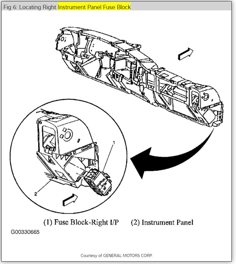

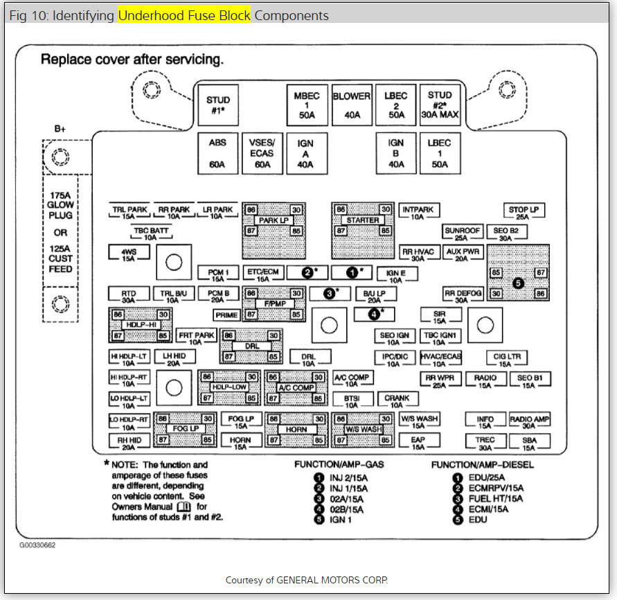

Update: Did in fact find a fuse box under the hood. All fuses check out okay with the ignition on and off. Checked the fuse box inside under the dash all but #8 labeled "crank" and number 15 labeled "Illum" both 10A fuses, worked fine switched them out to new fuses, still nothing. Tried all again with both the ignition on and off. No luck.

No there are not related. Any luck on the blinker issue? Yes, the high mounted center brake light is in the first diagram. Please check wiring and connections. You installed a new flasher correct?

lol, yes, resistance is what is making it blink fast must be a corroded connection or something somewhere.

You must test resistance through the circuits that run the right side. I would start at the switch because the contacts can go bad causing the high resistance.

Yes and the only thing that connects those two together is the switch. Can you try to move the hazard switch back and forth like five times, this can sometimes clean the contacts.
