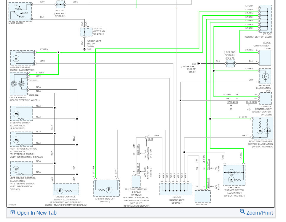

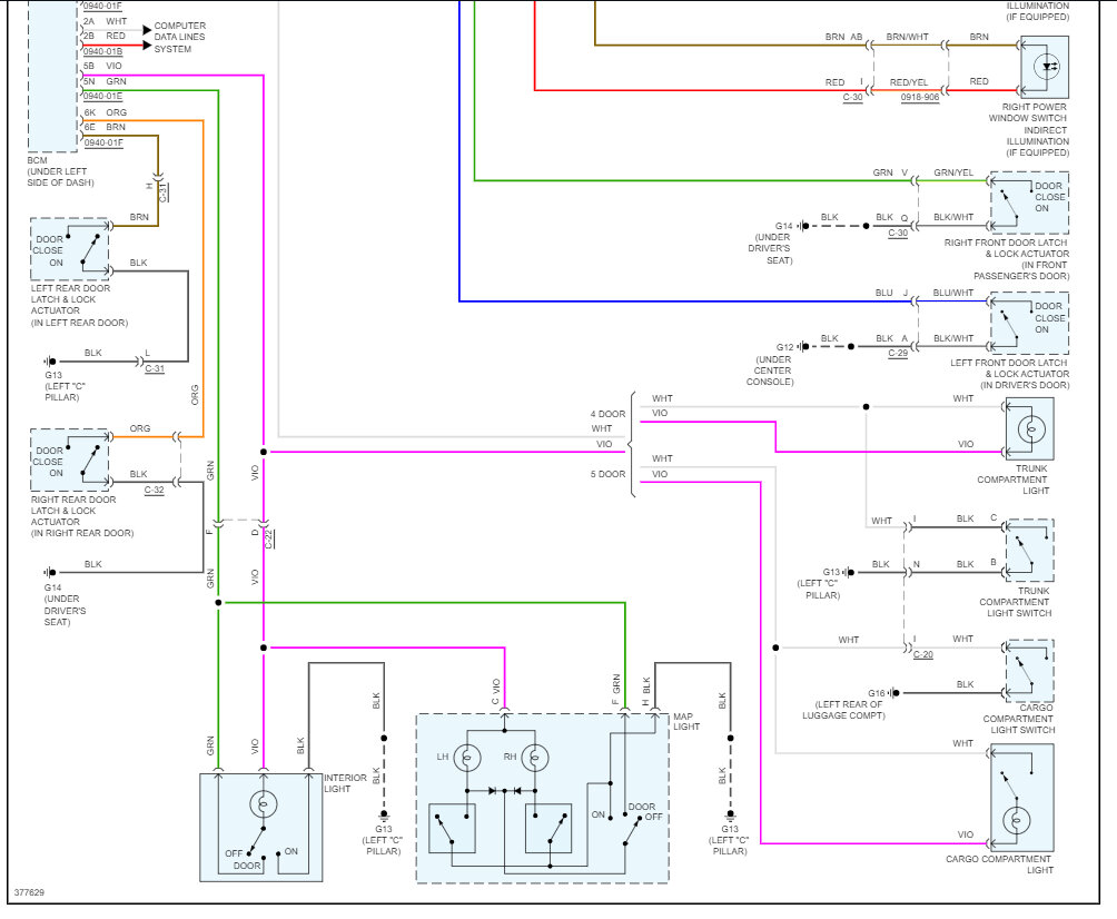

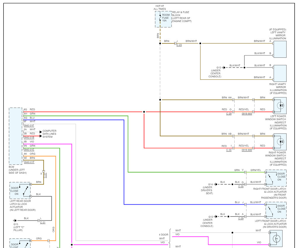

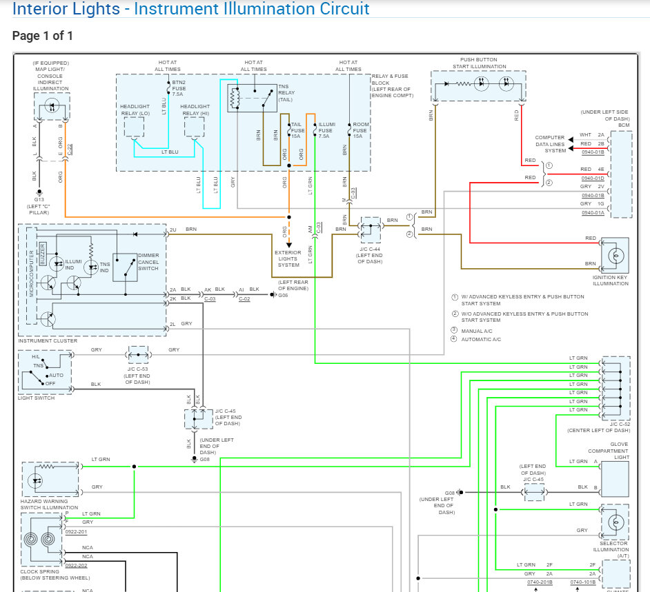

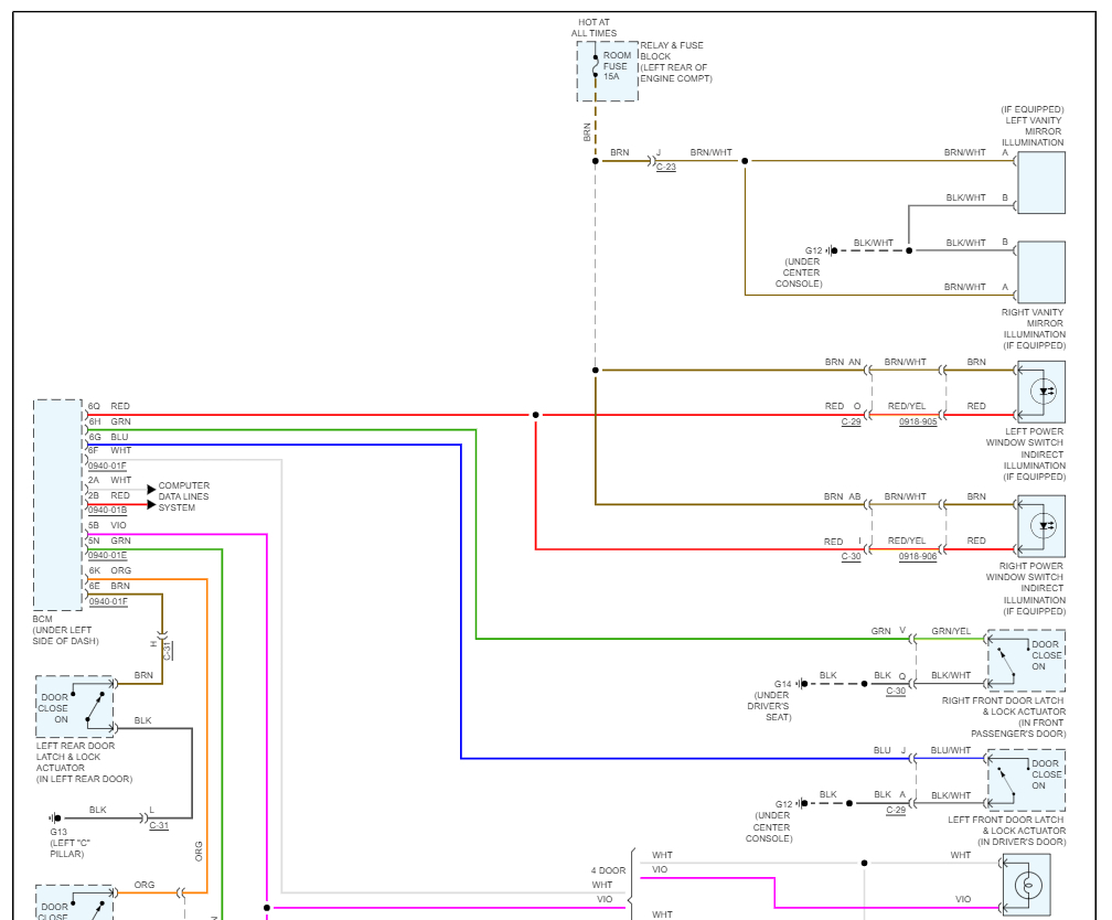

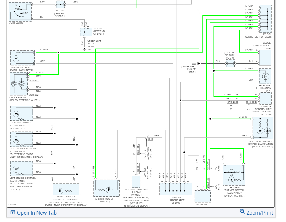

I want to install LED light in the footwell of my car. I want a diagram where I can find illumination wire inside the car. I have found that its fuse is in the engine fuse box.
Thanks
Oct 26, 2023 at 3:12 PM
  • 55,433 POSTS
Sure, here are the wiring diagrams you have requested for the interior lighting system and dome lights. Check out the images (below). Please let us know what happens.
