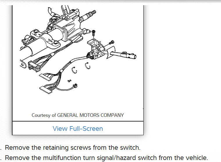

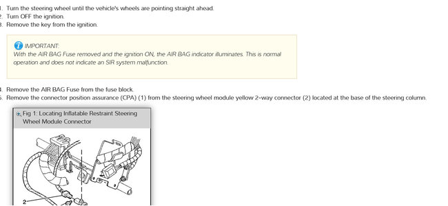

How to change dimmer switch?
Jun 27, 2017 at 10:40 PM
HMAC300
  • 48,601 POSTS

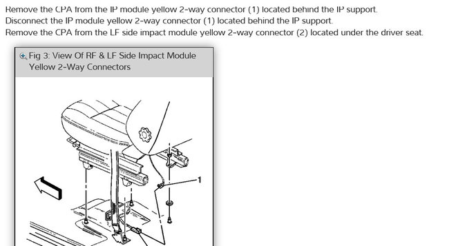

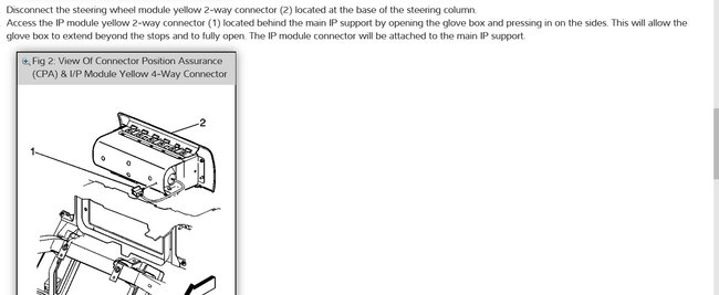

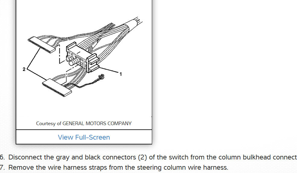

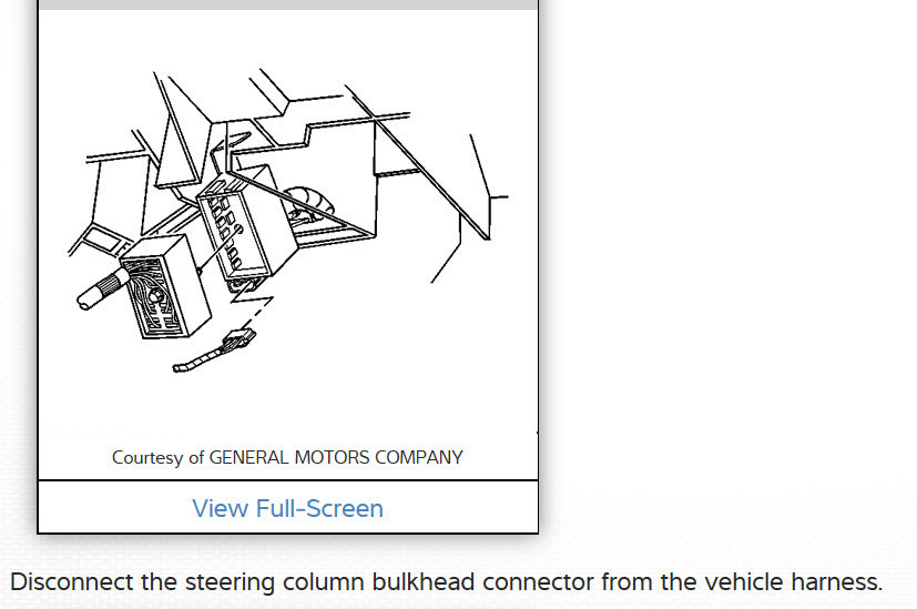

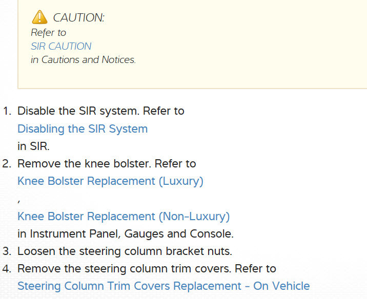

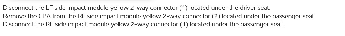

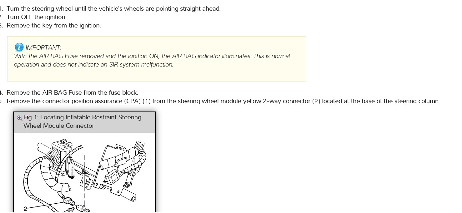

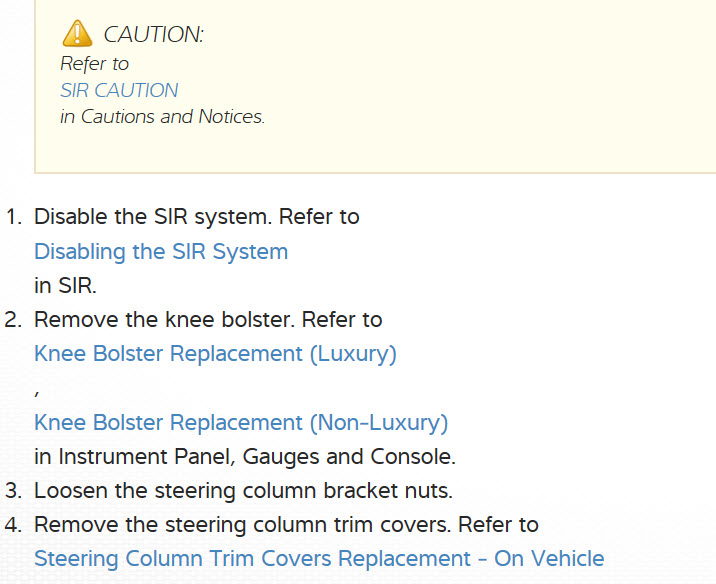

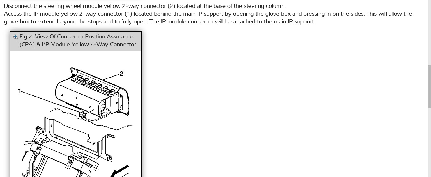

that is the multi function switch in steering column. you must deactivate air bags which is not recommended for amateurs. because of disconnecting air bag it may need to be scanned to shut off code which only a pro can do. See pictures.
