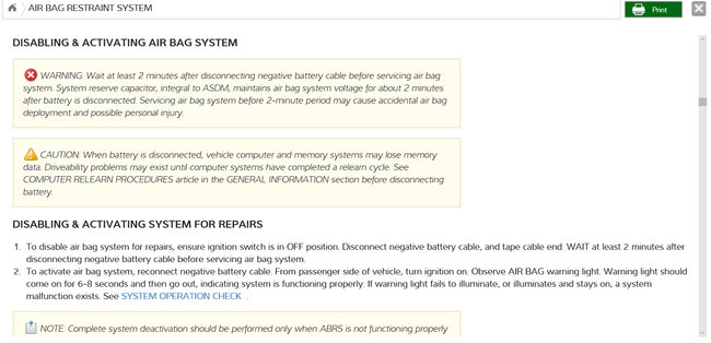

the dimmer switch stopped working. How do I replace it? Can you send me pictures showing how to replace the switch?

if you have an airbag read instructions and carefully proceed, although we do not recommend this. You can get hurt and windshield can get blown out . See picture for switch removal. if dimmer is on the floor, disconnect the wiring, and undo screws holding it to floor.
