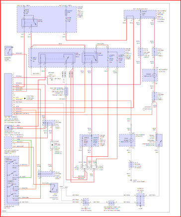

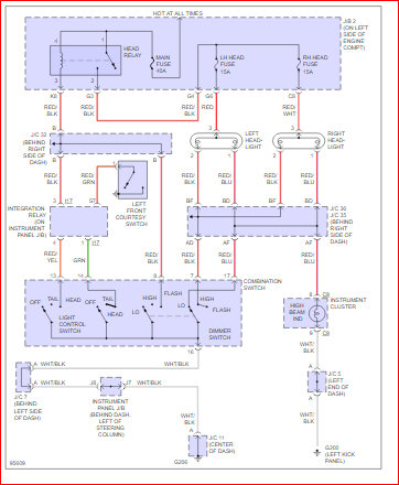

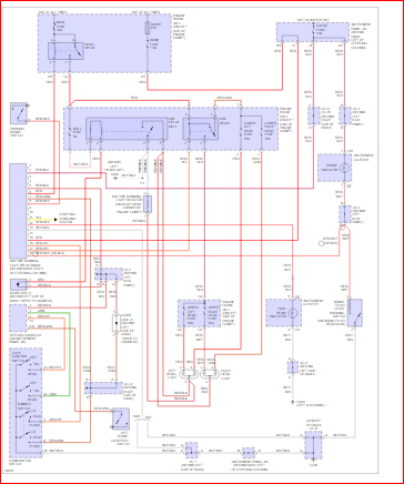

My dimmer switch is not working, so my dashboard lights will not come on along with all my parking lights. Do you have a wiring diagram for the instrument panel?
Jul 18, 2018 at 8:50 AM
DANNY L
  • 5,648 POSTS
Hello, I am Danny.
Here are two different pictures of the diagrams you asked for. One is for DRL (Daytime Running Lights) the other is not. Hope this helps and feel free to ask any further questions if needed. Thanks for using 2CarPros!
