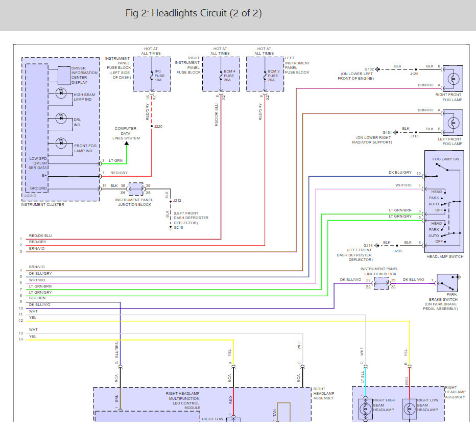

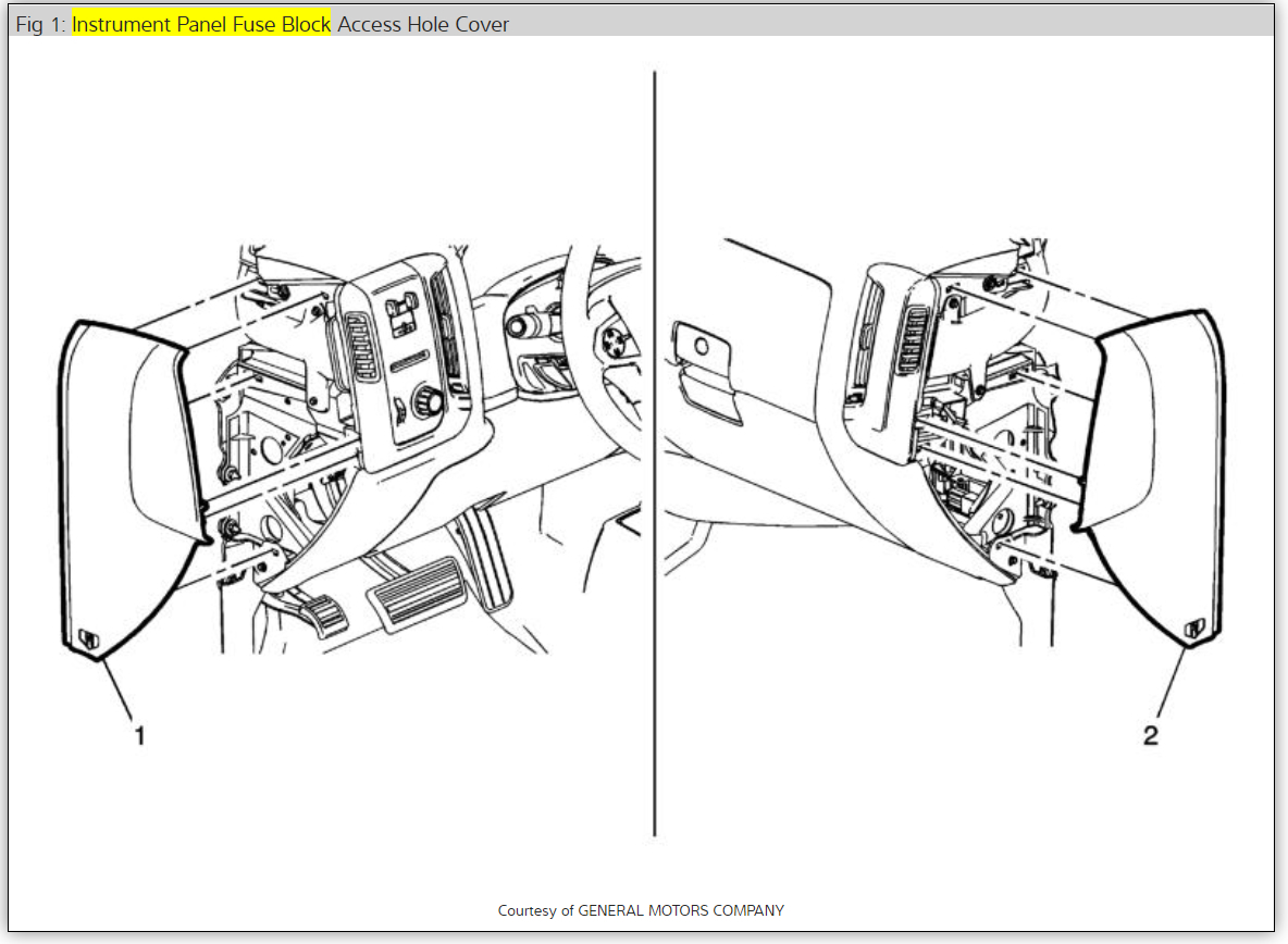

For some reason my headlights, both low and high, seem to be really dim. I thought it may have been my bulbs so I bought new LED's. They also do not seem to be as bright as they should be. I know someone who has a very similar pair and they are very bright. Any ideas what it could be?

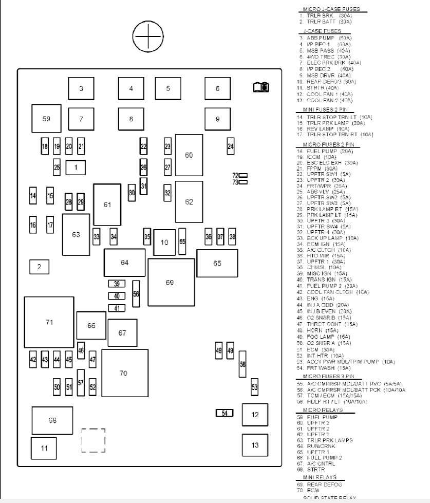

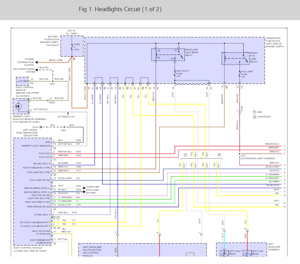

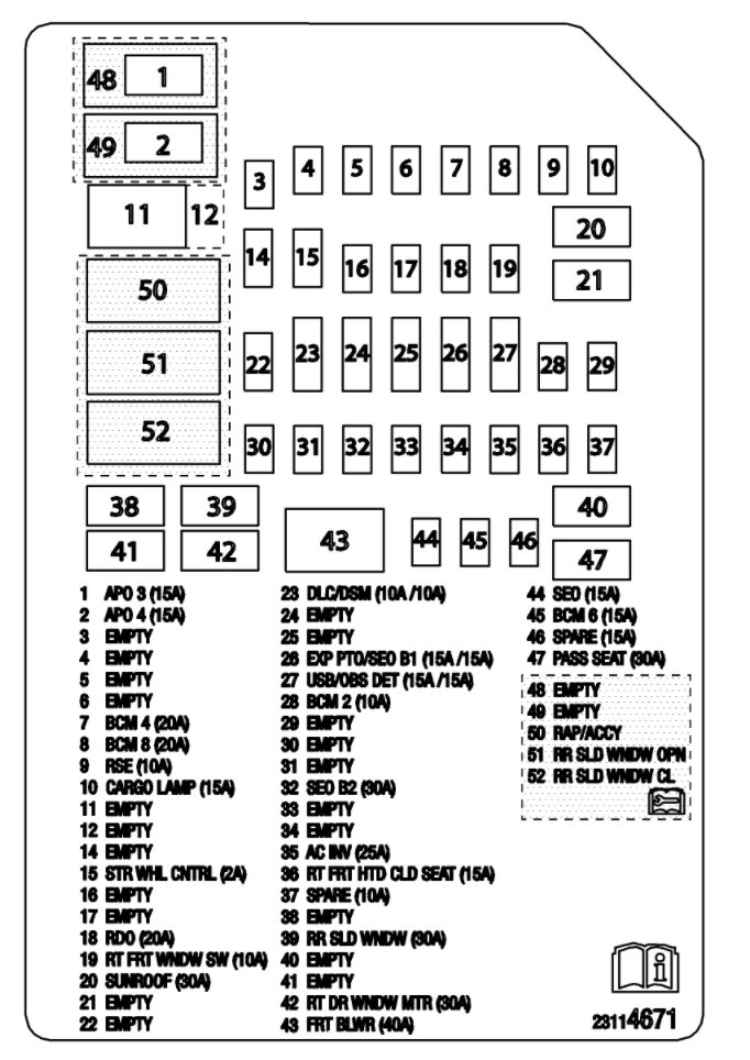

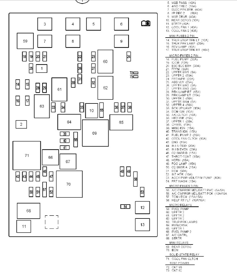

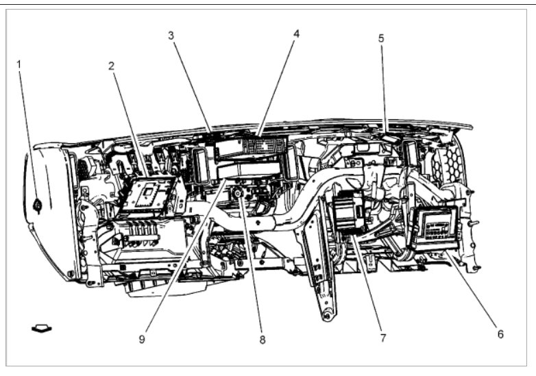

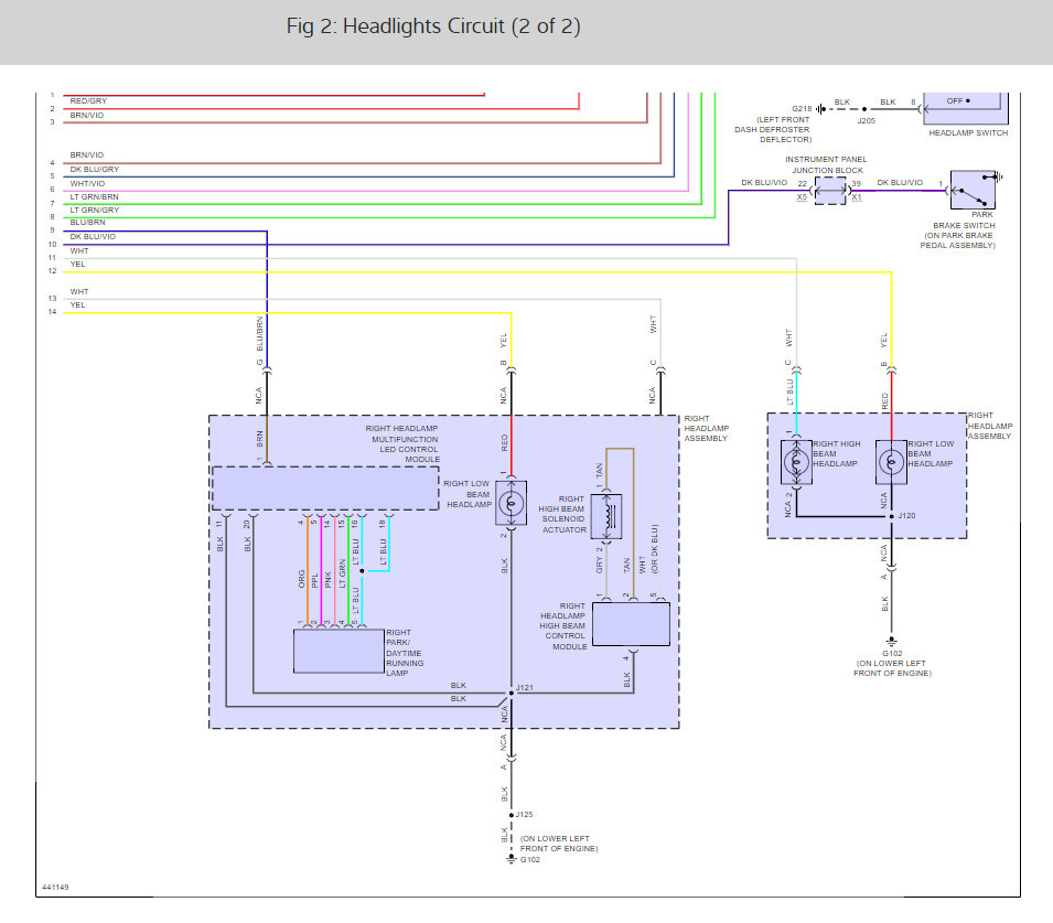

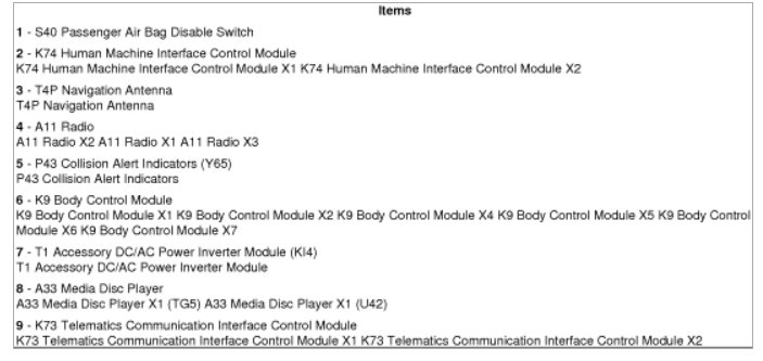

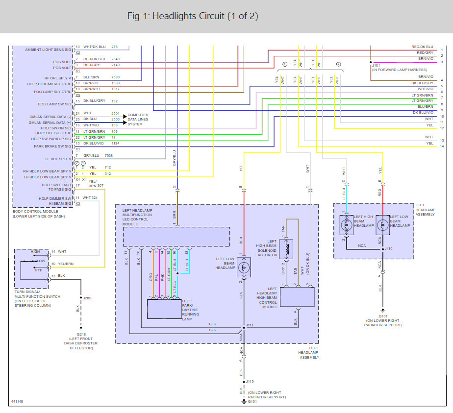

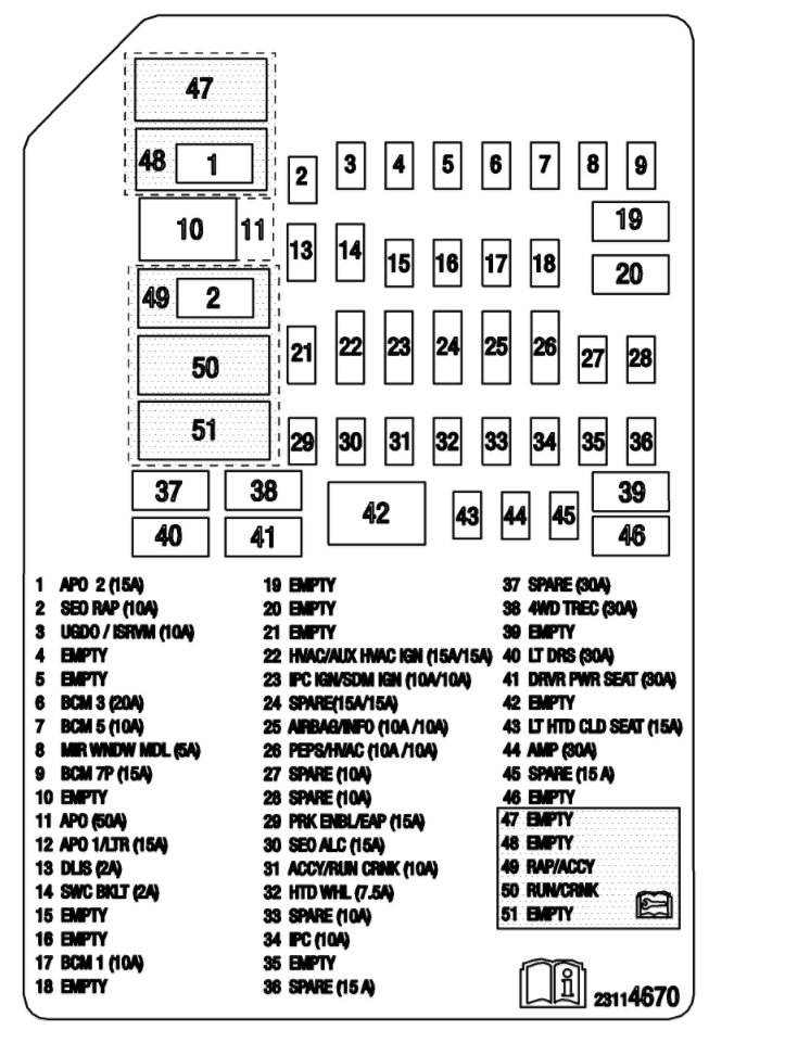

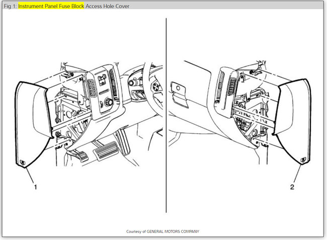

It sounds like you have one or more BCM fuses that are out or the BCM is out causing the headlights to be dim. Here is a guide to help you test the fuses:
Here are the fuse and BCM locations. I would also check the ground for the system on the lower left of the engine.
Check the wiring as well before you replace the BCM.

Just an update. So I checked my battery voltage and it was around 12.4 and 14.6 when started. So my battery and alternator appear to be ok. I also checked all 4 BCM fuses and they were in working condition. Took a look at the ground wire and even grinded the frame down a little to assure a good connecting.

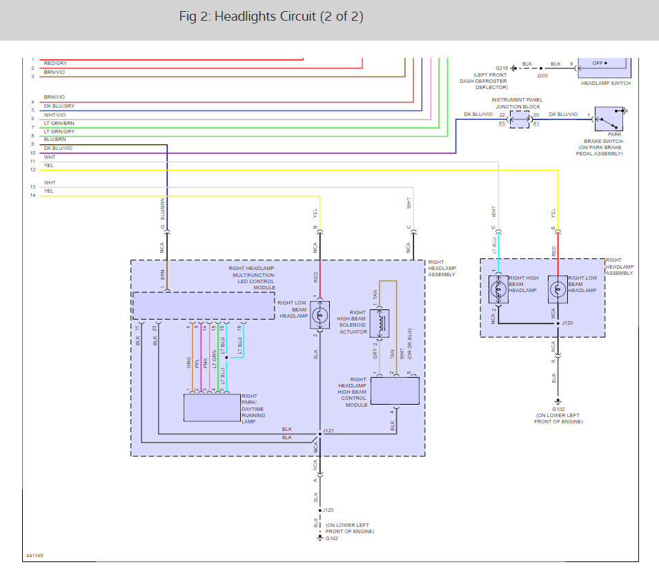

  • 55,433 POSTS
Its not an alternator or battery issue you are right about that. My next check would be to take the BCM connector and check the power and grounds. If all are okay I would say the BCM is bad and you will need a new one. It will need to be programmed by a shop or the dealer.
Here is a guide to check the power and grounds. Use the wiring diagrams above to check.
