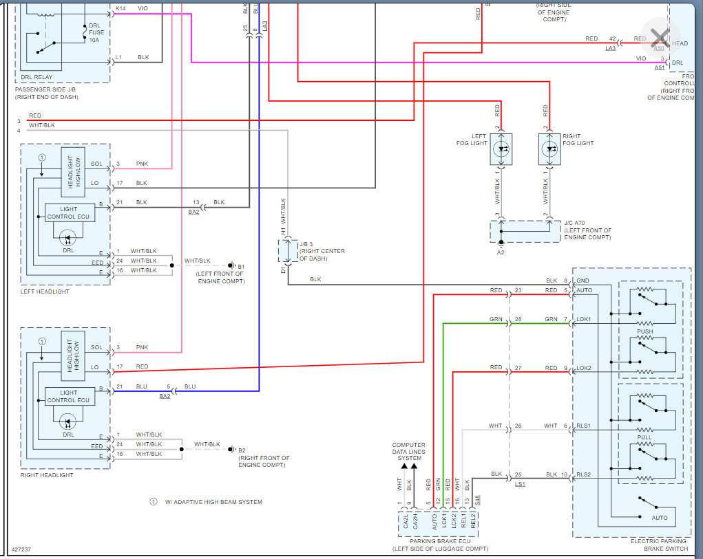

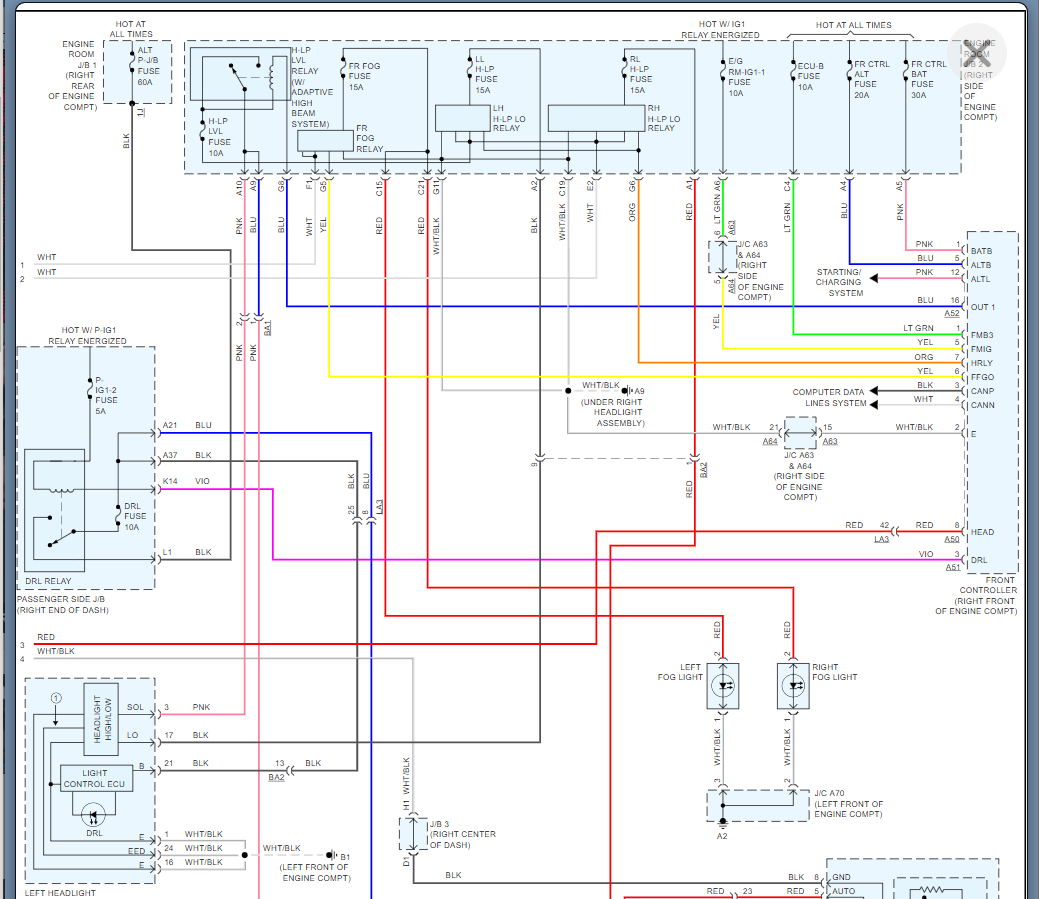

my DRL are very dim. What will cause this to happen?
Sep 13, 2021 at 3:09 PM
There could be a number of reasons for this so we need to start with the basics.
Here are a couple guides and videos that will help with this:
https://youtu.be/PxA5wczsCVo
https://www.2carpros.com/articles/one-headlight-is-dim-or-dull

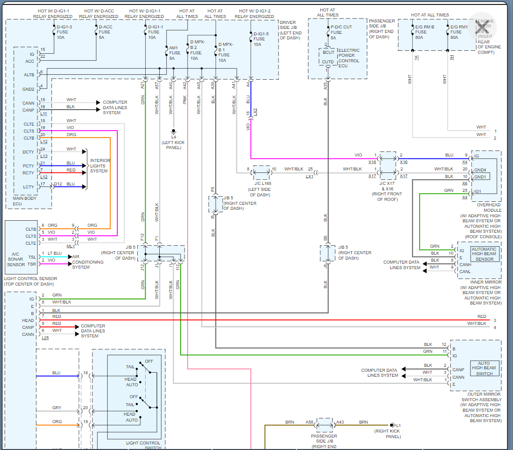

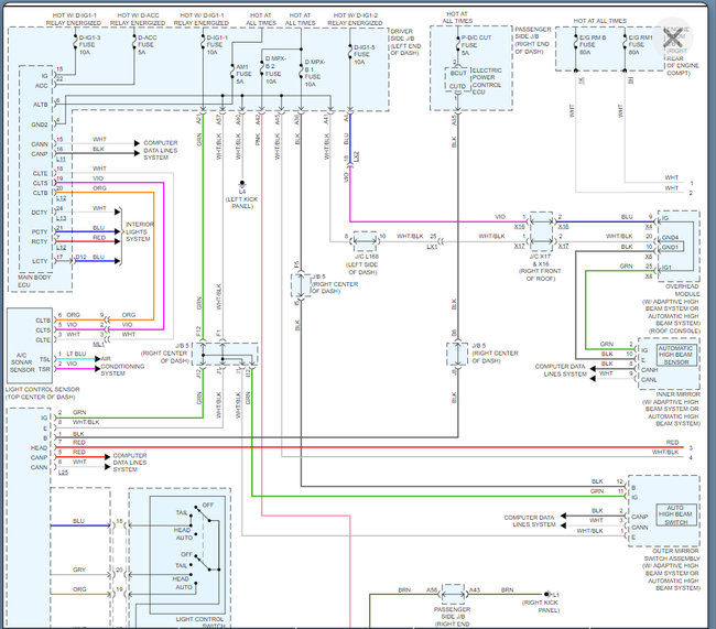

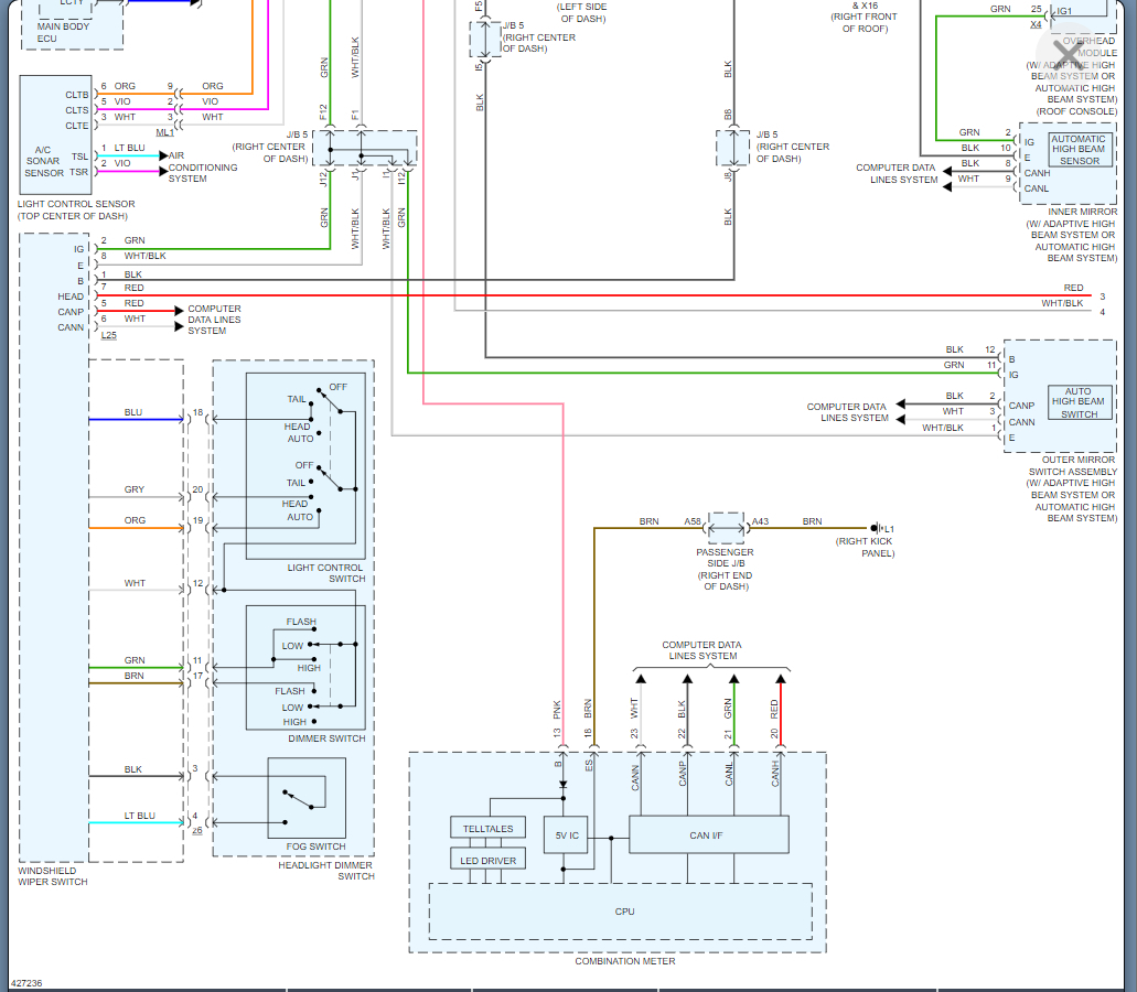

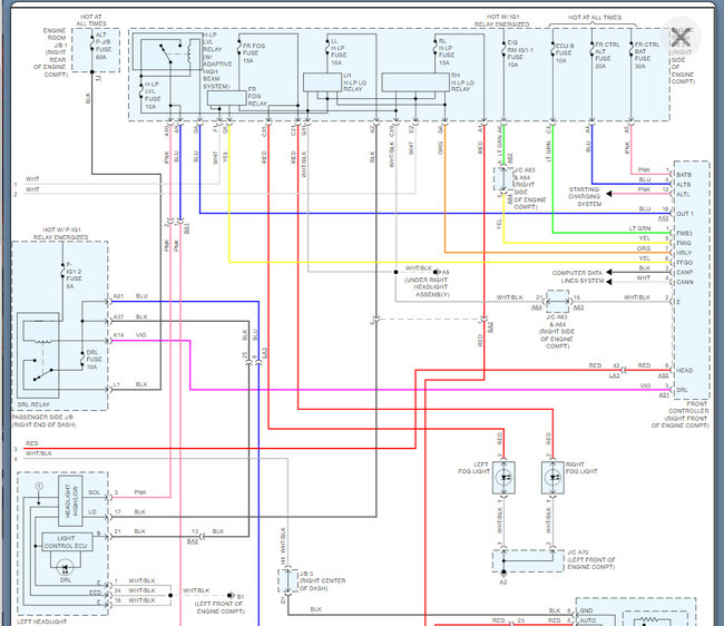

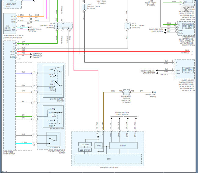

I am attaching the wiring diagram below because we need to also check voltage at the bulbs and find out if we are even getting proper voltage.
Are both headlights equally dim? If so then I suspect we have resistance somewhere in a module or other greater module issue.
However, we need to start running through this material and see what we find in order to know what direction to go.
Please let us know what questions you have. Thanks
