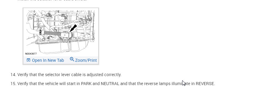

Hi folks,
Occasionally when I try to start my vehicle it will appear that I am trying to start it while not in park or neutral. In other words, everything works but turning the key to start yields absolutely nothing. I have found that lots of shaking the shift lever solves the problem, and I am thinking that the Digital Transmission Range Sensor or Neutral Safety Switch (I think those are two names for the same thing) needs to be checked. Question: where is this on the vehicle listed above? It is not where the cable hooks onto the side of the transmission. Thanks for any clues you can give.
Brainsy
Jul 5, 2020 at 8:15 AM

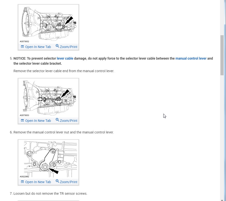

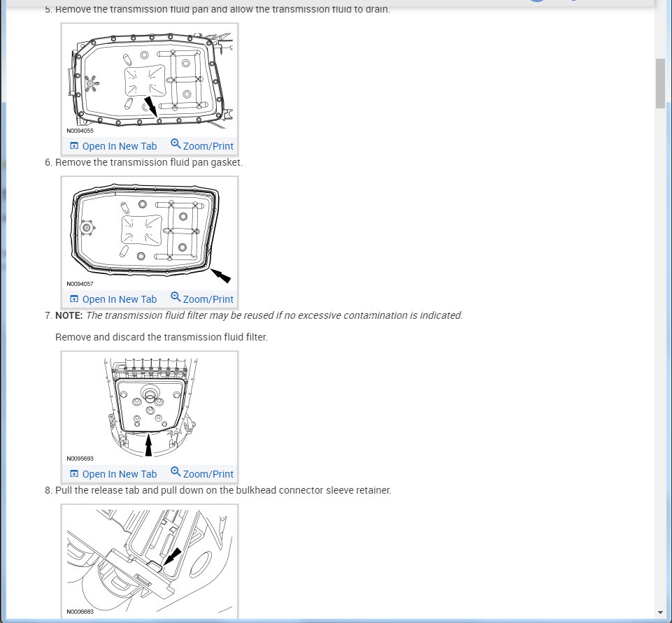

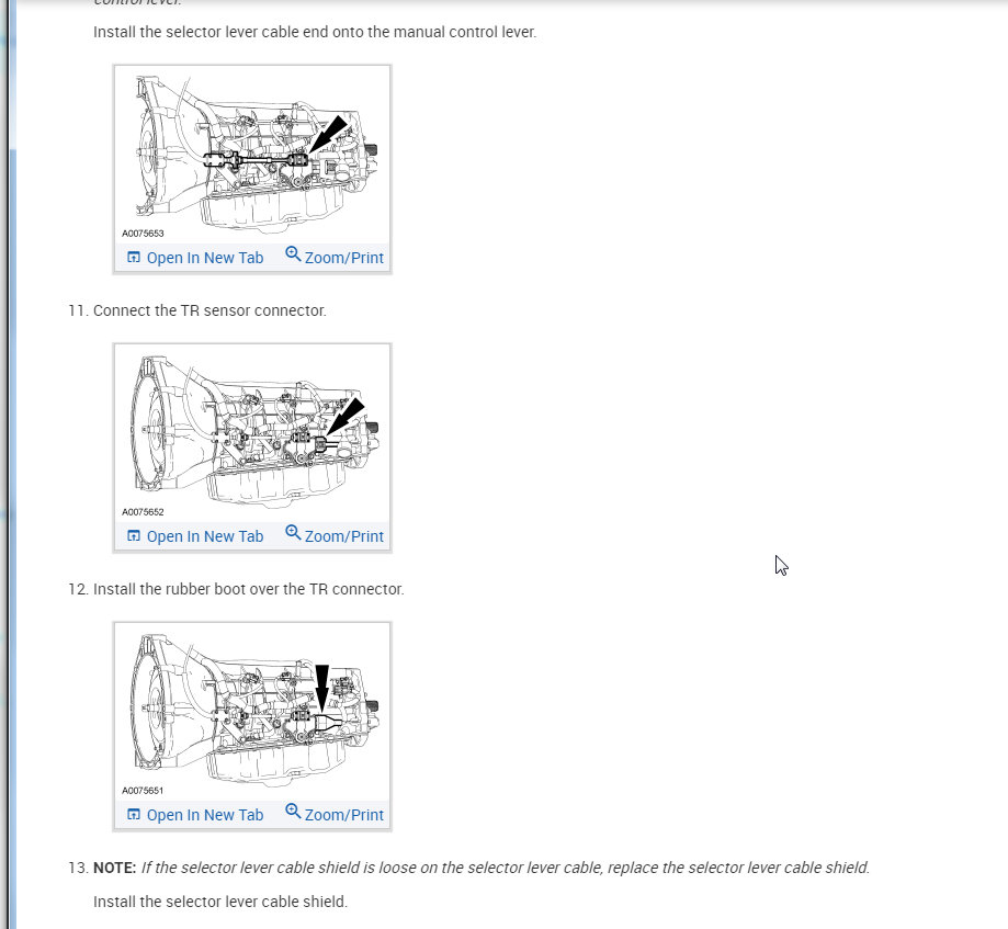

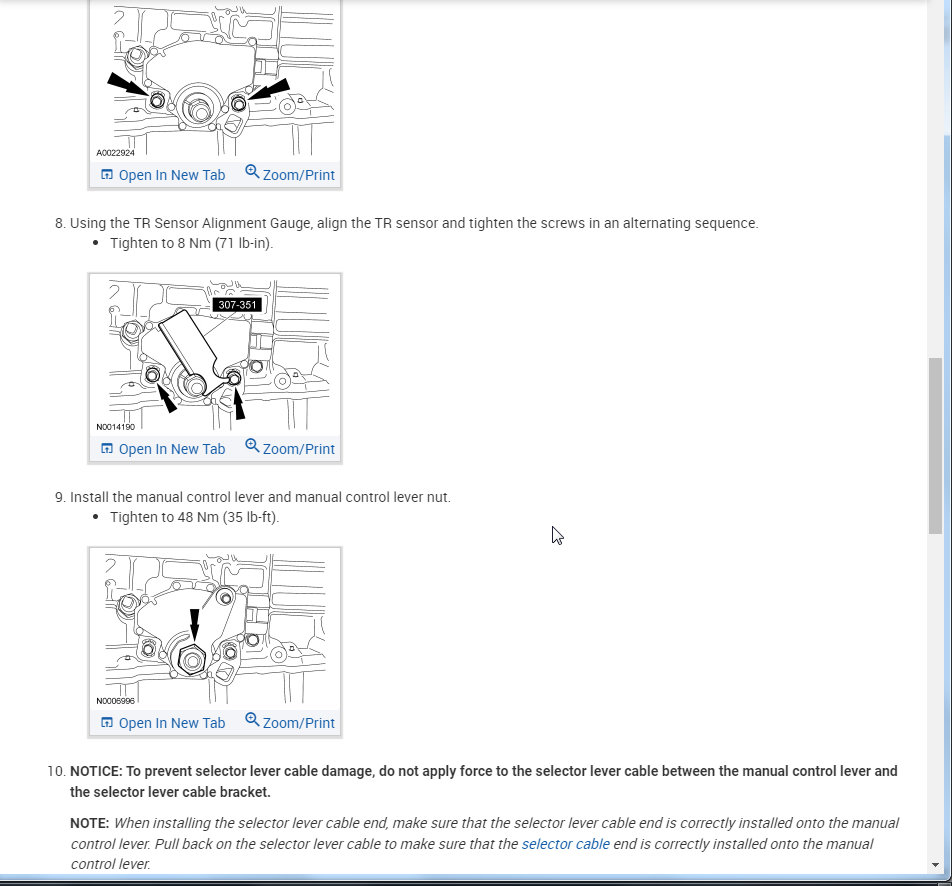

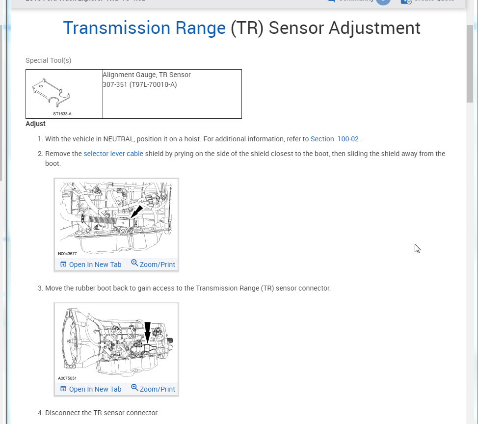

Sounds like you are on the right path. I attached the process for adjusting the TRS because I would suggest doing this first. If it needs to be replaced clearly you will know where it is after the adjustment.
Let us know what happens. Thanks
Jul 6, 2020 at 10:43 AM

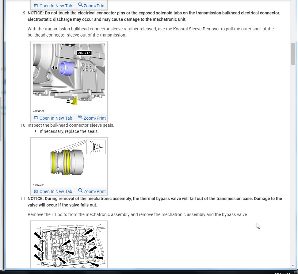

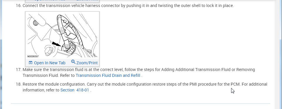

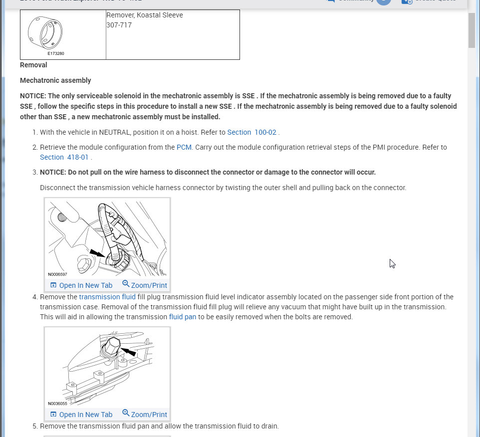

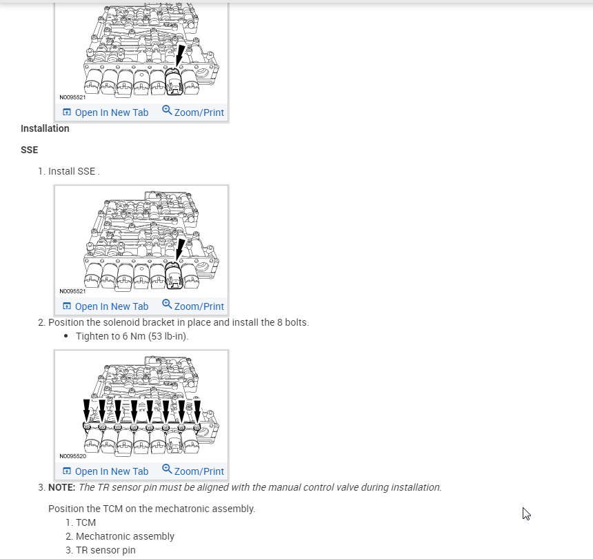

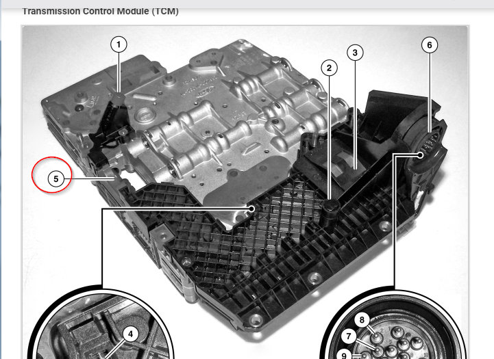

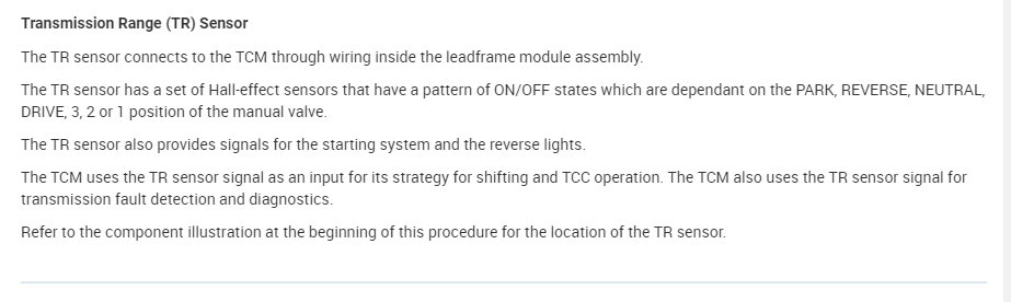

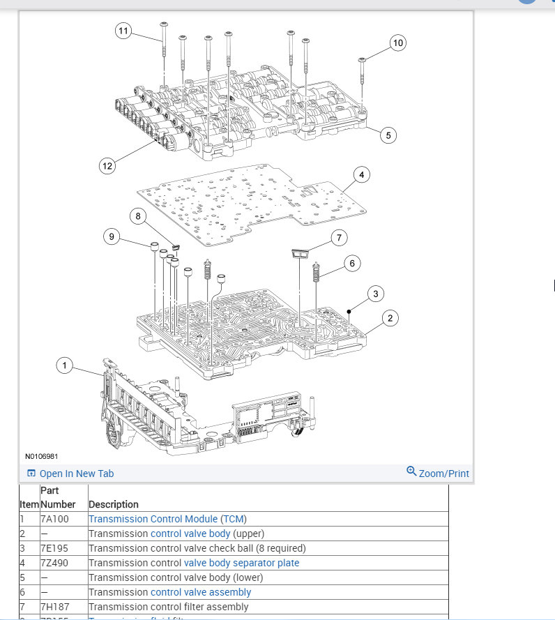

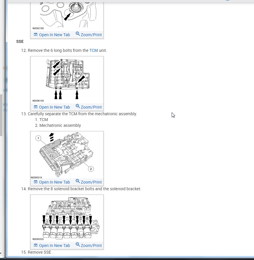

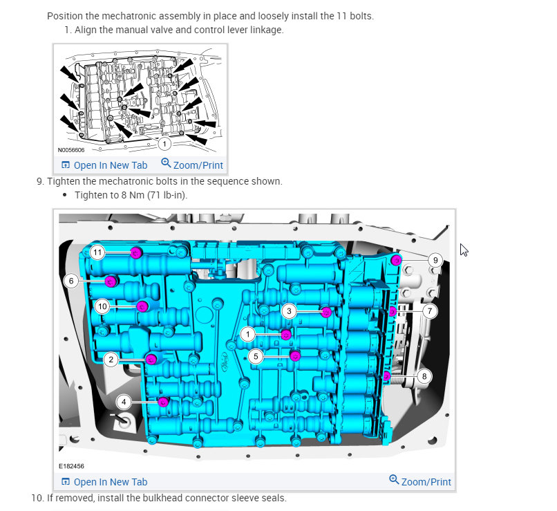

You are right. I now know where the TRS is. It's a Ford 6R80 transmission, and the sensor is inside the housing, part of something called a Lead Frame which is attached to the valve body, and with no means to adjust as far as I can see. I made sure the cable is in good condition and secure, but other than that I think its a matter for the transmission specialist to do some testing and maybe I will end up having them change the lead frame. Sounds expensive. :(
Jul 7, 2020 at 3:40 AM

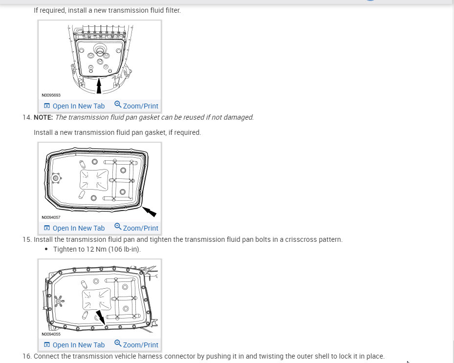

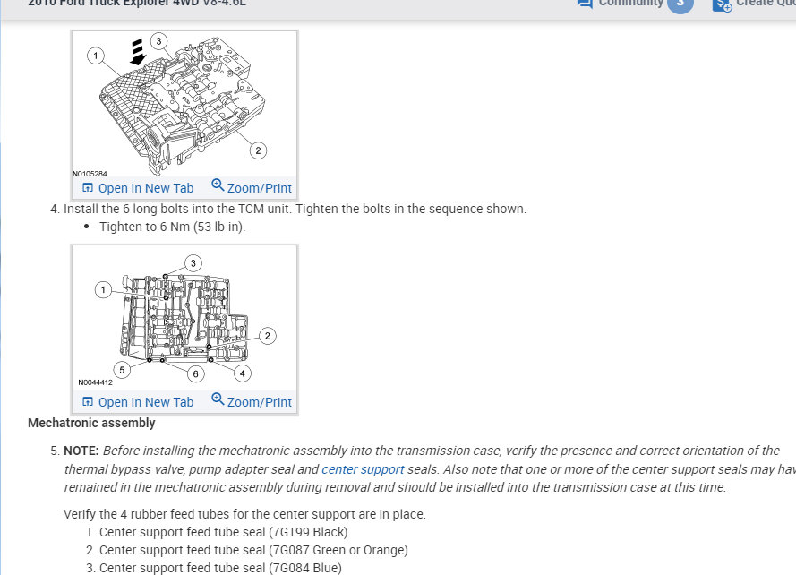

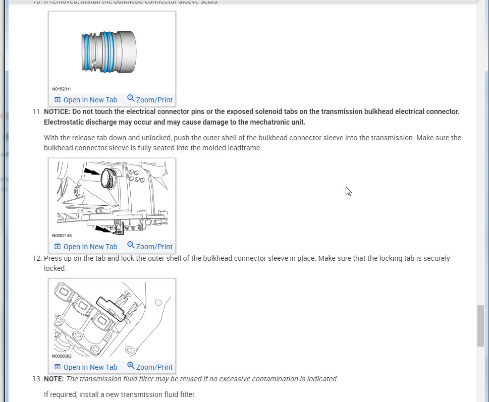

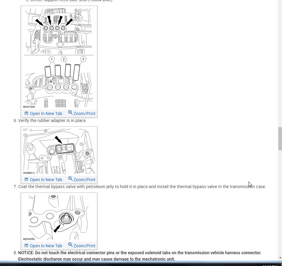

I should have assumed you had the more difficult one. the 5R55 is more common which is what the process was for. However, you are correct, that the TRS on your vehicle is part of the lead frame module assembly which is part of the TCM. I attached the process if you need it.
Jul 7, 2020 at 12:56 PM
