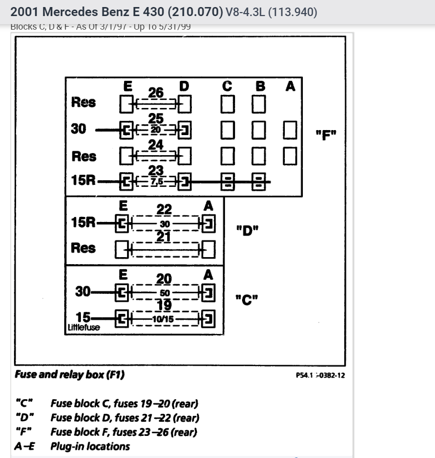

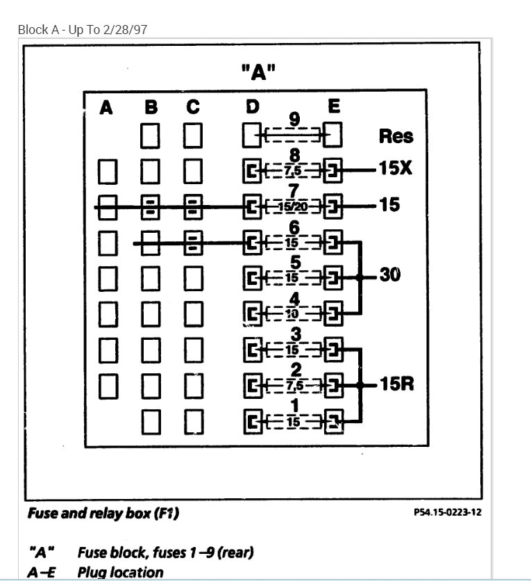

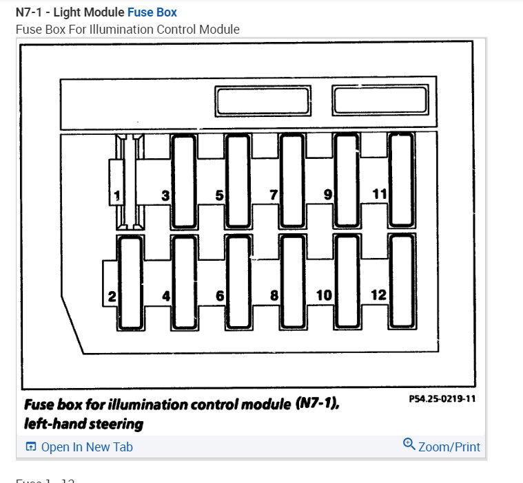

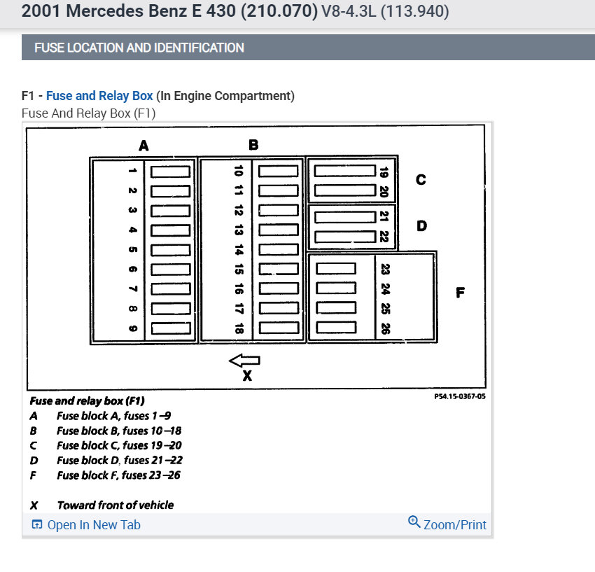

The regular speedometer works, but the digital one and also the radio doesn't turn on at all.
Apr 10, 2023 at 5:59 PM
Experienced Mechanic
55,554 POSTS
The first thing I would do is check the fuses. Here is a guide to help you with the fuse location as well, check the fuses with the system on:
