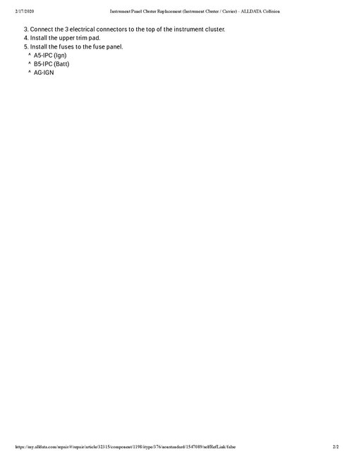

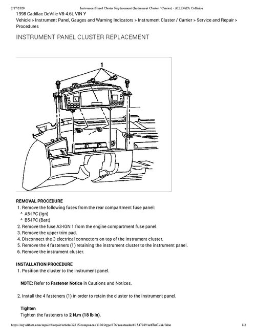

I have attached the procedure for replacing the cluster that i have here.
I would advise reinstalling the old cluster and following the procedure.
Let us know how you go.
Regards, Joe
