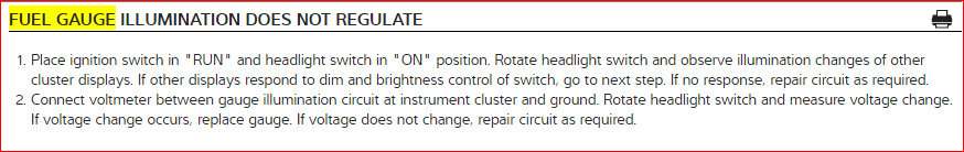

The digital fuel gauge does not light/work. The speedometer and message center both work. However, the message board is reading 0 miles to empty when the distance to empty button is pressed. It has gas. Any suggestions would be appreciated.
Thanks, Richard

Hi Danny, thank you for your response. Yes I checked all the fuse with a test light. They are all in good order. Richard

DANNY L
  • 5,648 POSTS
Hello again.
I have attached a step on how to test the fuel gauge illumination. You will need a voltmeter or test light. Hope this help and feel free to ask any questions. Thanks again for using 2CarPros.
