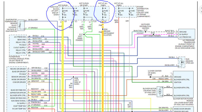

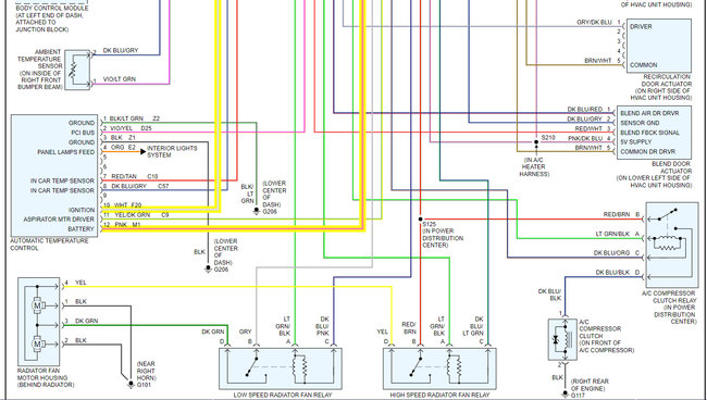

heater/air conditioner/blower works fine. replaced digital display. Still doesn't work correctly, comes on when turned off, will not display temperature, Etc. only time it will shut off is when the car is turned off.
Dec 6, 2020 at 11:14 AM
Good afternoon,

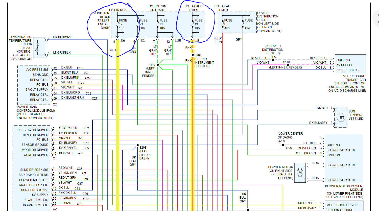

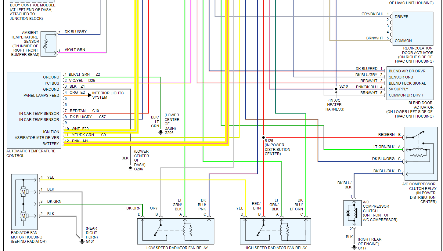

I attached a wiring diagram for you of the control head. Make sure the 2 fuses I listed have power on both sides with the key on, engine off.
Let us make sure the powers are correct.
