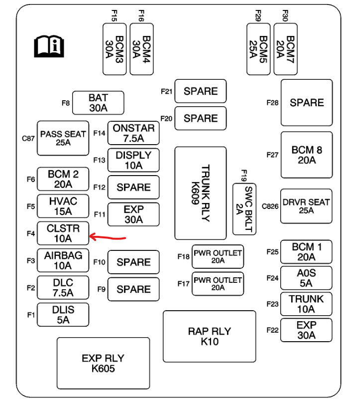

my digital dashboard no longer shows me the mph. What would cause this?

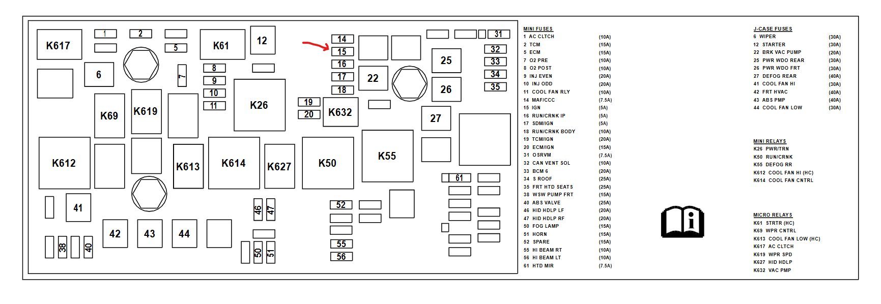

Does the car shift okay with no check engine light on? If so, chances are the display has gone out, but we should check the fuses that run the cluster. here is a guide to help and the fuses you need to check in the images below.
The fuses are: IGN (under hood fuse panel) and the cluster fuse (interior fuse panel). Check out the images (below). Let us know how it goes.
