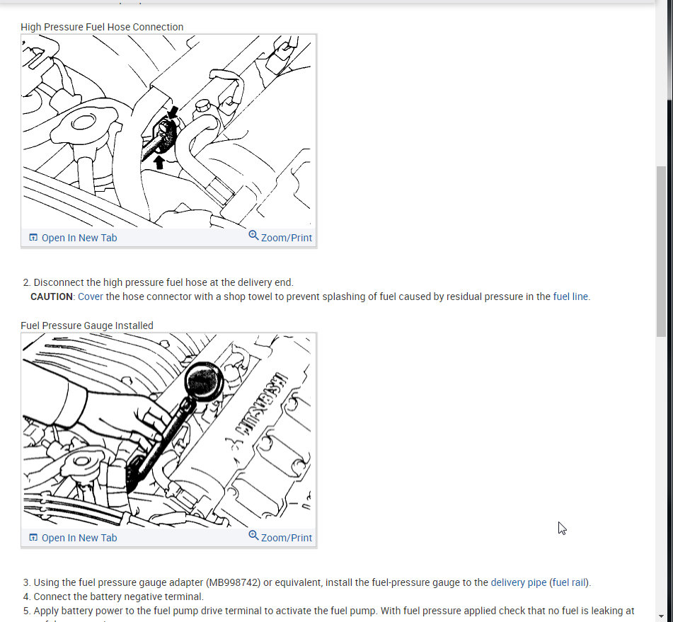

Idles pretty normal, but pressing the gas too fast and it sputters, smokes from the exhaust for a a couple seconds then stops. Also, I don't know if it's related but I'm not getting good voltage at the B-9, n B-10 connectors which I believe is the induction servo motor. I'm trying to trace down where these connectors get power from.. directly from ECU or relay. Possible short somewhere.

I went to check fuel pressure and I didn’t see any port or sensor. Does this mean you have to cut hose between the filter and fpr? I’ve seen this done to install aftermarket fuel pressure sensor. Admittedly I’m new to working on this vehicle, got tired of mechanics messing around with it.
May 2, 2021 at 8:30 AM

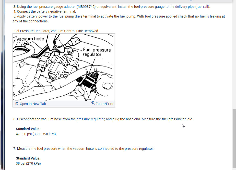

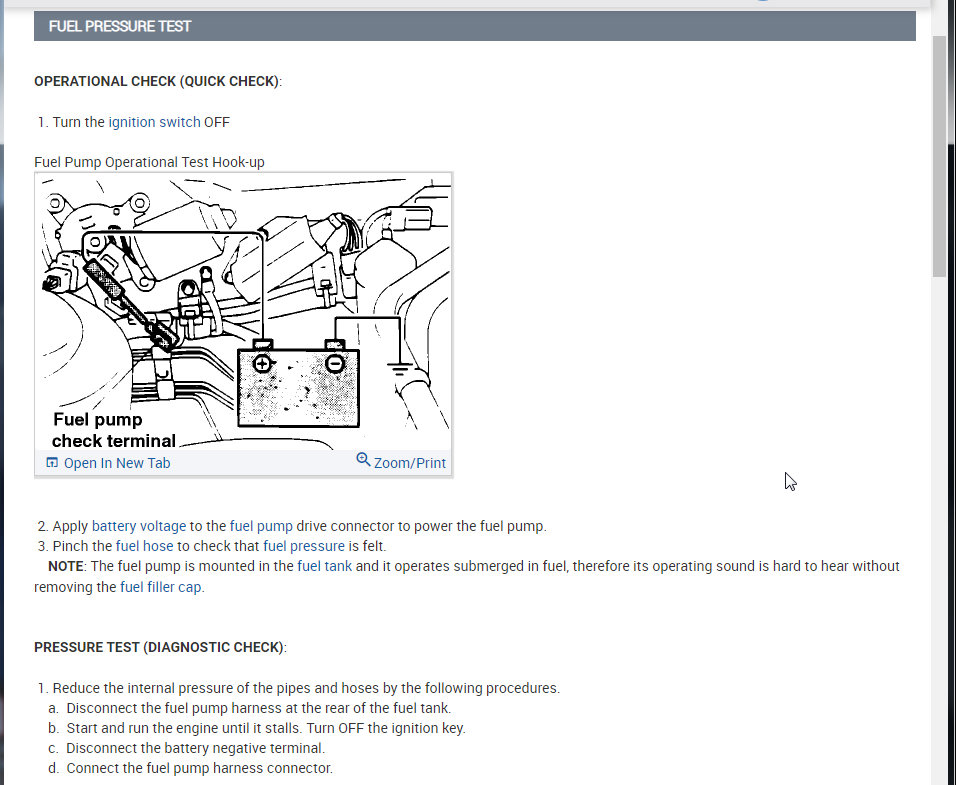

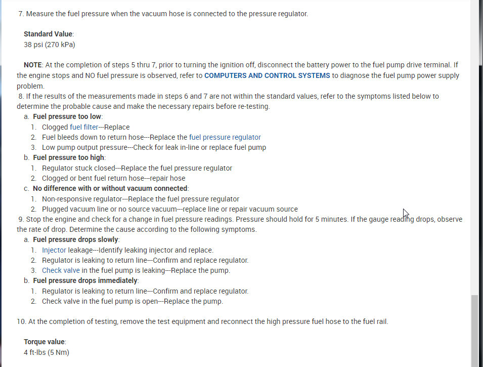

Sorry. Yes, this engine has a different way of testing the pressure.
The fact that the smoke is black, I am pretty confident we are dealing with a fuel issue which is most likely high pressure or leaking injectors.
Below is the process from the manual.
May 3, 2021 at 12:48 PM
Sorry. Yes this engine has a different way of testing the pressure.
