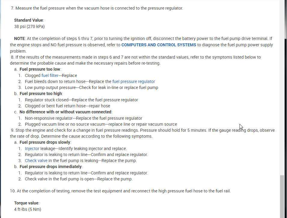

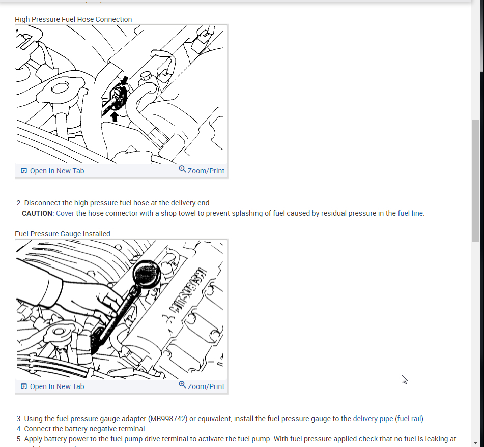

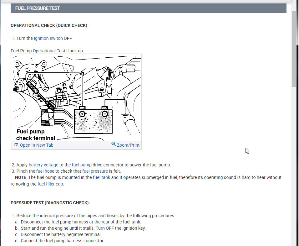

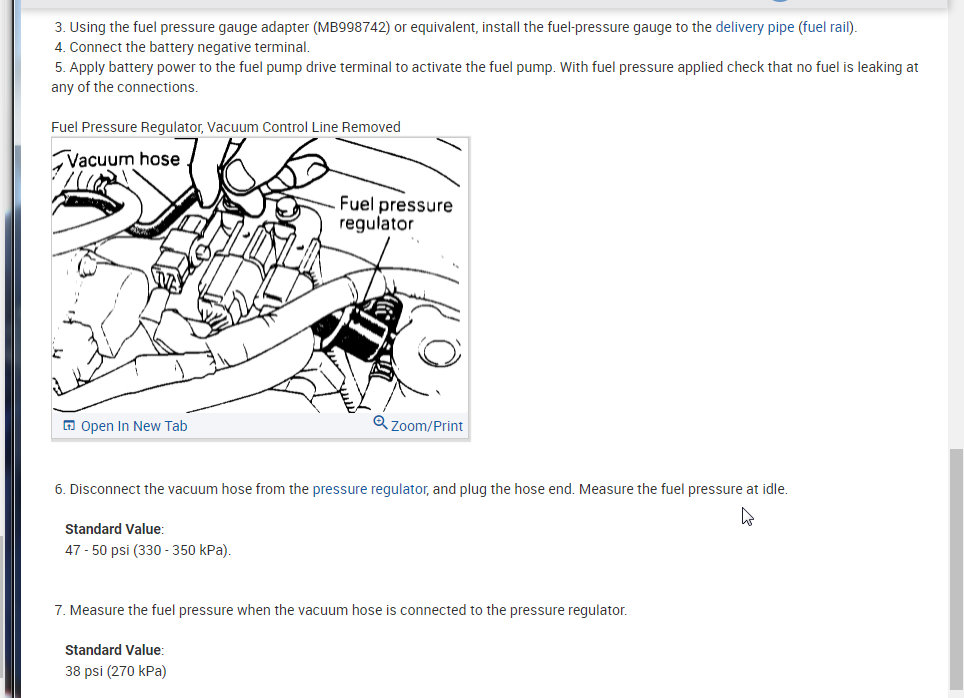

Sorry. Yes, this engine has a different way of testing the pressure.
The fact that the smoke is black, I am pretty confident we are dealing with a fuel issue which is most likely high pressure or leaking injectors.
Below is the process from the manual.
Monday, May 3rd, 2021 AT 7:48 PM
Sorry. Yes this engine has a different way of testing the pressure.
