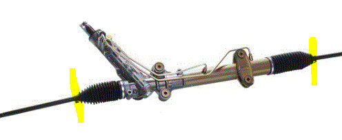

I hope the rack and pinion is good. I remember years back, there were bushings that would fail and then they would bind. If you look where the inner tie rod goes into the rack (at the boot on each side), see if there is any evidence of fluid. You may have to gently pry the boot open to confirm.
I attached a pic of the rack and highlighted where to check.

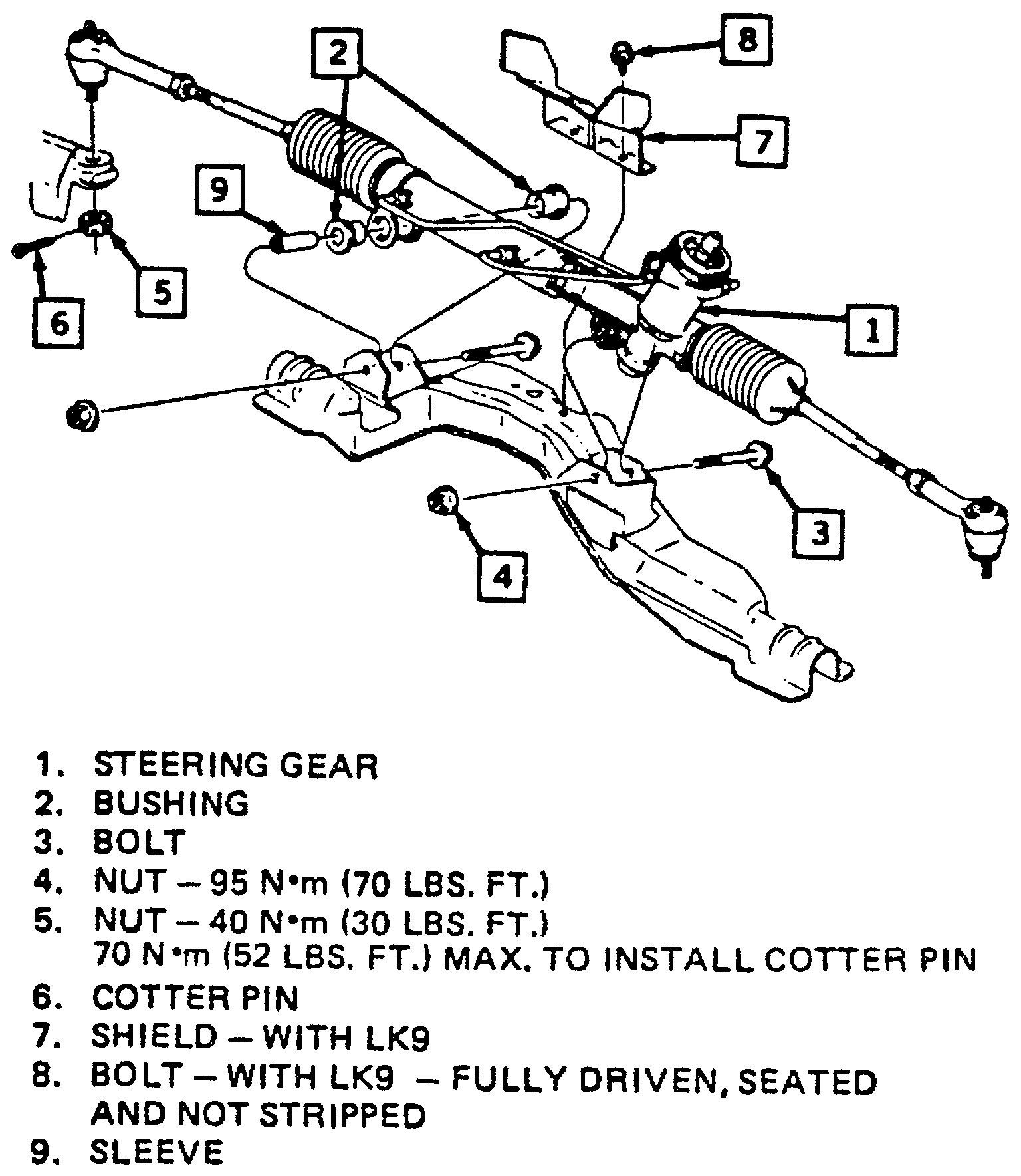

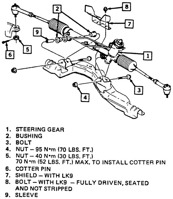

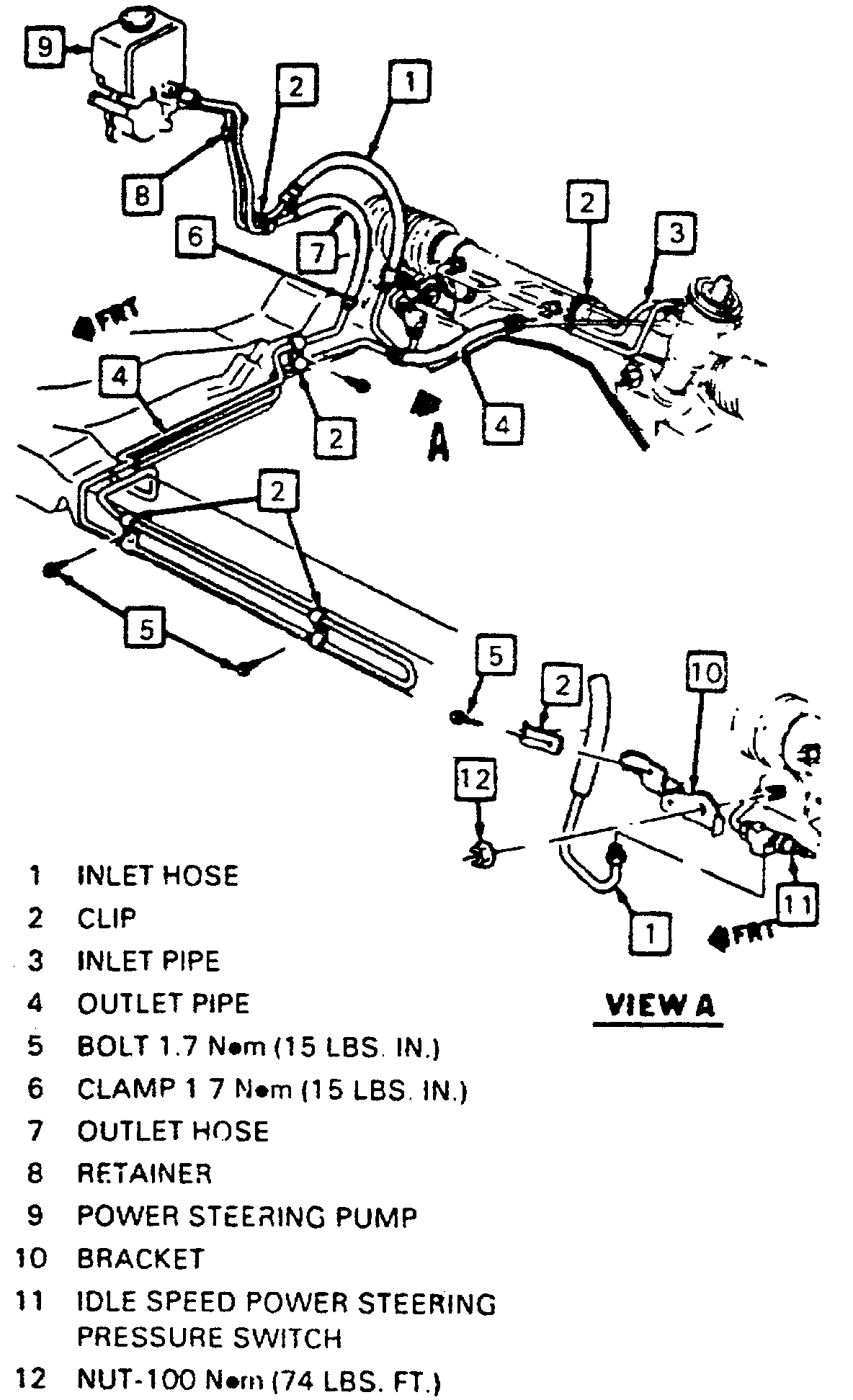

I have to be honest. I really feel the rack and pinion is bad. If you decide to replace it, here are the directions. Also, if you check places like Rockauto.com, you may find it isn't an expensive part.
The attached pics correlate with the directions.

RACK AND PINION ASSEMBLY REMOVAL
TOOL REQUIRED:
^ J 24319-01 Puller
Rack And Pinion Mounting
pic 1
Power Steering Line Routing - V6
pic 2

13. Rack and pinion mounting bolts.
14. Rack and pinion through left wheel opening.
INSTALL OR CONNECT
1. Rack and pinion through left wheel opening.
2. Rack and pinion mounting bolts.
TIGHTEN
^ Torque rack and pinion mounting bolts to 95 Nm (70 lbs. ft.).

10. Lines at gear from pump.
TIGHTEN
^ Lines at gear pump to 25 Nm (18 lbs. ft.).
