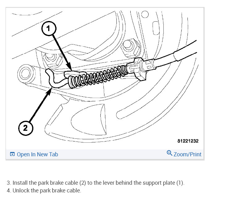

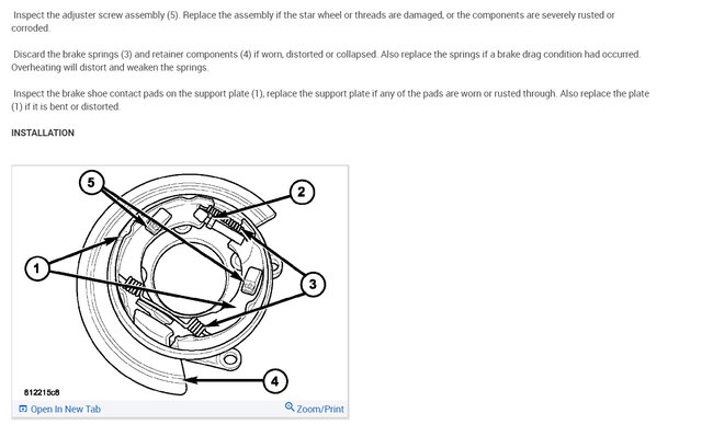

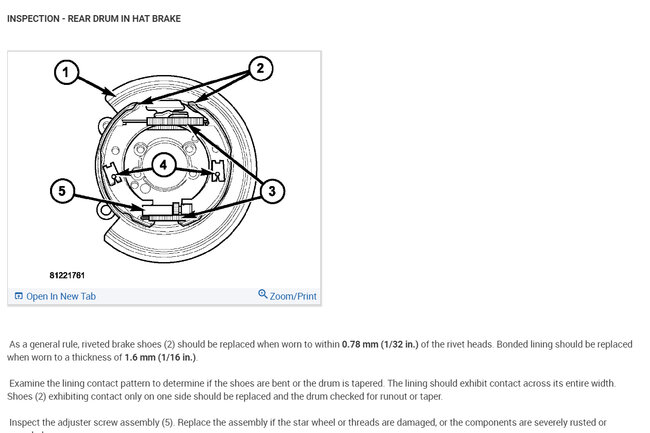

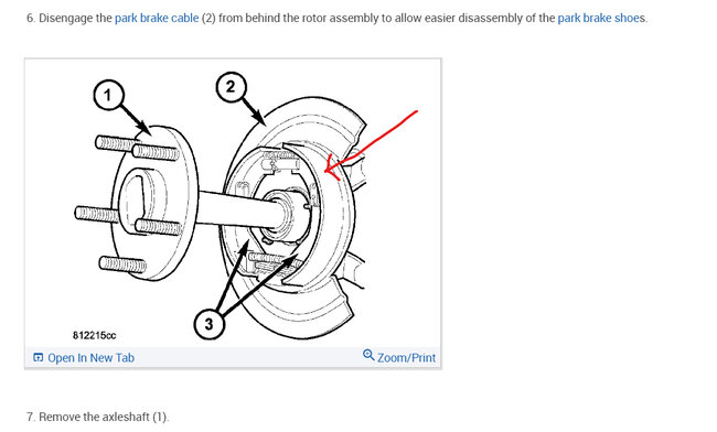

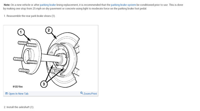

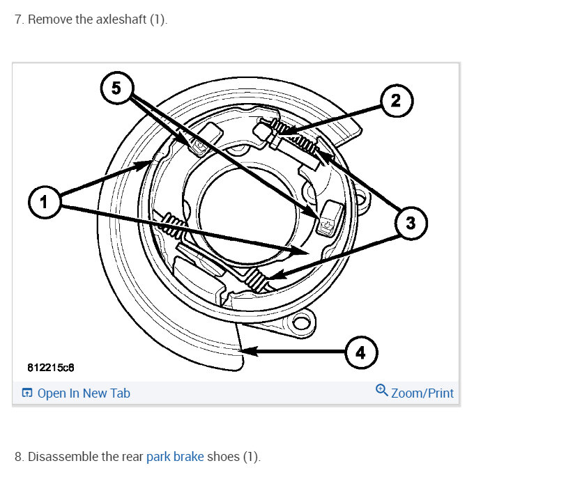

Thanks for the video, it helps. That sounds definitely like brake noise. Did you check the rear brakes and parking brake shoes as well? Check out the images (below). Please let us know what you find.

Did they check the parking brake? To do this you must remove the the rear rotors. please check out this video of the job being done on a similar vehicle; the process is the same.
https://youtu.be/uo1RnATyEok
And this video shows how to do the axle bearing if you need it:
https://youtu.be/zarxKsspr3s
Please go over these guides and get back to us.
