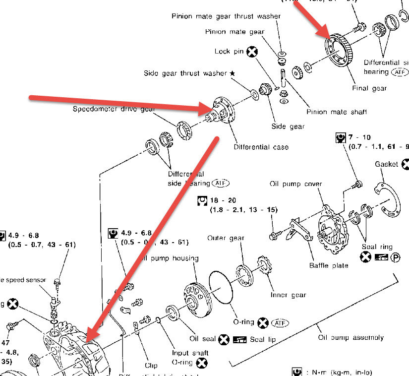

One friend of mine asked me to change the oil of the differential of her car. Her car is listed above with a 3.5. Is the oil of the differential of this car the same of the oil of the whole transmission?
Mar 9, 2017 at 4:07 AM
HMAC300
  • 48,601 POSTS
same as transmission use Nissan automatic transmission fluid Matick D or equivalent.
Mar 9, 2017 at 4:12 AM
BEMARE
  • 5 POSTS
Does the oil of the differential should be changed independently from the oil in transmission?
Mar 9, 2017 at 5:23 AM
HMAC300
  • 48,601 POSTS
No, it is part of the transmission, it is all internal. See picture.
