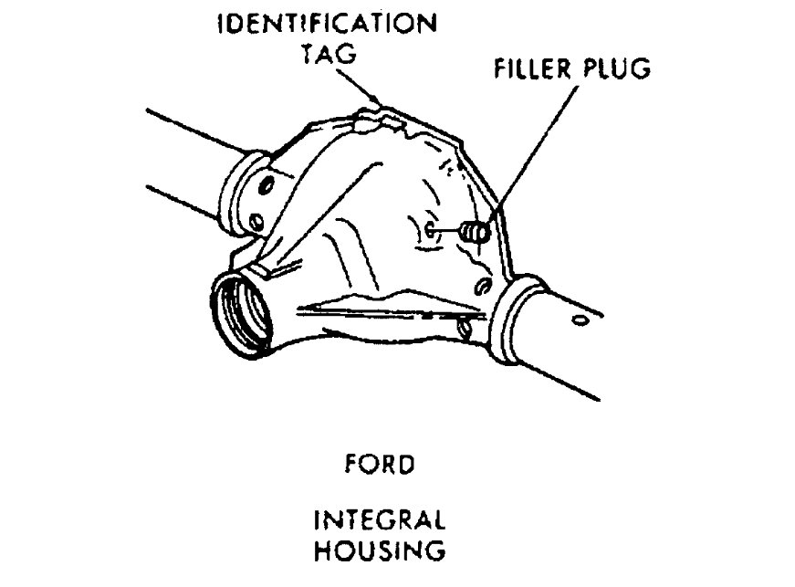

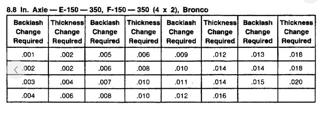

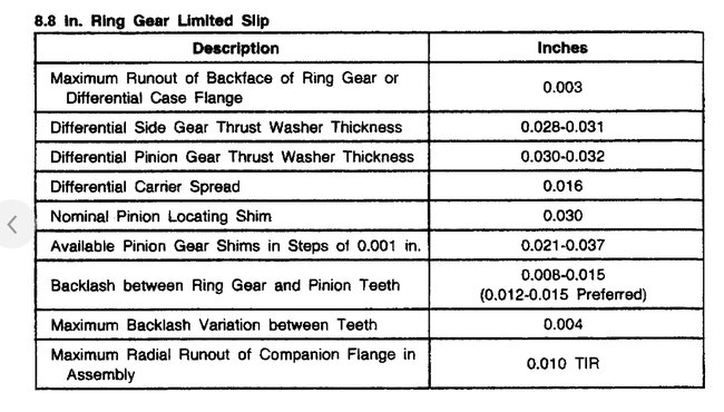

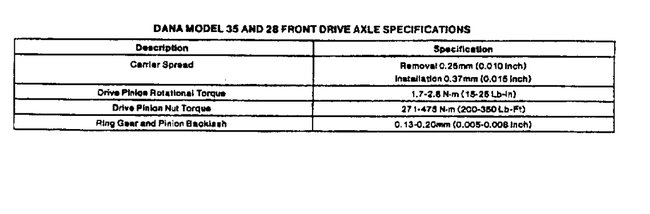

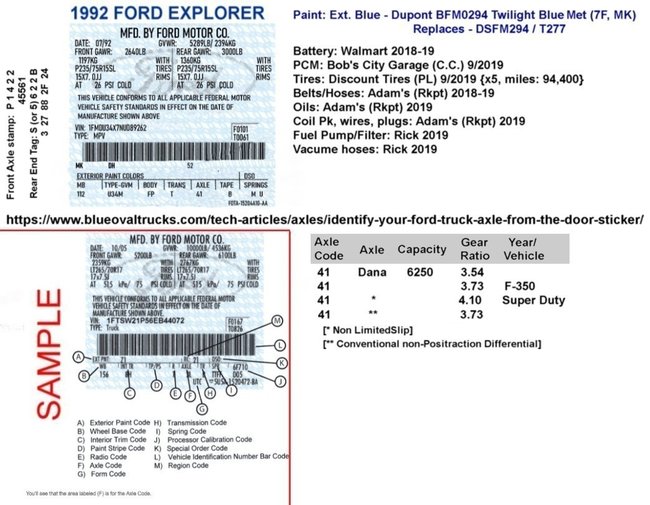

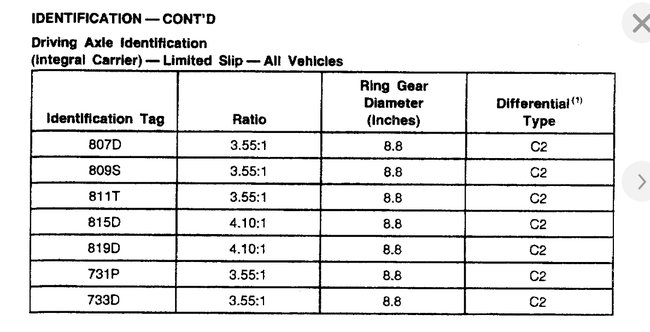

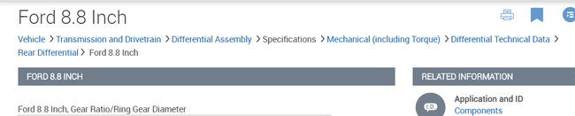

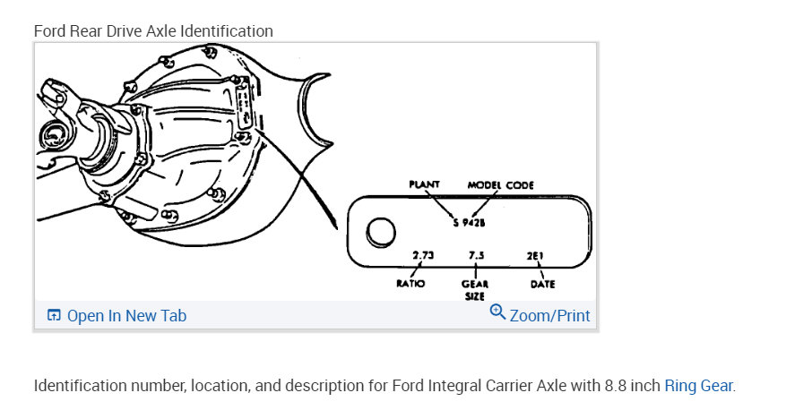

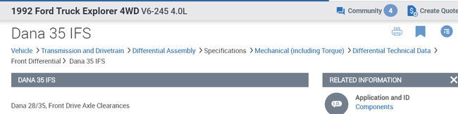

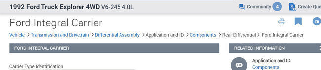

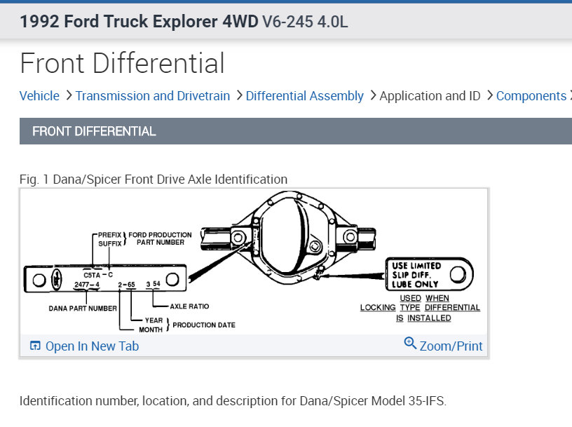

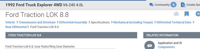

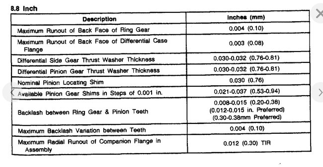

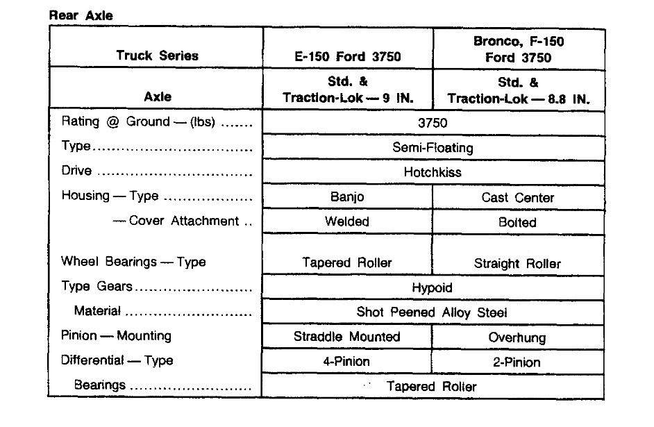

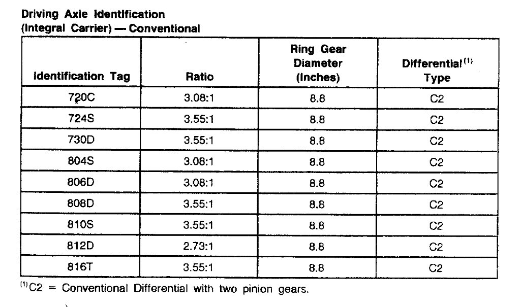

Trying to find out:
1) What gear ratio I have?
2) Detail information related to front-end (i.e, Dana, etc.), and rear-end, so I make sure I order and receive the correct parts when ordering.
[all information that I have found thus far, is located in picture]
Sep 12, 2019 at 9:33 AM
SCGRANTURISMO
  • 4,897 POSTS
I have included all the information that you requested in the diagrams down below. Please go through this information and get back to us with how everything turns out or if you have any questions.
