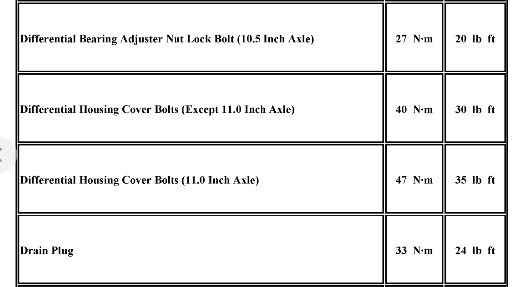

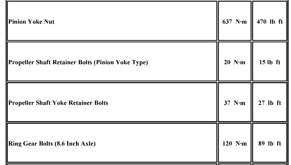

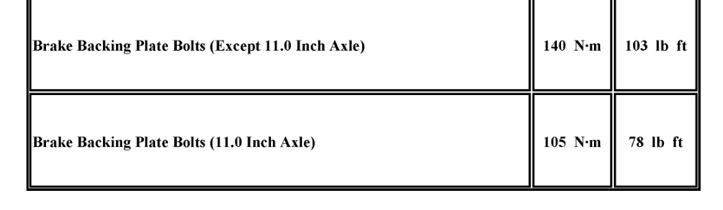

I need to know what the bolt dimensions are for the SYV listed above k2500.
The differential has a 8.5", 3.42 ratio ring in it, 10 bolt cover.

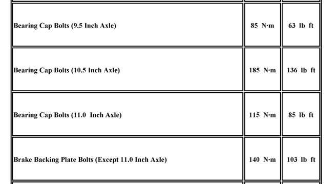

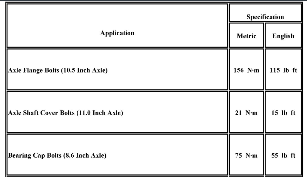

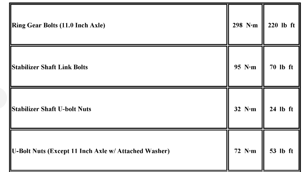

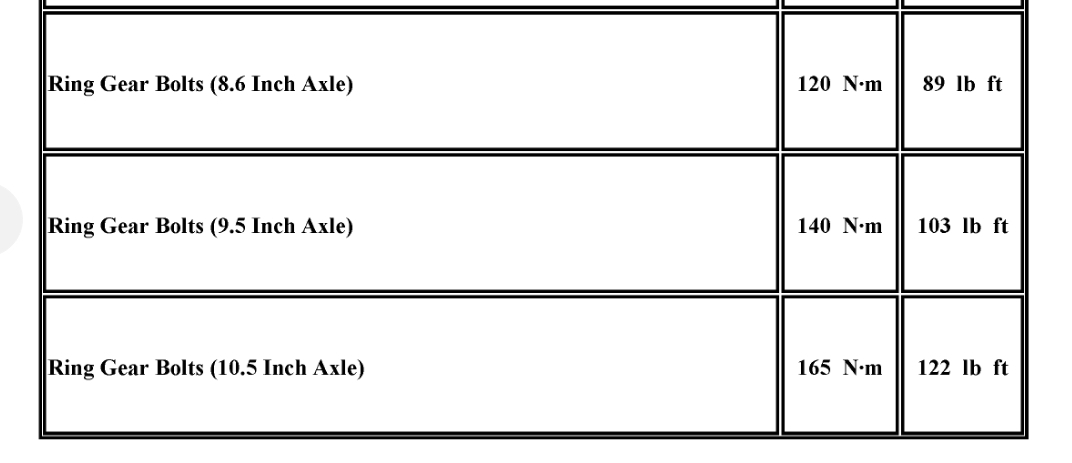

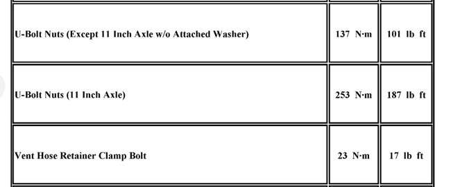

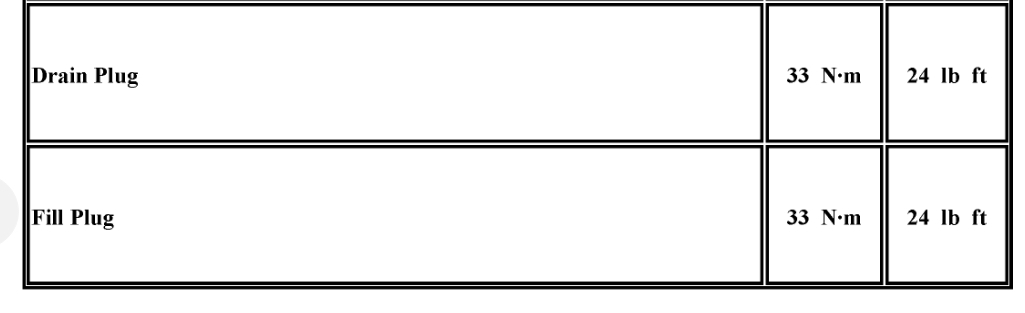

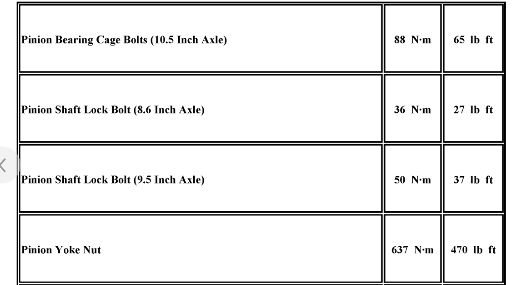

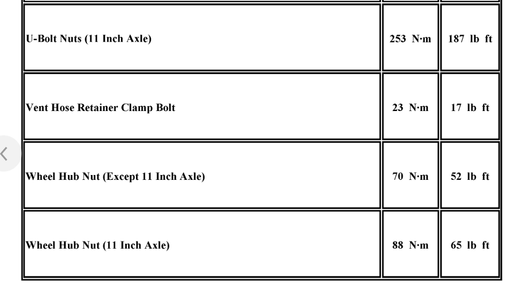

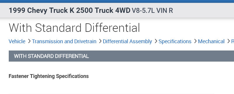

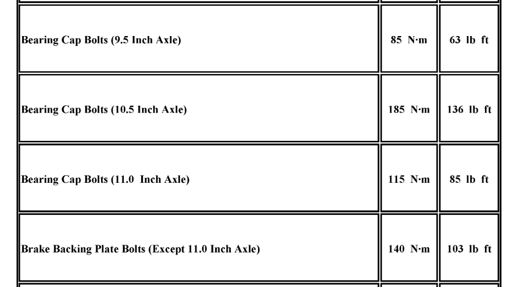

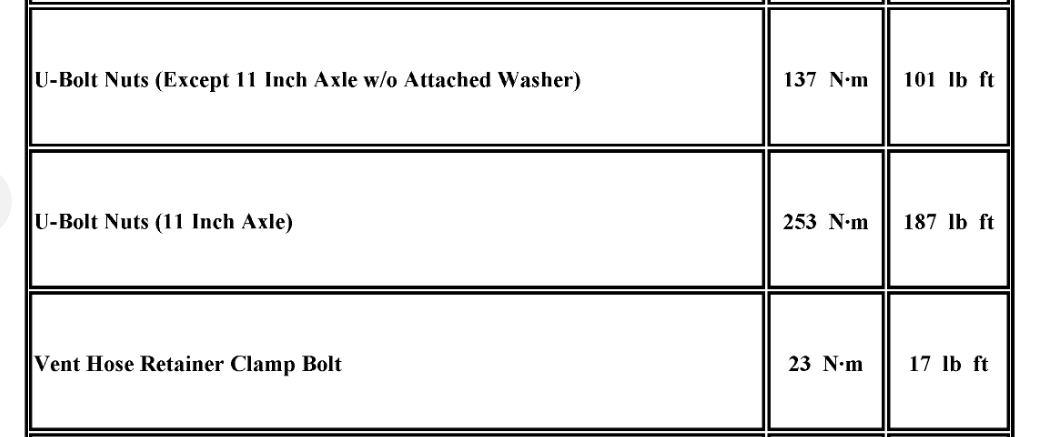

I have included the information that you requested in the diagrams down below. If you should have any other vehicle related questions, please feel free to ask. That is what we are here for.

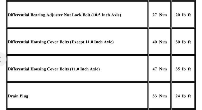

Thanks for the response Alex! Unfortunately the image you said isn't loading, it says image cannot be loaded at this time.
Apr 23, 2019 at 8:06 PM
SCGRANTURISMO
  • 4,897 POSTS

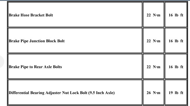

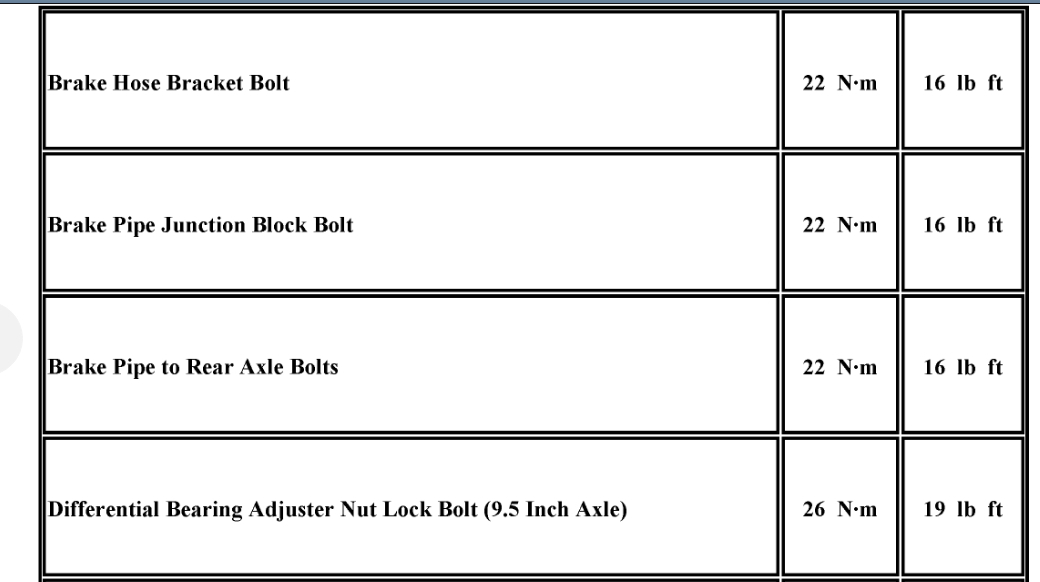

Sorry about that. I'm not sure what happened there. Here they are again.Also, I had a hard time finding out the size of the bolts used, but I would remove one of them and take it down to your local hardware store. Most hardware stores have an extensive fastener section where they can match the bolt up to what you need, and they are very reasonably priced, as well. Again, if you have any other vehicle related questions, please feel free to ask. that's what we are here for.
