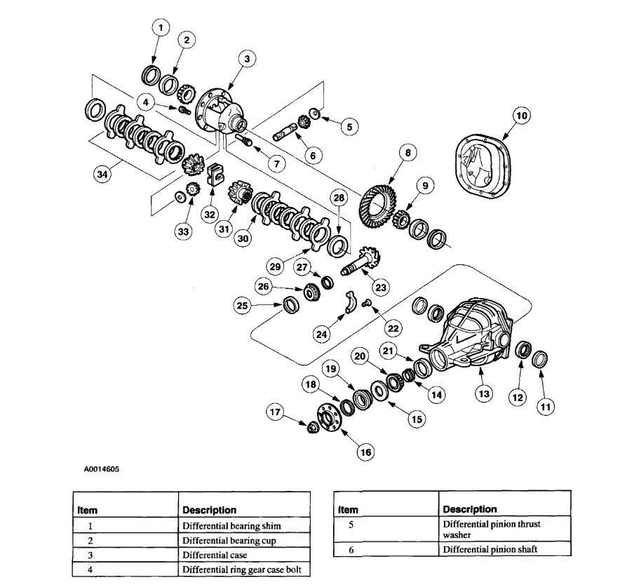

What is the clutch plate order on the axle gear?
2000 FORD MUSTANG
98,000 MILES • 4.6L • V8 • 2WD • AUTOMATIC
BRIAN CHILDRESS
MEMBER
19 POSTS
Differential clutch plates.

Hi Brian,
Here is the clutch order for your posi-traction rear differential. Check out the images (below). Let us know if you need anything else.
