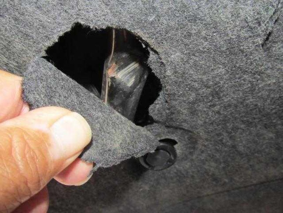

It was towed to a place where the service manager told me that I had hit something and there was significant damage to the undercarriage, including this hole. I remember actually hitting what was a piece of another car in the road some time about a month before this trip and I feel like this was the initial damage. The service manager acted like he was shocked that the previous (2nd) service center hadn't seen anything. But I don't know what would have been reasonable for either the first or second service center to have seen.

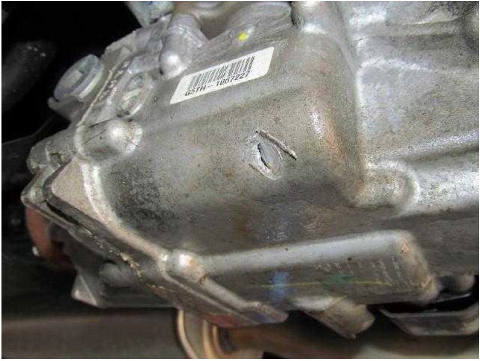

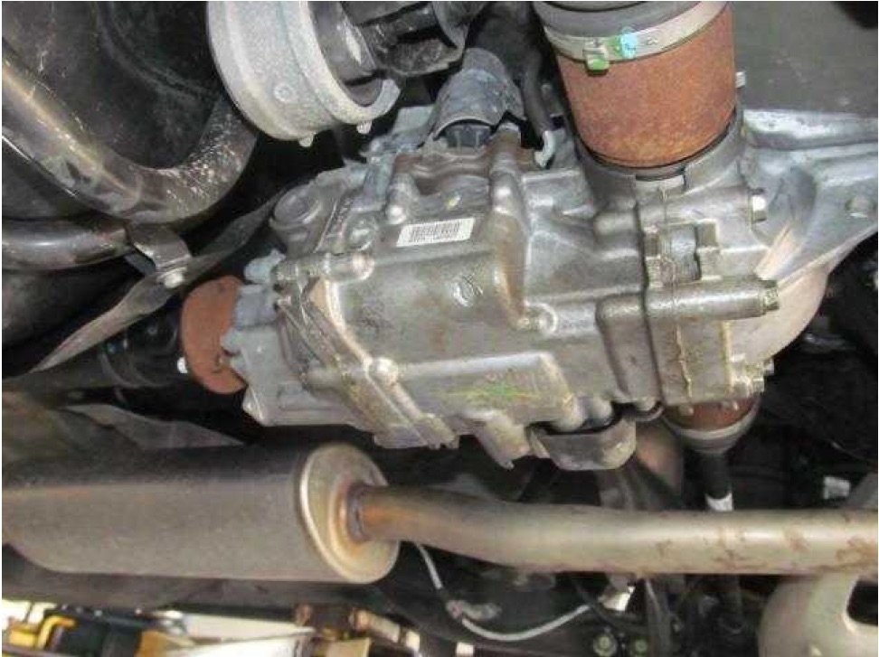

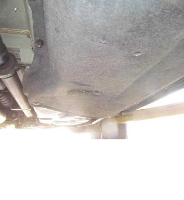

Oh absolutely, I understand not wanting to speculate on the work that a shop did or didn't do, and at this point it really doesn't matter as it's mostly taken care of. I just like to know, when things go wrong, exactly how it happened in case something similar happens in the future. And not knowing anything about cars really, I had no reference point for whether this is common or not or what to really expect from service shops in the future. I did add a couple of images too.. it's hard for me to tell really what I'm seeing here. :)
Jul 8, 2019 at 1:39 PM

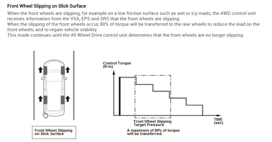

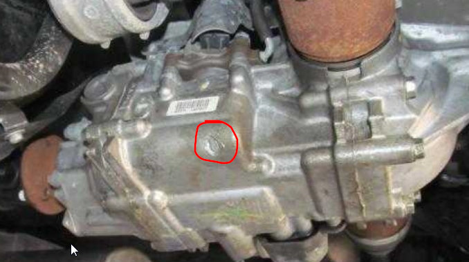

I completely understand wanting to know what happened. I am the same way. As for the pictures, the first two are of an under vehicle cover or mat. It is simply to keep the under body components clean and protected. The hole in it was caused by running over something. This by itself if not a big deal because it is just a heavy fabric. The last picture is of the rear differential. It is hard to see but I circled what appears to be a chunk out of the case. However, it is hard to tell if it actually put a hole in the case. This may explain why they didn't see if because if it is not an actual puncture through the case, then there was no fluid loss which is why I could not understand how a shop would miss this. If there was not fluid loss then they would have needed to actually inspect it to find it and if they didn't see a need to look at it because they didn't experience any issues on the test drive then that is not uncommon.

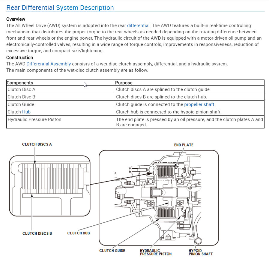

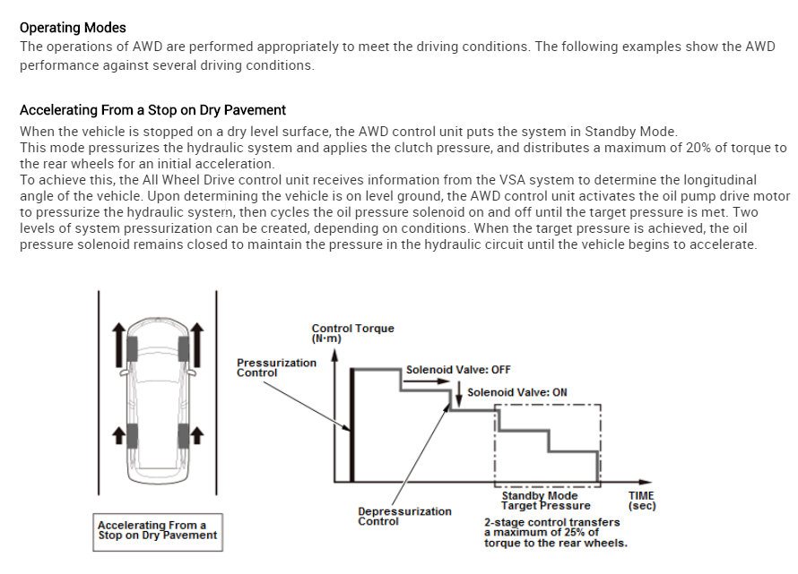

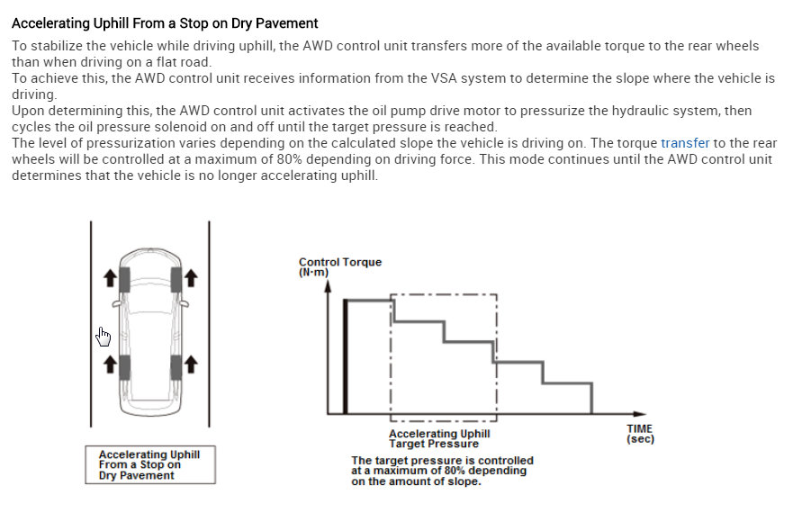

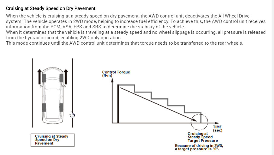

I suspect what happened was the grinding and jerking that you felt was the rear differential engaging when it shouldn't. This could have been caused by the damage but it is what we call an intermittent concern which is why the one shop did not find anything wrong. So when this is acting up and the light comes on the AWD system activates and when slowing down or turning it is grinding because it is normally off at this point. You have a system called a full time 4WD/AWD system. This means it is always in 2WD except when the computer determines the rear wheels are needed.
I attached the operation specifics of your system. As you will see on dry pavement from a take off, you should only have a MAX of 20% power going to the rear wheels but in most cases you will have none. If the AWD system is applying too much torque to the rear wheels then the clutches in the rear end will grind causing a noise and vibration.
I hope this makes sense. Please let me know what questions you have and I will do my best to explain further because this gets pretty far off into the weeds of technical information. Thanks

Yes, thank you, this is very helpful! It does make some sense and explains why it seemed so much worse when I was in slow, stop-and-go traffic. I guess there's no way of really knowing why the car's computer would've activated the AWD system when it didn't need to be? These intermittent problems must be extremely frustrating! :) By the time I stopped my car, something had definitely deteriorated...the grinding and lurching got worse to the point where I actually thought I was dragging something underneath my car. Was that just too much power going to the back wheels? Or do you think that could have been caused by fluid loss? I attached a better, closer picture of the damage to the case if that's more helpful at all. Thank you again!
Jul 10, 2019 at 6:22 AM
Okay. So there was a hole in it but I assume this is after it was all cleaned up because if the fluid leaked out it would be covered in an oily mess.
Yes. if the fluid leaked out then it will only get worse because the clutches inside are meant to slip and they can only do that if they are lubricated. When they don't have the fluid they lock up.
