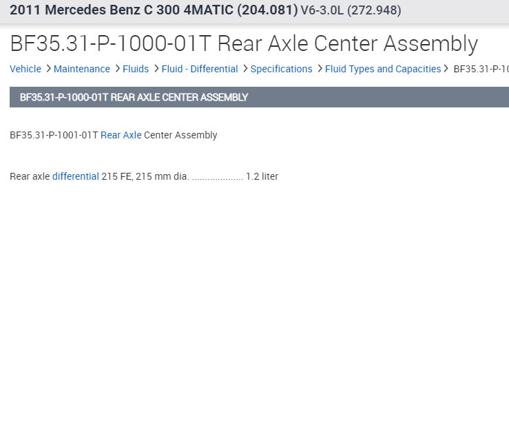

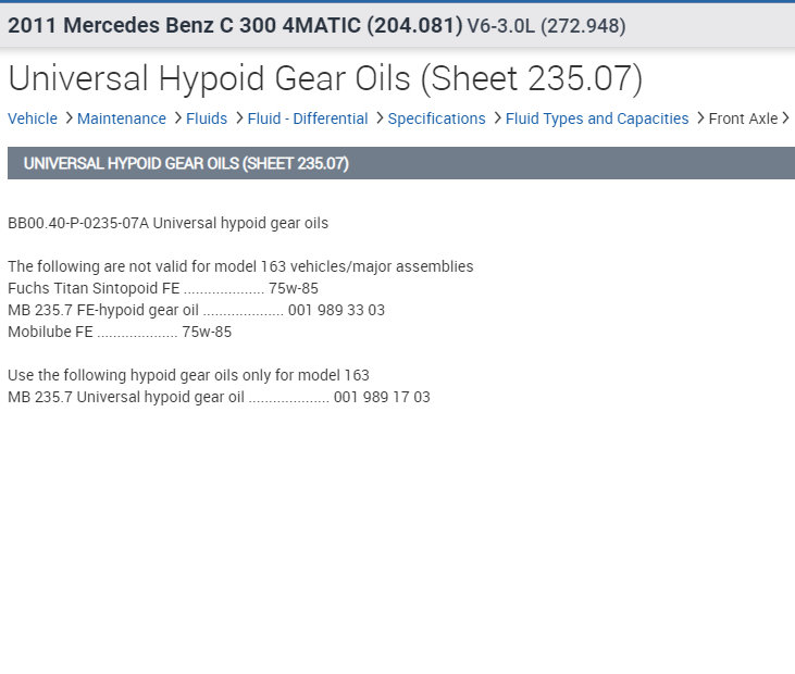

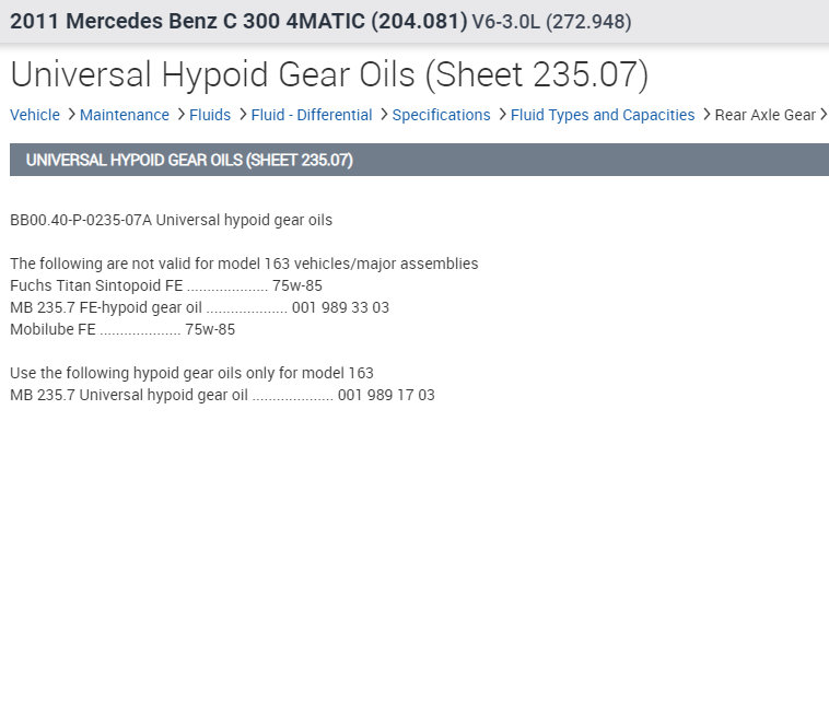

I am changing my rear differential fluid. I believe the correct fluid is 75W-90 for the rear. My question is, does the front differential share fluid with the transmission or does it need a different fluid? If so what fluid?

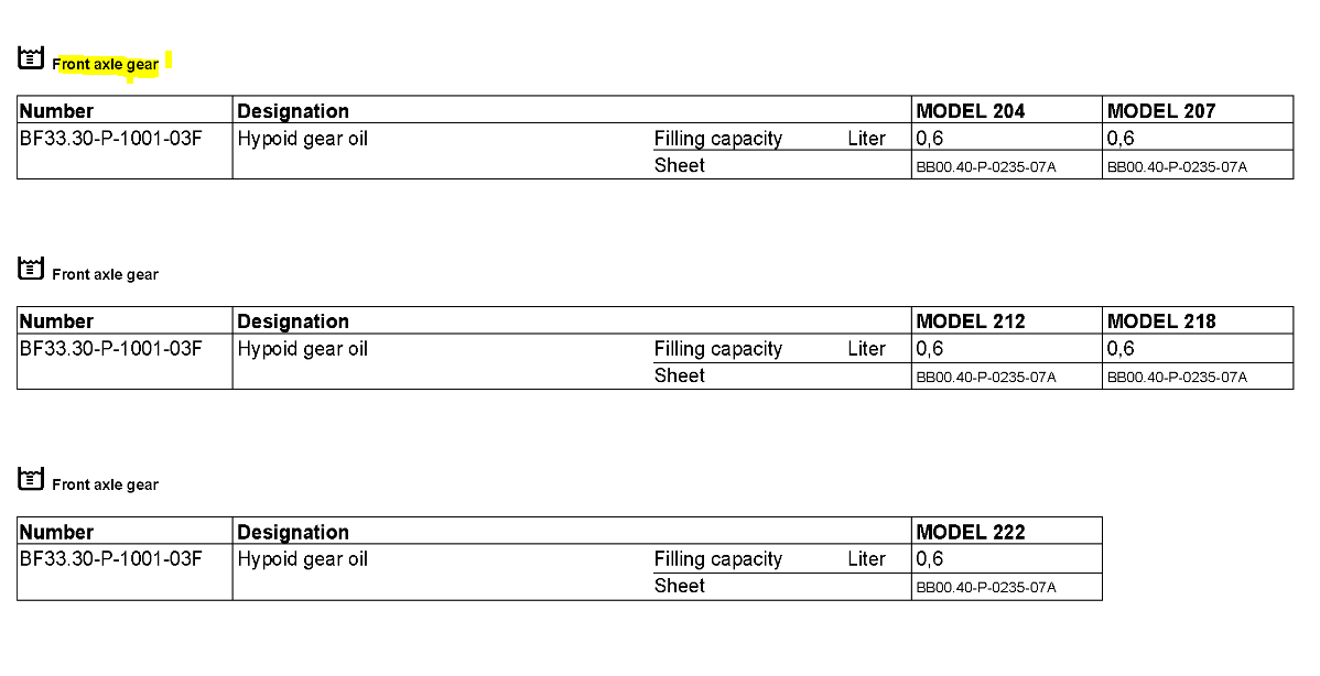

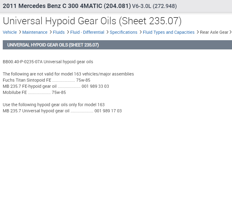

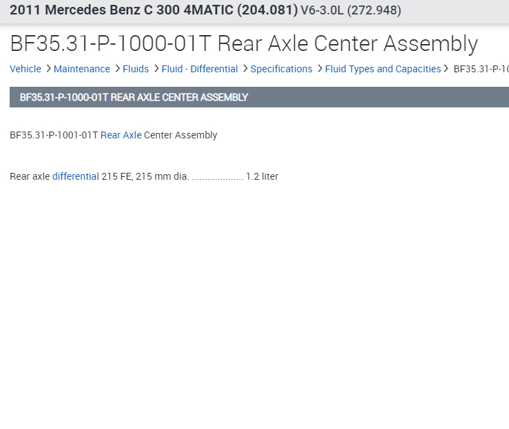

On this vehicle the book actually calls for 75W-85 gear oil for both front and rear differentials.
The front differential capacity is 0.6 liter and the rear 1.2 liter.
