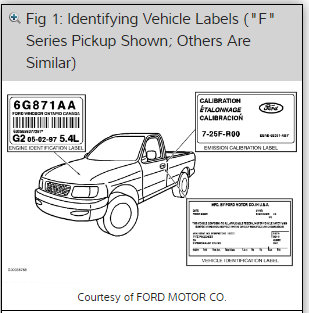

I have truck listed above, but the engine has been changed out. It is a 1997 4.6. Where do I check on the engine to know if it is a 6 or a w?

Hello, I am Danny.
If you have access to the donor vehicle information it would be the eighth digit of the VIN number.
