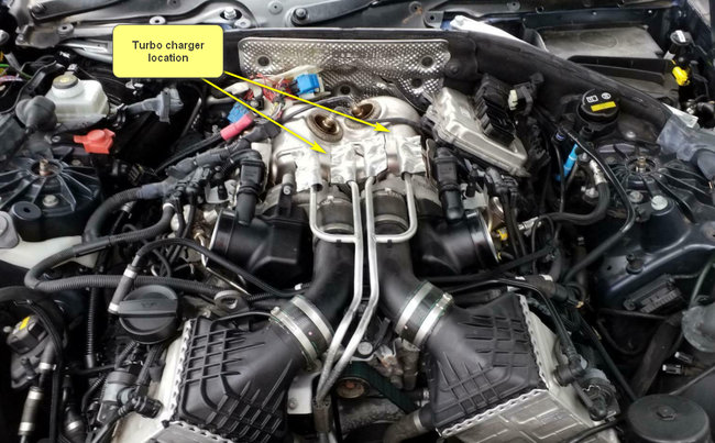

i need to replace turbo feed/return lines
2015 BMW 550I
96,000 MILES • V8 • 4WD • AUTOMATIC
OBREGON51
July 20, 2020 they replace both sections of turbocharger coolant return line, replaced both sections of the turbocharger coolant return line. May 10, 2022 i am being told that i need to replace turbo feed/return lines.

The turbo charger feed and return lines would point towards the oil feed and oil return lines.
The BMW 4.4V8 turbo engine is prone to oil leaks from these lines. Oil usually builds up inside the V valley. The turbo chargers are located inside this valley between the cylinder heads, see image below.
Hope this helps.
