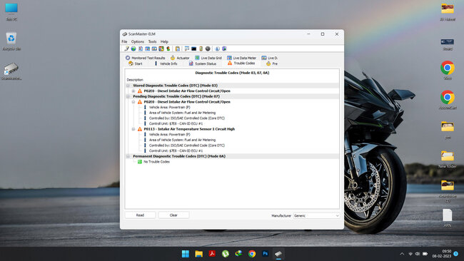

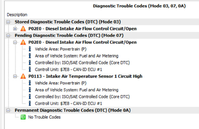

Hi. I am from India and i have Ford Fiesta Diesel 2011 Global car. Recently i have the engine check light on and when i scanned it i got two errors.
P02E0 and P0113. Screenshot attached.
I tried searching on Google for the same, but it gives mixed results and i am not sure what could be the fault reason.
Is it MAF related, or do I have Open circuit somewhere?
Need your Help

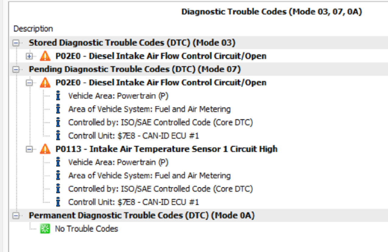

Picture Uploaded.

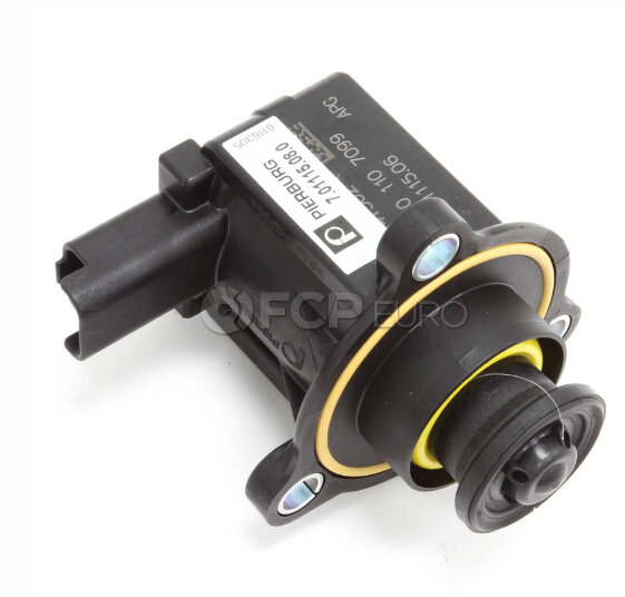

These are all intake codes, does this car have a turbo? If so, I would check the air filter first to make sure it is not clogged, and if not, I would remove the intake or output tube of the turbo and check the turbo main shaft play. What happens is the turbo wears out and causes the temperatures to rise which will give you the P0113 code or it can be the other two codes are causing it which indicate there is an open circuit to the flow control valve. It should look like the example in the images below. If the wiring looks good, I would replace the valve. Please let me know what happens.
