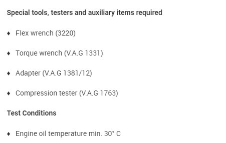

I need to run a compression test on the car listed above TDI with a four cylinder, not sure what size, can't find it on door jamb or under hood. Do I have to access the fuel pump relay and unplug it?

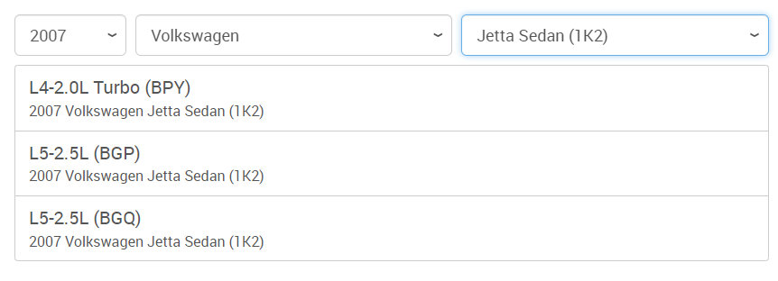

I would be happy to help, but there is no Jetta TDI for model years 2007 through 2008. By chance, could it be a different model year? They made them in 2006 and 2009.
See pic 1 below for engine options during the 2007 model year.

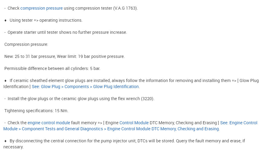

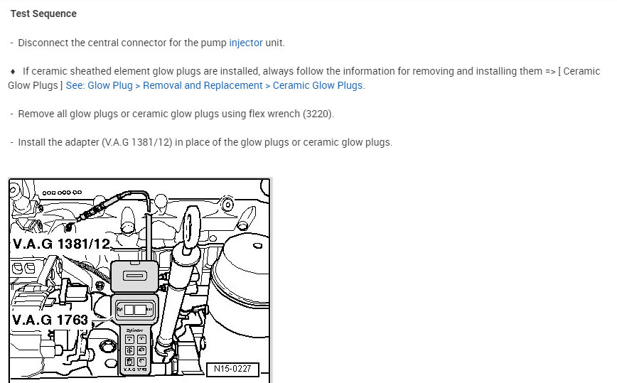

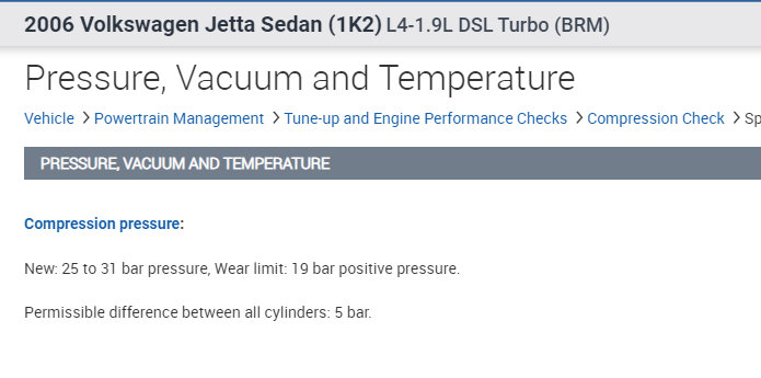

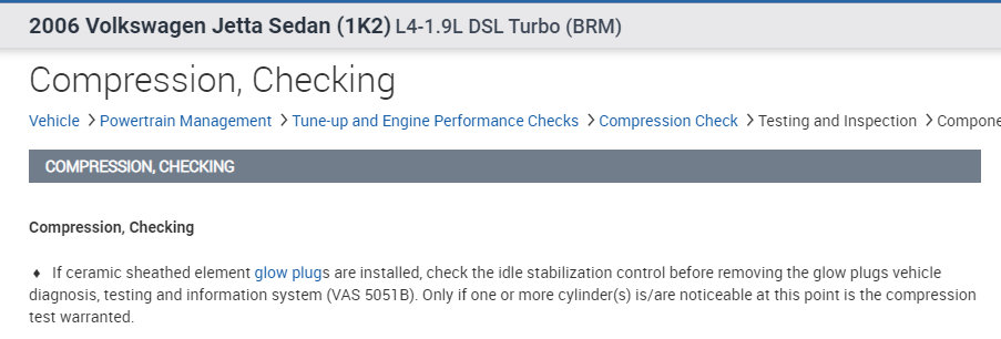

If you look at the remaining pictures, they provide the procedure for a compression test on a 2006 1.9L TDI Jetta. The last pic attached provides the manufacturer's specs.
Let me know if this helps or if I have the wrong model year.

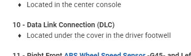

I've been looking for the OBDII port and can't find it?
Sep 16, 2022 at 3:24 PM
  • 110,244 POSTS
The DLC is located under a cover on the driver's side footwell. Sometimes I think they try to hide them. LOL
