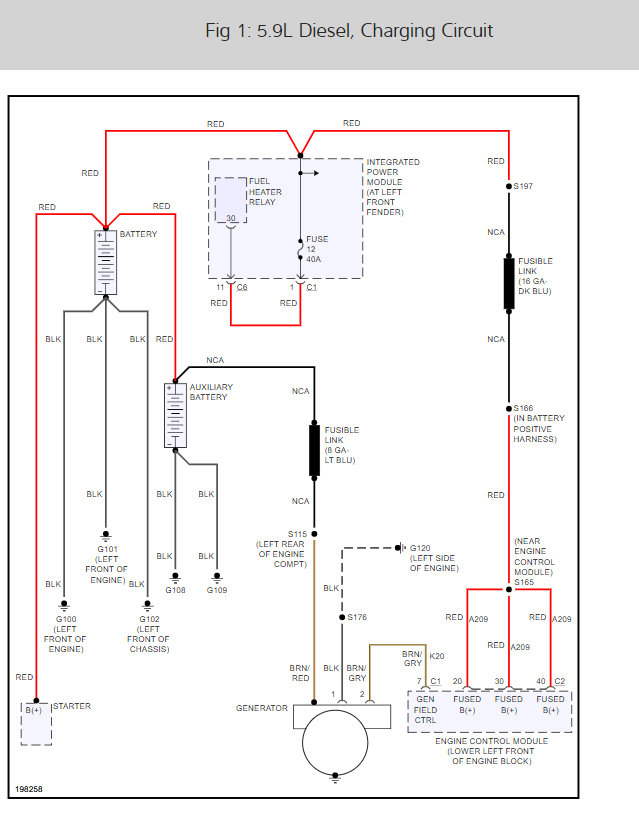

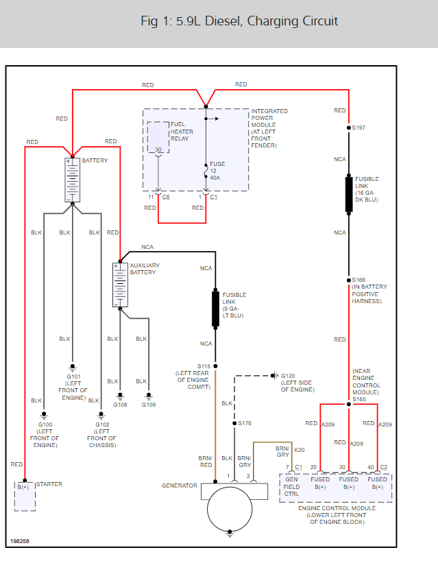

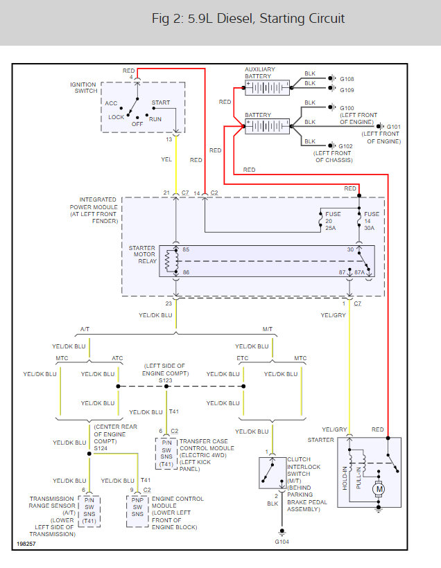

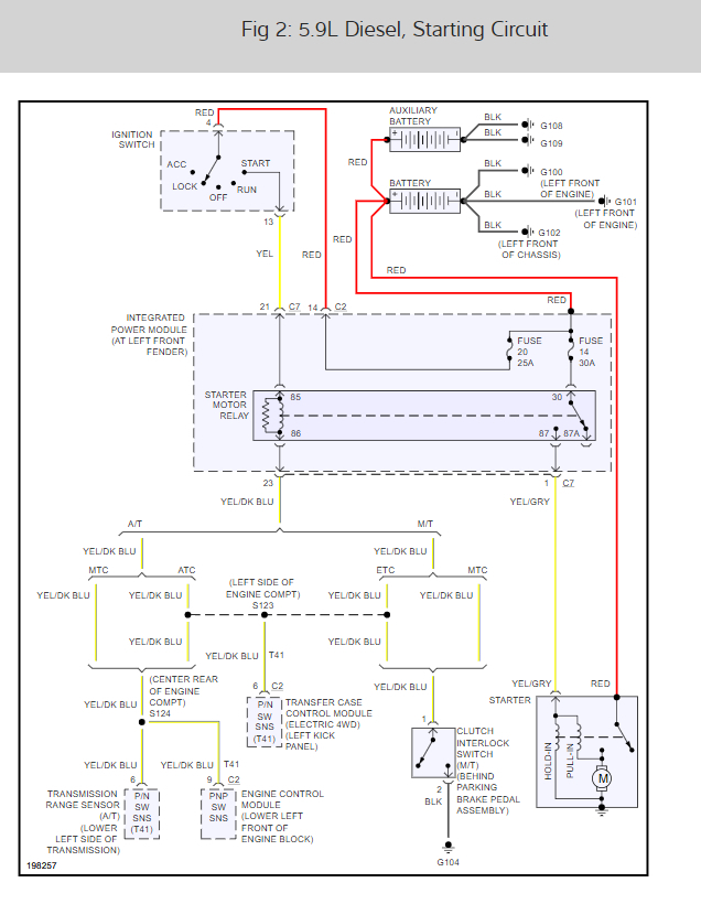

Replaced ignition switch rebuilt ECM, checked fuses relays and fuse box connection. replaced natural switch cleaned contacts OBS reader failed to communicate with ECM. problem is no cranking of engine, no start, no dash lights, no signals, back up lights come on. only sound is fuel pump when ignition turned to start and run.

Look at these wiring diagrams it show main power points which need to be tested to see if you have a fusible link that is blown etc. This guide will help you test for power with the main power feed wiring below;
