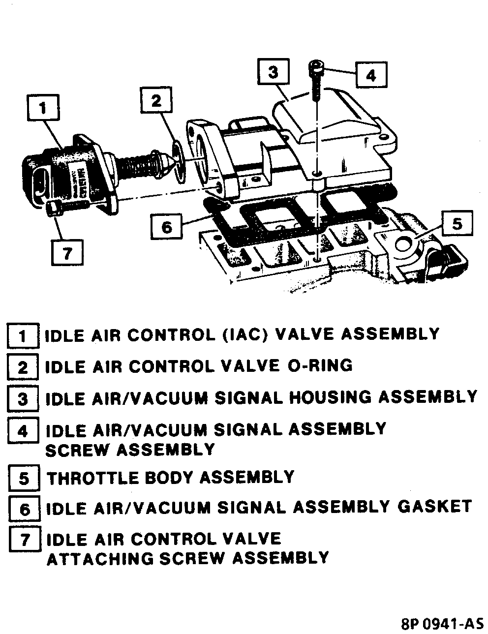

When sitting at an idle it idles up and down and when you take off it wants to shuts off on you and when you're running down the road if the speed ever levels out it wants to sputter and buck when you mash the brakes to come to a stop it wants to shut off

What you described can be the result of a few things. Since the idle speed goes up and down, the most common cause is a bad idle air control valve (IAC). This component is located on the throttle body and easy to replace. When they go bad, it can happen one of two ways. First, the valve no longer responds to the computers request to adjust idle speed or there is a carbon build up on the valve or where it is located preventing it to function properly. To check that, simply remove and inspect.

If you find there are no vacuum leaks, then I suspect the IAC needs replaced. Please keep in mind, before you replace parts, make sure there are no leaks, and basic things like a plugged air filter or disconnected air intake tube isn't the cause.

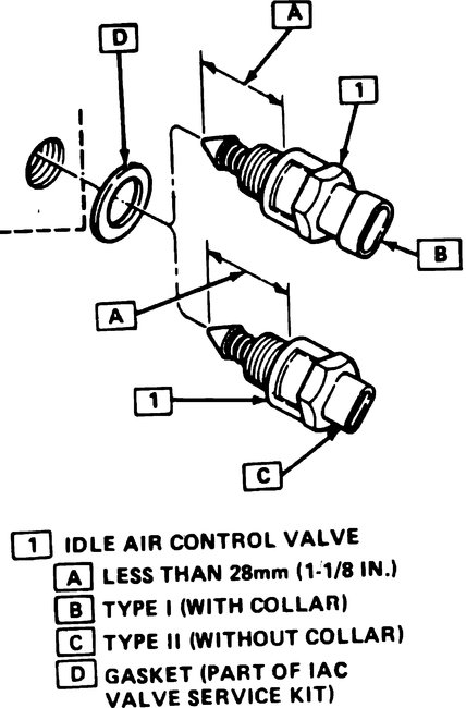

1988 Buick Century V6-231 3.8L
Idle Air Control (IAC) Valve Replacement
Vehicle Powertrain Management Fuel Delivery and Air Induction Idle Speed/Throttle Actuator - Electronic Service and Repair Procedures Idle Air Control (IAC) Valve Replacement
IDLE AIR CONTROL (IAC) VALVE REPLACEMENT
Removal
1. Disconnect IAC valve electrical connector.
2. Remove IAC valve attaching screws, if equipped then the valve using a suitable 1-1/4 inch wrench and discard gasket.
Fig. 356 Typical IAC valve installation
Pic 1
Installation
Prior to installation, identify IAC valve as being either Type 1 or Type 2, Fig. 356. If dimension ``A'' is greater than 1-1/8 inch, reduce as follows:
On Type 1, exert a firm pressure on conical valve to retract it.
On Type 2, while turning valve in clockwise rotation, compress retaining spring from conical valve. Return spring to original position with straight part of spring end aligned with flat surface of valve.
1. Install IAC valve in throttle body using new gasket. Torque IAC valve to 13 ft. lbs.

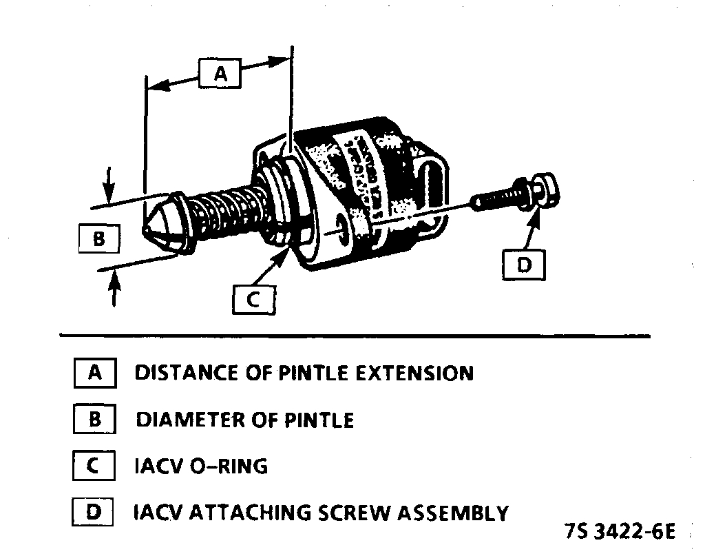

Here are the directions if it is a 2.8L V6
Pics 2 and 3 correlate with the directions.

1988 Buick Century V6-173 2.8L
Idle Air / Vacuum Signal Housing
Pic 1
REMOVE
Negative Battery terminal.
Electrical connector.
Idle Air Control (IAC) valve attaching screws.
IAC valve assembly.
CAUTION:
On IAC valves that have been in service: Do Not push or pull on the IAC valve pintle. The force required to move the pintle may damage the threads on the worm drive. Also, Do Not soak IAC valve in any liquid cleaner or solvent, as damage may result.
CLEANING AND INSPECTION
Clean IAC Valve O-Ring Sealing Surface, Pintle Valve Seat And Air Passage.
Use carburetor cleaner and a parts cleaning brush to remove carbon deposits. Do Not use a cleaner that contains methyl ethyl ketone, an extremely strong solvent, and not necessary for this type of deposit.
Shiny spots on the pintle or seat are normal, and do not indicate misalignment or a bent pintle shaft.
If air passage has heavy deposits, remove throttle body for complete cleaning.
Inspect IAC valve O-Ring for cuts, cracks or distortion. Replace if damaged.
NOTICE: If installing a new IAC valve, be sure to replace with an identical part. IAC valve pintle shape and diameter are designed for the specific application.
Pic 2
MEASURE
If Installing a new IAC Valve measure the distance between tip of IAC valve pintle and mounting flange. If greater than 28 mm, use finger pressure to slowly retract the pintle. The force required to retract the pintle of a new valve will not cause damage to the valve.
