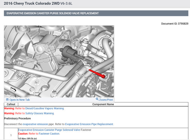

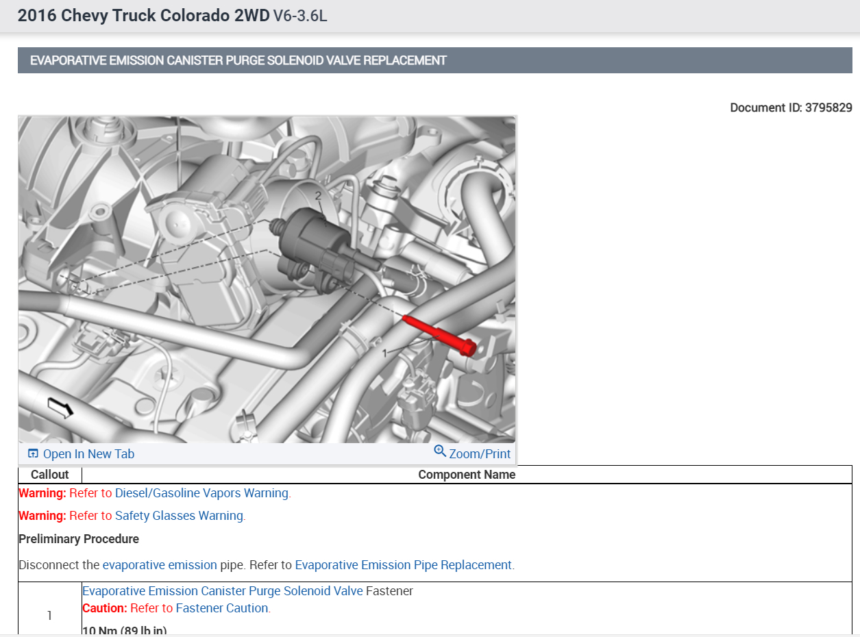

The purge solenoid could be stuck open remove the valve and try to blow through it to confirm, here is the location in the images below. Let me know what you find.
