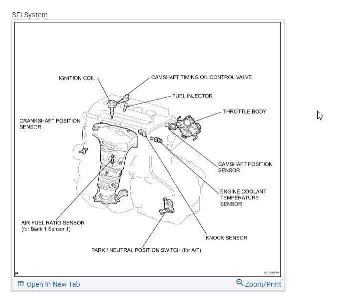

This sounds very much like a crank sensor issue. Clearly there could be other causes but let's start with inspecting the spark plugs when this happens. If you have no spark then I suspect the CKP sensor is the issue. Inspect this by pulling a plug and holding it against the block to see if it sparks when cranking the engine as it is not starting.

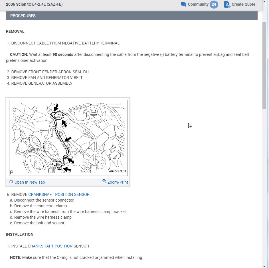

Here is a guide that goes into detail about this issue:

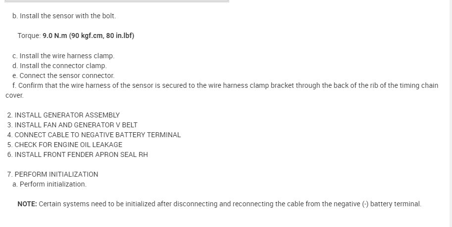

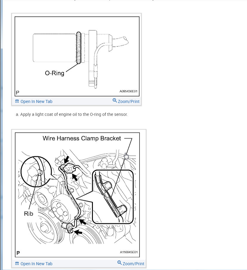

I attached the procedure for this if that proves out. Let me know if you have questions.
