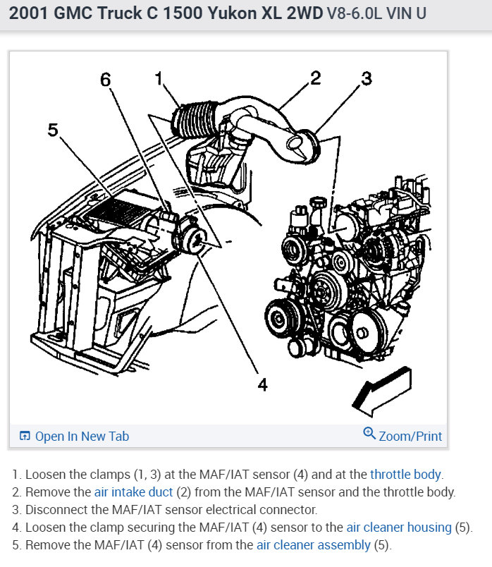

Was driving truck when I slowed down the truck shut off. It will restart but wants to shut off on idle. Checked fuel pump and fuel filter. Thought maybe bad gas so I drove to store to get new gas I then seen smoke from cab and looked under and seen one of the catalytic converters flowing cherry red. I thought it was stopped up. I took to muffler shop said it would be a misfire and running too rich making extra fuel burn. So I drove home replaced all plugs and wires. had no misfire code. had a EGR valve code. So I took off EGR valve and it is stuck. Will not open or close. So I bought new one and put on and truck still wants to shut off. If I take off EGR valve It runs great and idle but as soon as I put EGR valve back on it shuts off. I can keep running by giving gas but has a hesitation. Cannot seem to find problem. Any help will be grateful.

p0101 p0300 p0405 are the only codes been showing.
Oct 25, 2018 at 7:45 AM
  • 55,694 POSTS
the first code is a problem with the MAF sensor which is common I would by a new one and install it. Cleaning it will not help at this point with that many limes you need a new one anyway. Here is a guide to help you see what you are in for when doing the job.
https://www.2carpros.com/articles/how-to-replace-a-mass-air-flow-sensor-maf
Please service the throttle bore as well.
Here are doaigran to help you on your truck below. Please let us know what happens.

Put new mass air flow sensor on and cleaned throttle body. Still doing same thing. Will not stay running on idle.
