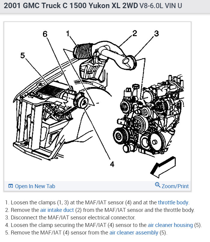

the first code is a problem with the MAF sensor which is common I would by a new one and install it. Cleaning it will not help at this point with that many limes you need a new one anyway. Here is a guide to help you see what you are in for when doing the job.
https://www.2carpros.com/articles/how-to-replace-a-mass-air-flow-sensor-maf
Please service the throttle bore as well.
Here are doaigran to help you on your truck below. Please let us know what happens.

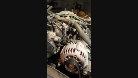

Cleared codes ran down road few mile. Codes p0300 and p0101 came back. It ideals somewhat okay here but can hear a hissing sound like a vacuum leak or something when giving gas. After running down the road it will not idle.
Nov 2, 2018 at 1:01 AM
JASONWRAY23
  • 5 POSTS

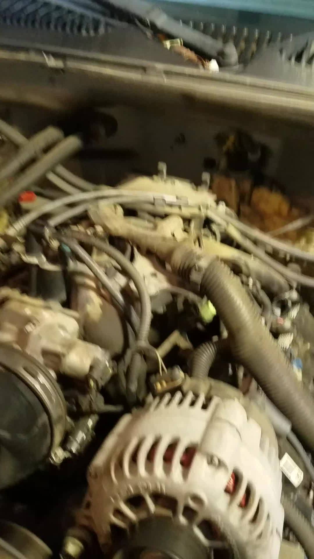

Here is another:
Nov 2, 2018 at 1:34 AM
  • 55,286 POSTS
Thank you for the videos. Let's remove the serpentine belt then start the engine to see if the noise goes away. Next it looks like you have low compression in one or more cylinders. Lets remove the spark plugs and run this test.
