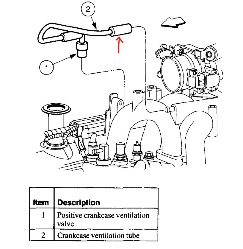

The car will start if you give it gas but as soon as the RPMs lower it shuts off. I have no check engine light or codes I replaced the fuel pump, fuel filter, cam sensor, fuel pressure regulator, idle air control valve also checked fuel pressure with a gauge and it was fine.
Dec 3, 2024 at 2:23 AM
  • 55,694 POSTS

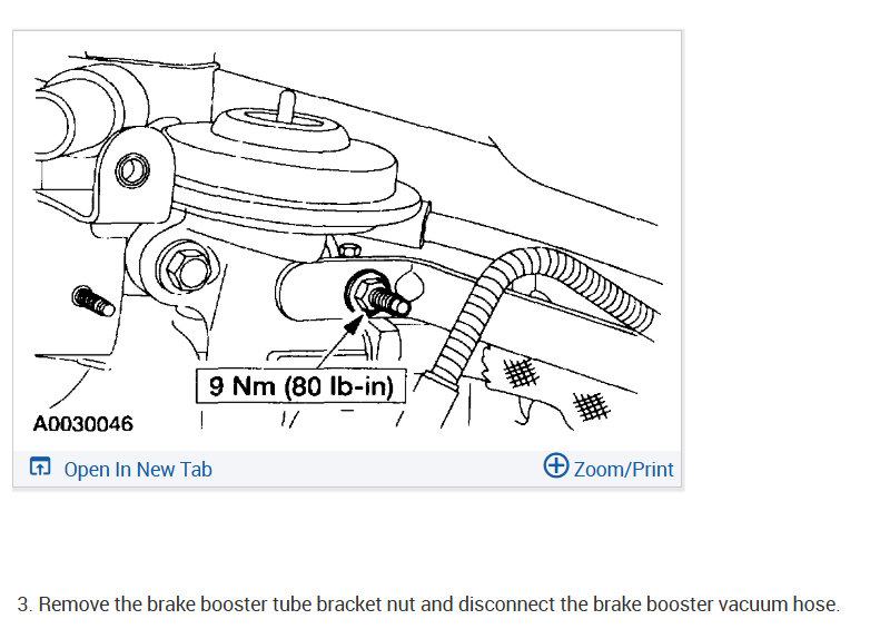

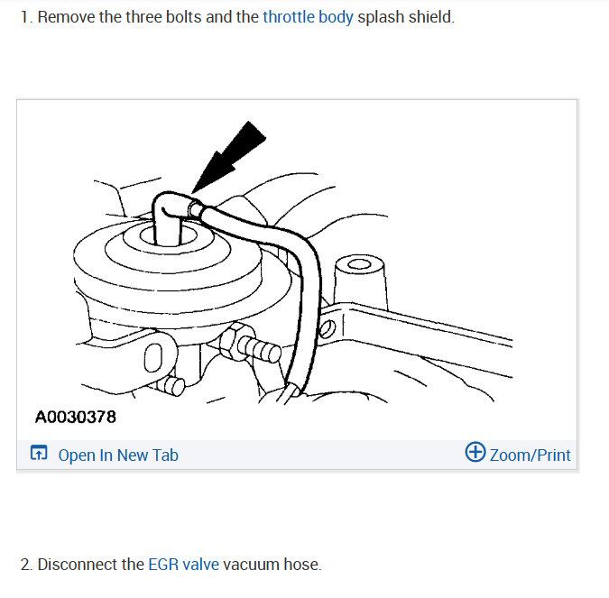

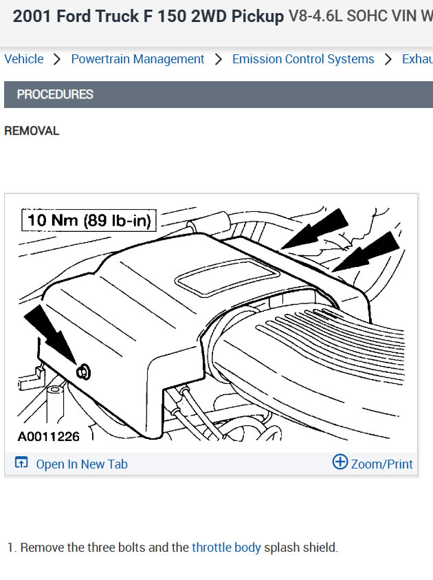

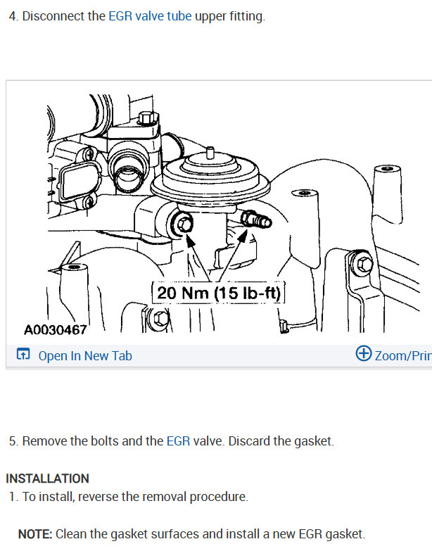

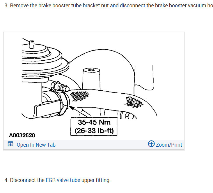

It sounds like you have a vacuum leak which can be at the PCV valve feed line which I have marked in the images below or the EGR valve is not closing completely.
Here is a guide to help you see the easy problems that can cause this issue:
Here is a video to how you how to test the EGR valve and how to remove it in the images below:
https://www.youtube.com/watch?v=DqUCbbKdWf4&t
