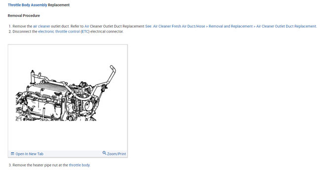

It runs great driving, but shuts off when stopping/stopped.

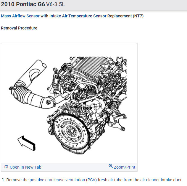

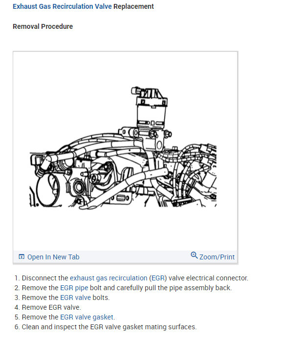

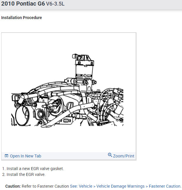

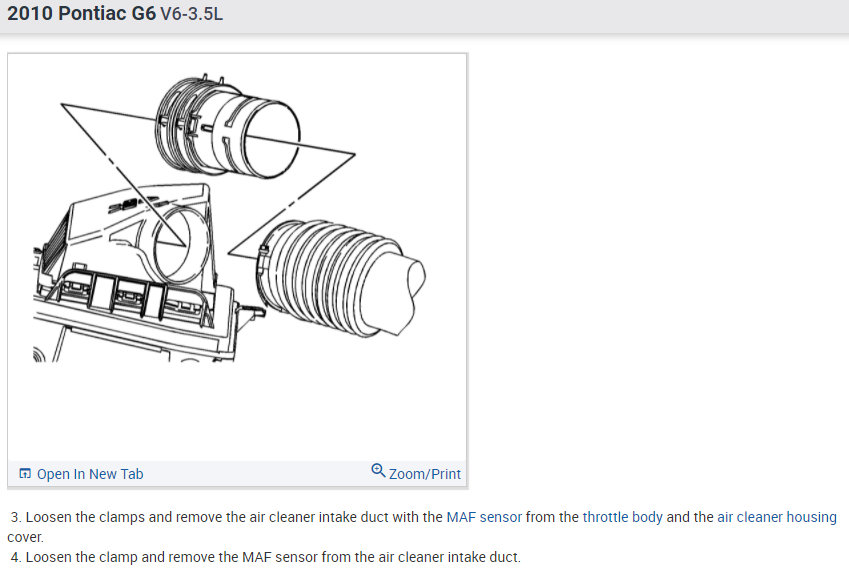

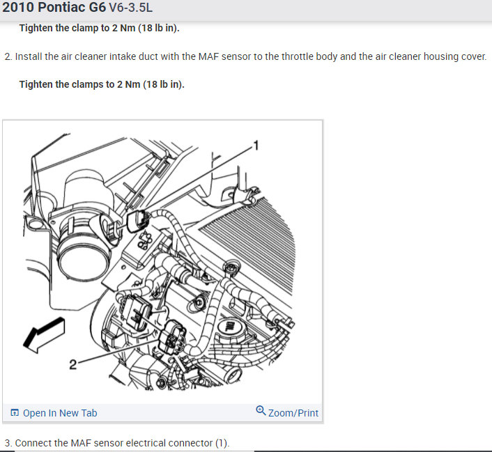

Is your check engine light on? If so what are the codes?
This could point us to the right direction:

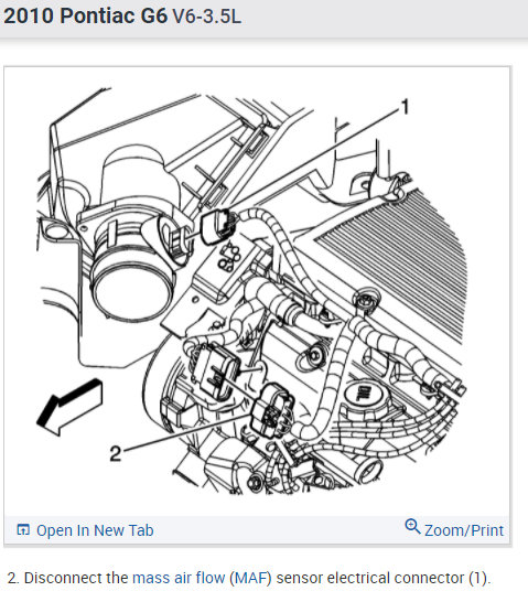

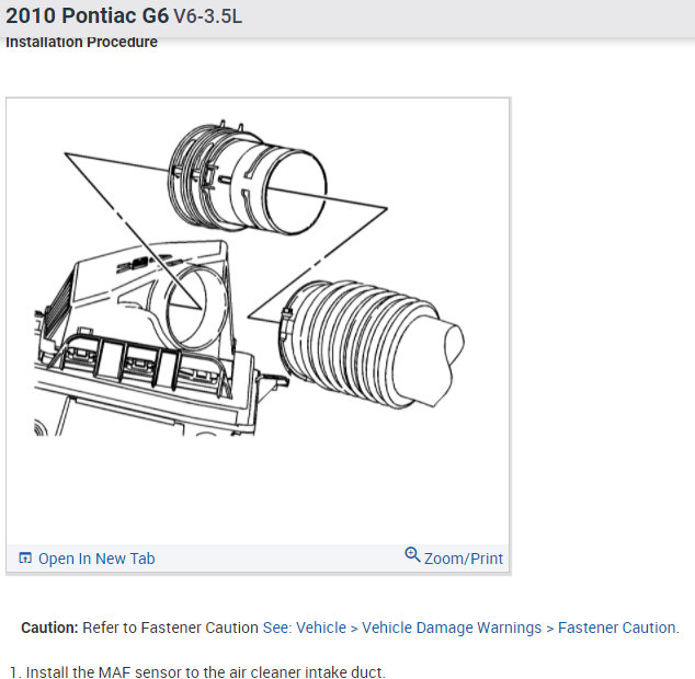

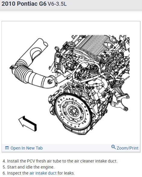

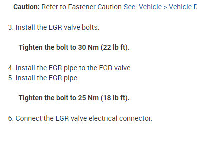

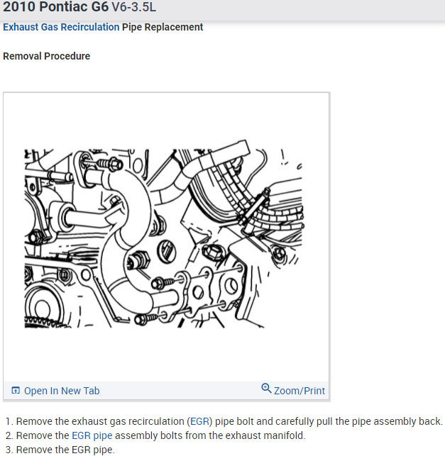

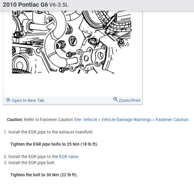

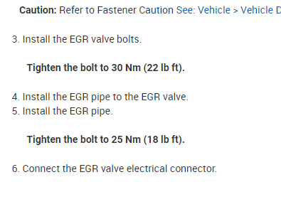

You could have a dirty mass air flow sensor or it could be a clogged EGR valve.
You might find these articles helpful:
https://www.2carpros.com/articles/how-a-mass-air-flow-sensor-works-maf
https://www.2carpros.com/articles/mass-air-flow-service
https://www.2carpros.com/articles/how-to-replace-a-mass-air-flow-sensor-maf

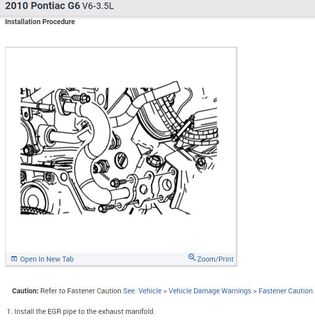

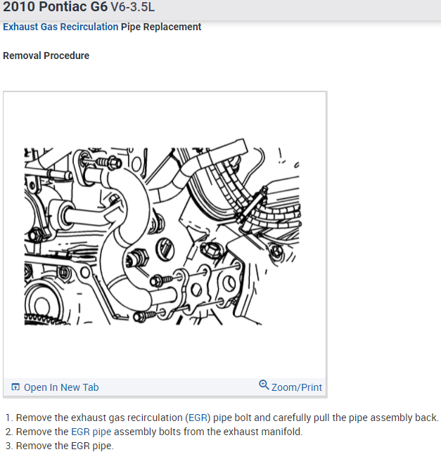

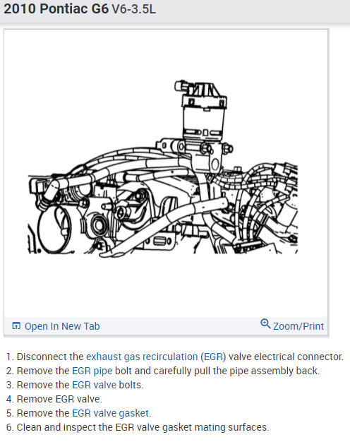

I have attached EGR and MAF replacement procedures for your reference.
Let me know of any questions.

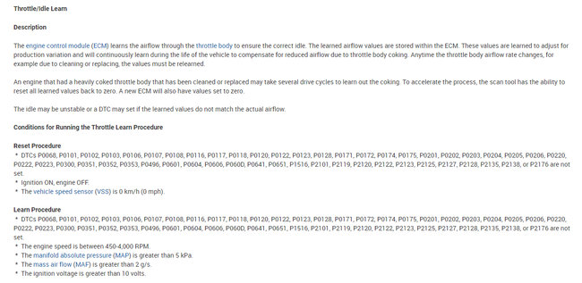

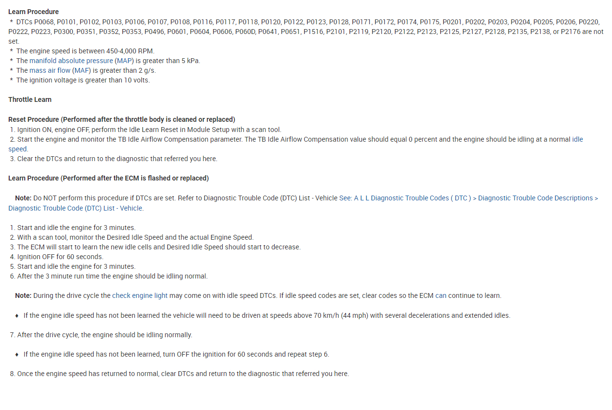

Good evening,

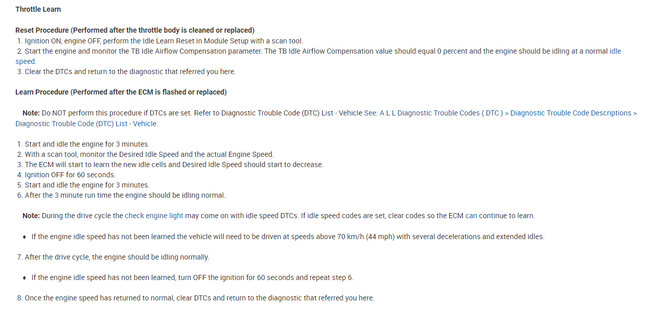

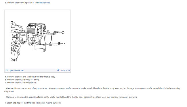

This could be a dirty throttle body from coking or carbon build-up on the throttle plate. I attached a guide below in cleaning the throttle body for you.
Another possibility is the EGR valve being stuck open from a piece of carbon.
I would remove the valve and look underneath and see if there is carbon holding the pindle partially open.
