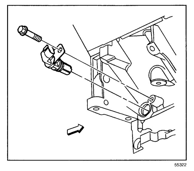

Runs fine when cool outside, gets around 85 degrees out and going down the highway just quits running. Let sit for ten minutes starts back up twenty miles later shuts off again.
Sunday, October 7th, 2018 AT 12:12 PM
  • 109,885 POSTS
Based on your description, it sounds like you may have a faulty crankshaft position sensor. As they heat up, the coils internally expand and lose connection. Thus, the engine stalls due to no spark from the ignition. Take a look through this link.
Here is a link that shows in general how one is replaced:
When the engine stalls, if it takes time for it to restart, this is my first suspect. In the event that this happens again to you, if possible, I would you to test if the engine is getting spark. Here is a link that shows how it is done:

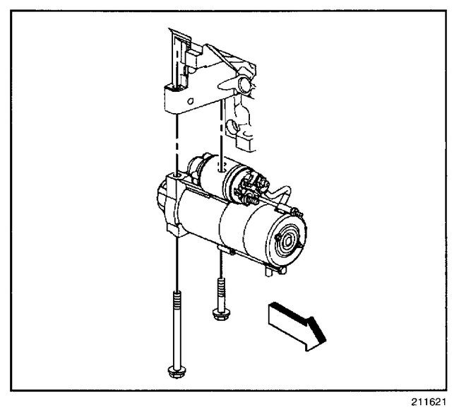

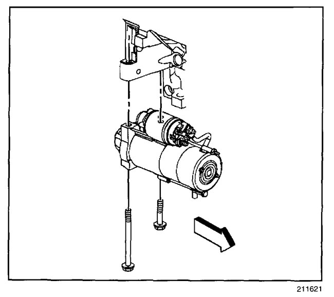

If you find there is no spark, I suspect the sensor is the issue. To replace the sensor, you will need to remove the starter, which is not hard. There are only two bolts holding it in place. Make sure to disconnect the negative battery terminal before doing any of the work.

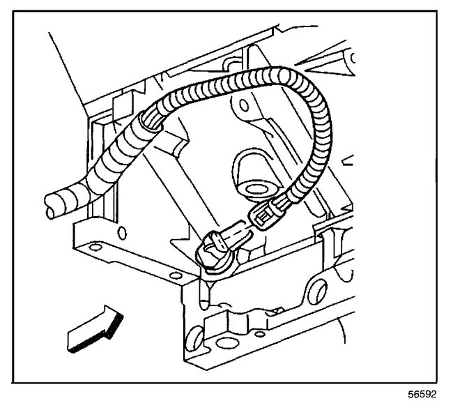

Here are the directions specific to your vehicle for removing and replacing the crankshaft position sensor. All attached pictures correlate with these directions.

REMOVAL PROCEDURE
IMPORTANT: Perform the CKP System Variation Learn Procedure when the crankshaft position sensor is removed or replaced.
CAUTION: Refer to Battery Disconnect Caution in Service Precautions.
1. Disconnect the negative battery cable.
2. Raise the vehicle. Refer to Lifting and Jacking the Vehicle.
3. Remove the starter.
4. Disconnect the crankshaft position (CKP) sensor electrical connector.
5. Clean the area around the CKP sensor before removal in order to avoid debris from entering the engine.

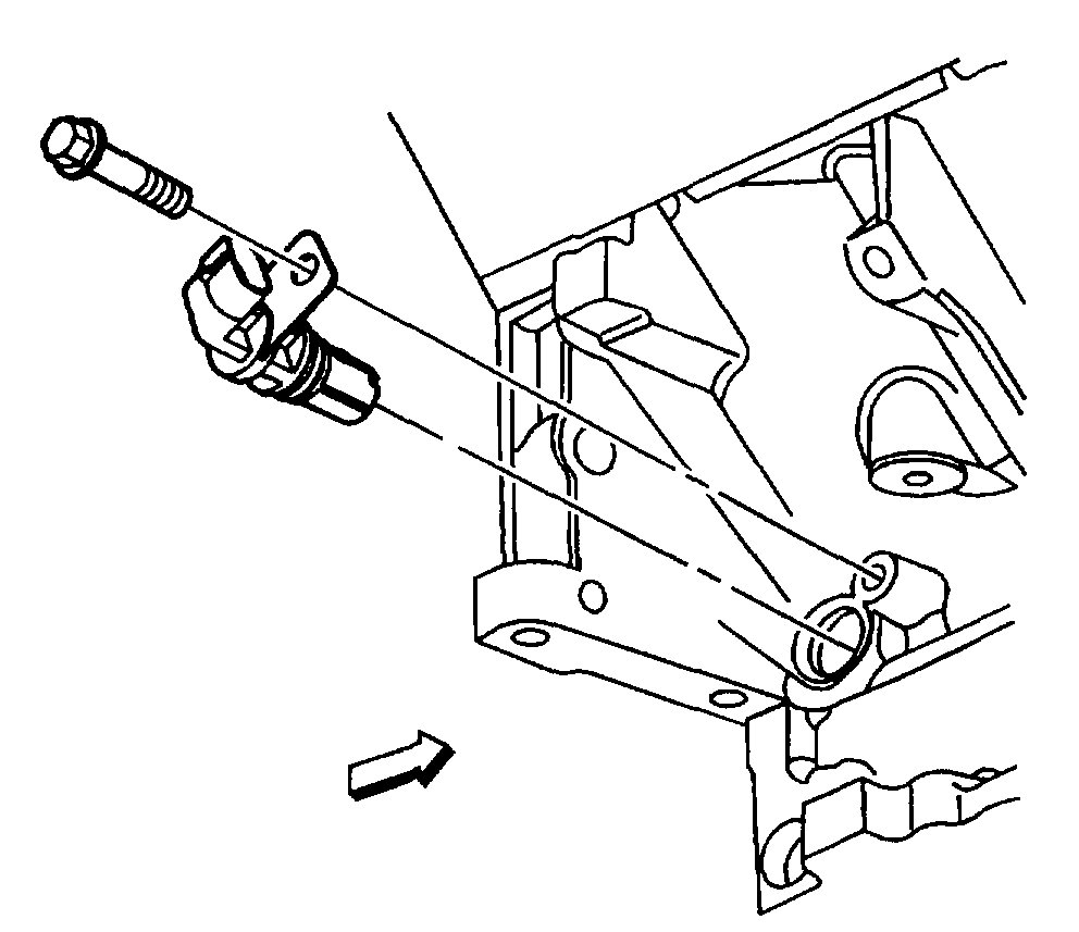

6. Remove the CKP sensor retaining bolt.
7. Remove the CKP sensor.
INSTALLATION PROCEDURE
1. Install the CKP sensor.
NOTE: Refer to Fastener Notice in Service Precautions.
2. Install the CKP sensor retaining fastener.
Tighten
Tighten the bolt to 25 N.m (18 lb ft).
3. Connect the CKP sensor electrical connector.
4. Install the starter.
5. Lower the vehicle.
6. Connect the negative battery cable.
7. Perform the CKP system variation learn procedure. See: Vehicle > Programming and Relearning
