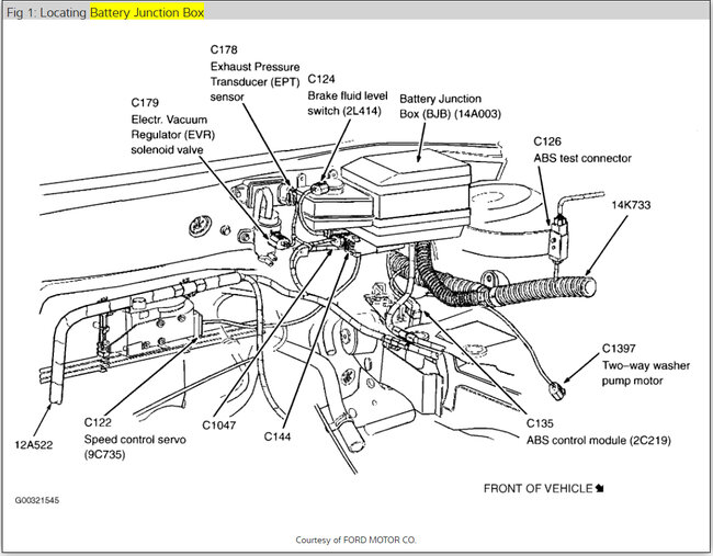

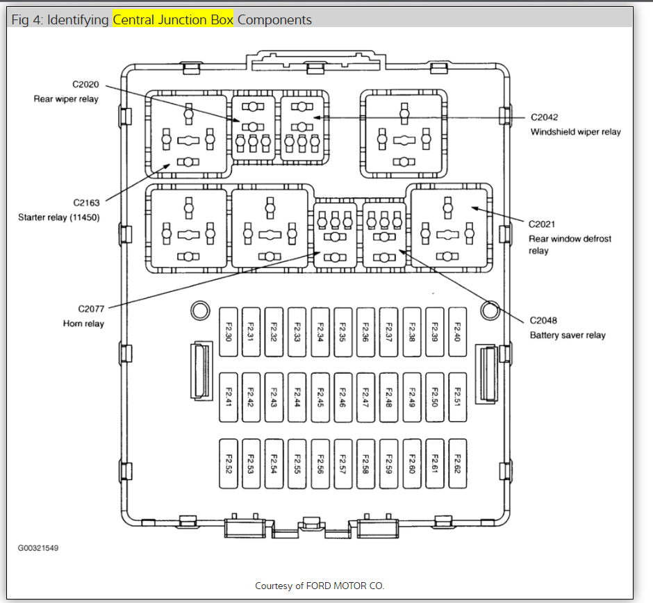

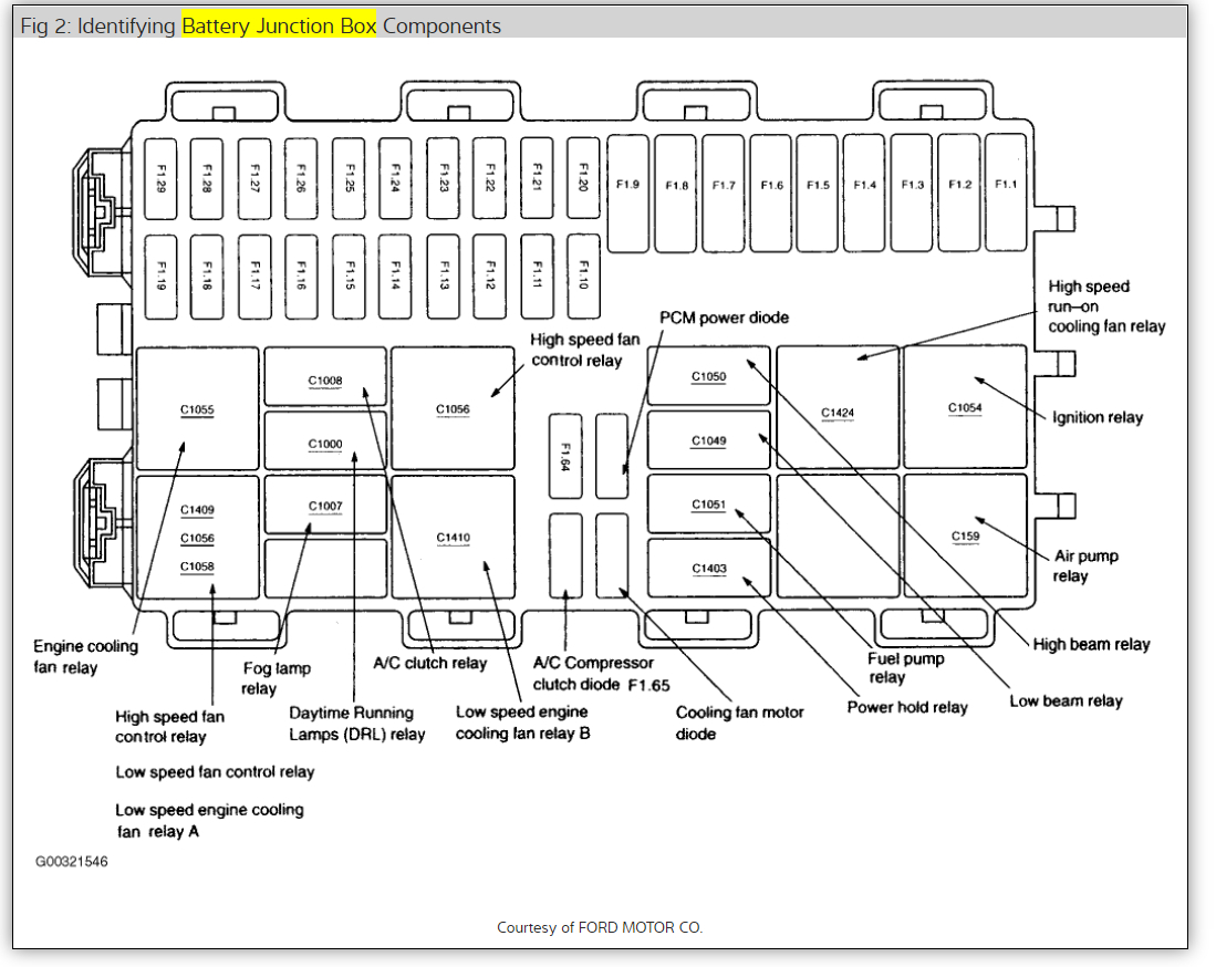

Shut off while driving, gauges, ignition, headlights, and brake lights not working?
160,975 MILES • 2.0L • 4 CYL • 2WD • AUTOMATIC
RENEE BAGNALL
The only things working are the dome lights and dinger.

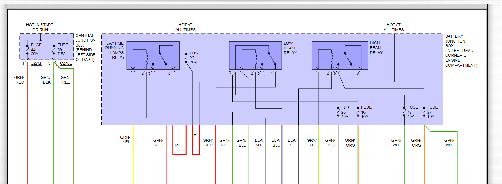

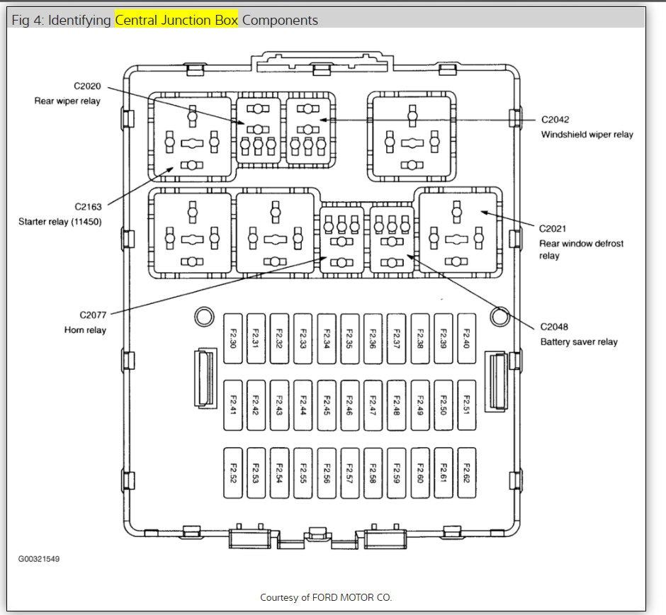

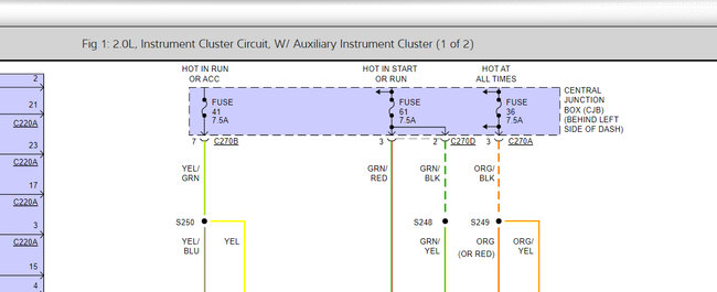

The first thing we need to do is check the fuses for power. here is a guide to help and the fuse locations. also, I have included the fuses you should check with the key on.
If these fuses do not have power the central junction box will need to be replaced. Check out the images (below). Let us know what happens and please upload pictures or videos of the problem so we can see what's going on.
