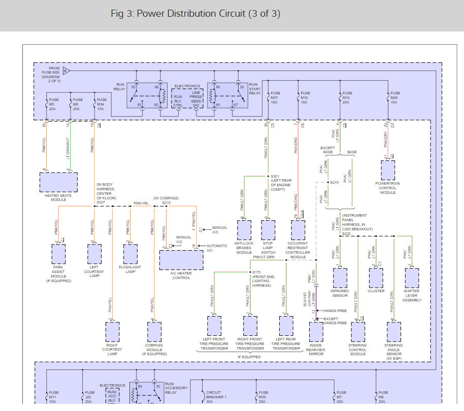

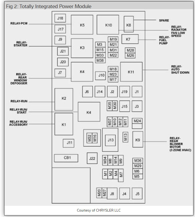

The vehicle shut off on the interstate and the gauges were going crazy. I replaced the battery, and made sure it had fuel. The vehicle still will not start. It will crank but will not start.
Sep 13, 2018 at 9:15 AM
  • 55,748 POSTS

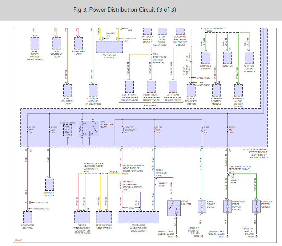

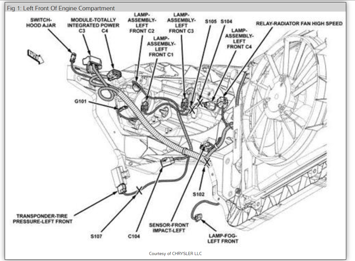

It sounds like you lost a ASD or run relay in the TIPM under the hood. Here is a guide to help you test the relays and the wiring diagrams so you can see how the system works:
