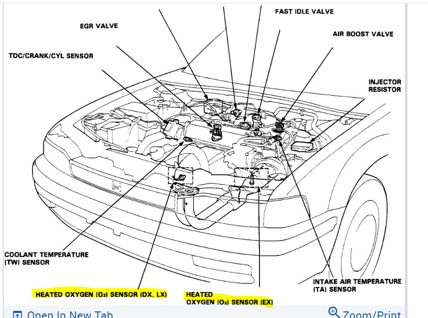

I noticed RPM needle was jumping around. Coasted off the freeway, check engine light came on when I tried to start again. Wouldn’t start, got it towed home. Off the truck, started, no engine light, but noticeable exhaust leak. Starts every time, exhaust leak. No problem whatsoever before this happened. Thank you in advance.

If the tachometer was jumping around, it sounds electrical. Have you checked to make sure the primary ground between the battery and the engine is in good condition, tight, and free of corrosion?
Also, here is a link that explains how to retrieve codes from the OBD1 system on this vehicle. Do this and see if anything is stored.
https://www.2carpros.com/articles/honda-car-1990-1995-obd1-code-retrieval-procedure-and-definition-table
One other question. Was the exhaust leaking after it happened but not before? Please explain.

Hey Joe, when I realized the car had lost power, is when the RPM needle was jumping around. The car starts fine now, but there is an exhaust leak. Just not sure where to start troubleshooting, get into the exhaust system? Curious why that would happen.

Do you know where the exhaust leak is located? For example, is it before or after the catalytic converter?
I ask because if the car lost power and now it runs well but has a leak, the converter may have been the issue (plugged).

The leak is coming from the exhaust manifold area, haven’t been able to pinpoint exactly. Debating if I should tear into it or take it to a shop.

The worst part would likely be if you need to remove the manifold. The bolts/nuts are likely rusted and may give you a hard time.
On the other hand, it still doesn't make sense. Do me a favor. Check to see if the oxygen sensor is still on the exhaust. Maybe it came out.
I attached a pic below. There are two possible locations based on the vehicle model. Check to see if it is there.
See pic below.
