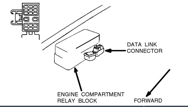

Where do you find the OBD connection at anyway?

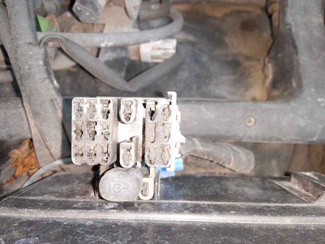

Is this it?
Sep 17, 2020 at 1:04 AM
That is correct.
That is really dirty and corroded and needs to be cleaned.

How do I clean it?
Sep 17, 2020 at 1:13 AM
MS THUMPER
  • 19 POSTS
Can't get obd reader until tomorrow.
Sep 17, 2020 at 1:14 AM
You will need terminal cleaner from a parts store with a small wire brush.
Take off a negative battery cable and spray the cleaner into the contacts and let it sit for a few minutes. then use the wire brush and clean up the corrosion. then wipe it out with an old rag and let it dry before re attaching the battery cable.

What is the best way to clean it without causing damage to it?
Sep 17, 2020 at 1:37 AM
MS THUMPER
  • 19 POSTS
Can I use contact cleaner on it?
Sep 17, 2020 at 1:38 AM
MS THUMPER
  • 19 POSTS
Whatever is in it is really sticky.
Sep 17, 2020 at 1:41 AM
Clean it off real well. Right now, you cannot get a good connection for plugging into that connector.
Sep 17, 2020 at 1:42 AM
