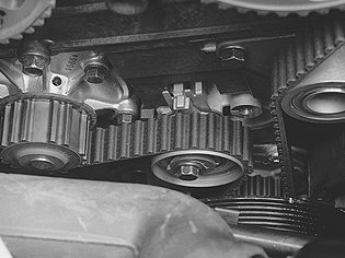

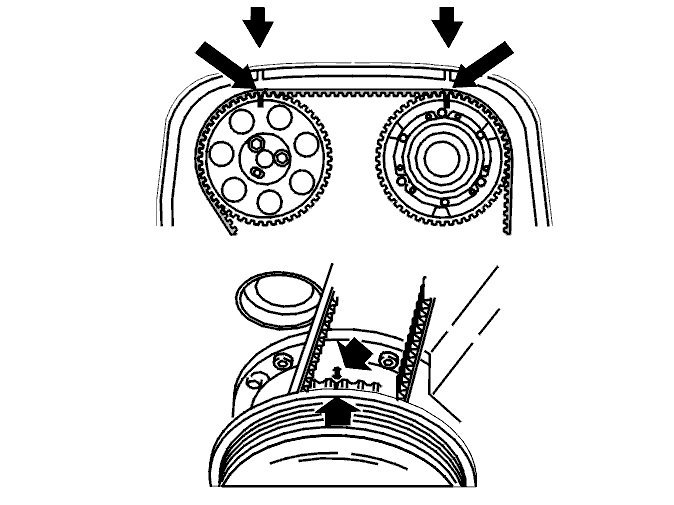

Is there a timing mark on the back side of the cam I can use to do the timing?
Jun 15, 2018 at 11:26 AM
  • 110,241 POSTS
There should be marks for timing on the pulley. Is it possible you put it on backwards? Regardless, here are the directions specific to your vehicle from alldata. The attached pictures correlate with these directions. Take a look.

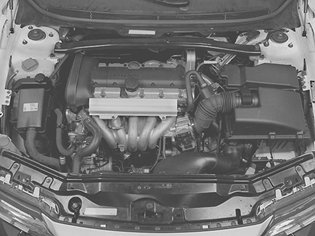

Remove components
Caution! Remove the ignition key.
Remove:
the cross stay between the suspension turrets
the upper camshaft belt cover
the servo reservoir and expansion tank.
Lift them up and place them on top of the engine

Position the engine according to the marking
Remove the right front wheel.
Remove the nut from the cover in the fender liner.
Install the upper camshaft belt cover.
Turn the crankshaft clockwise until the markings on the crankshaft and camshaft pulley correspond.
Turn the crankshaft a further 1/4 turn clockwise and then back again until the markings correspond. The markings are illustrated.
Remove the upper camshaft belt cover.

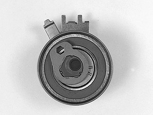

Slacken off the belt tensioner.
There are two variants of the belt tensioner.
Up to engine number 3188688 the eccentric must be turned clockwise when loosening.
From engine number 3188689 the eccentric must be turned anticlockwise to loosen the belt tension.
Slacken off the belt tensioner center screw slightly.
Hold the center screw in position and, depending on the variant, turn the eccentric on the tensioner to 10 o'clock (clockwise) or 2 o'clock (anticlockwise) using a 6 mm allen key.

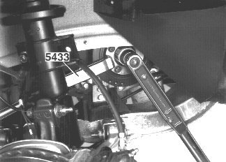

Remove the vibration damper.
Remove the oscillation damper. Use counterhold 999 5433 COUNTERHOLD See: Tools and Equipment999 5433 Counterhold. Work the oscillation damper loose.

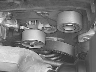

Checking the tension pulley and idler pulley
Check for bearing wear:
Spin the idler pulley and listen for noise. If replacing with a new idler pulley, tighten to 24 Nm .
Spin the tension pulley and listen for noise. When replacing, screw the tension pulley into place with the center screw.
spin the tension pulley and listen for noise. If replacing, screw the tension pulley into place with the center screw.
Screw in the center screw by hand.
Ensure that the tensioner fork is centered over the cylinder block rib.
Ensure that the allen hole on the eccentric is at "10 o'clock".

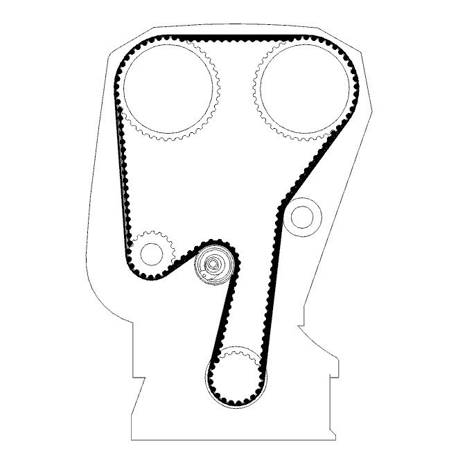

Install the camshaft belt over pulley wheel on the crankshaft.
Install the oscillation damper. Tighten the center nut to 180 Nm . Use counterhold 999 5433 COUNTERHOLD See: Tools and Equipment999 5433 Counterhold.
Remove the counterhold and install new screws. Tighten the screws to 25 Nm . Angle-tighten 30°
Install the new belt in the following order:
crankshaft
idler pulley
intake camshaft pulley
exhaust camshaft pulley
water pump
belt tensioner.

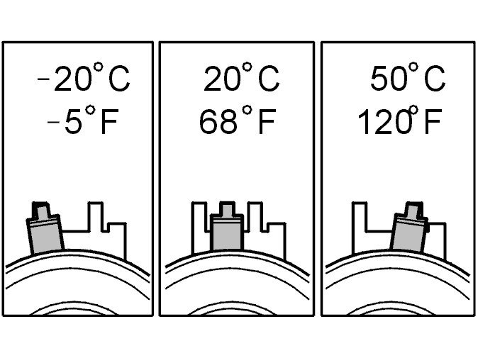

Tighten the timing belt
This adjustment is to be made with a cold engine. A suitable temperature is approximately 20°C/68°F.
At higher temperatures, for example with engine at operating temperature or at higher ambient temperature, the needle is further to the right.
The position of the needle, when aligning the camshaft belt tensioner at different engine temperatures, is shown in the illustration.

hold the center screw on the belt tensioner in position and turn the eccentric on the belt tensioner clockwise/anticlockwise, depending on the variant, until the tensioner's needle passes the marked position.
Then turn the eccentric back so that the indicator reaches the marked position in the center of the window.
Secure the eccentric and tighten the center screw to 20 Nm .
Check that the needle is in the correct position.

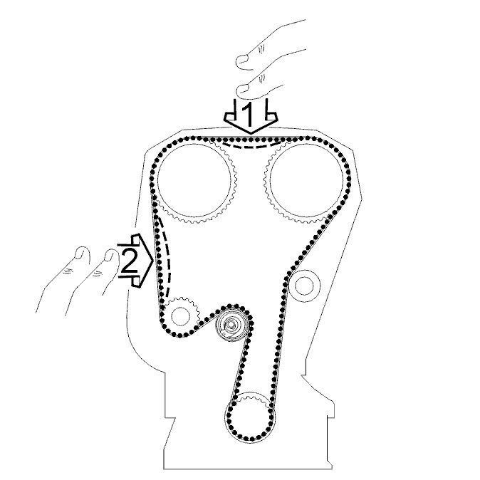

Check
Checking markings:
press the belt to check that the indicator on the tensioner moves easily.
install the upper timing belt cover.
turn the crankshaft 2 turns and check that the markings on the crankshaft and camshaft pulley correspond.
check that the indicator on the belt tensioner is within the marked area.
