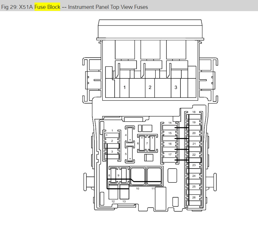

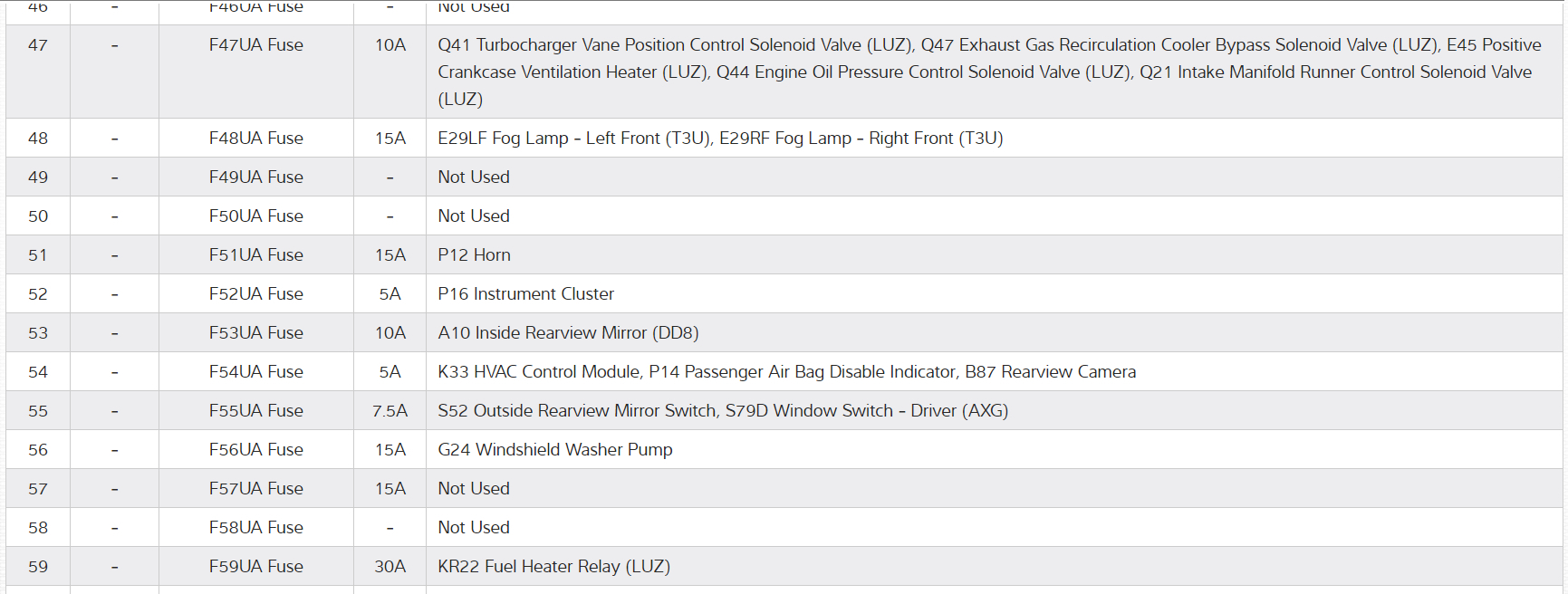

My DIC lights up but I can't change like metric to US. I can't change anything. I can change screen to screen that is about it.
Jun 16, 2019 at 11:23 AM
  • 55,433 POSTS

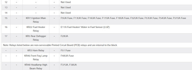

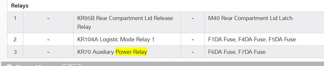

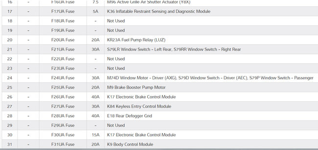

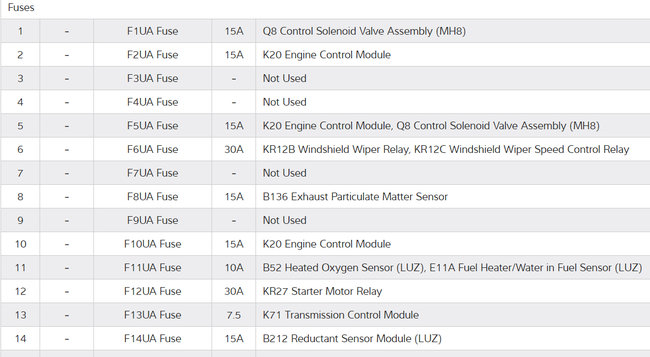

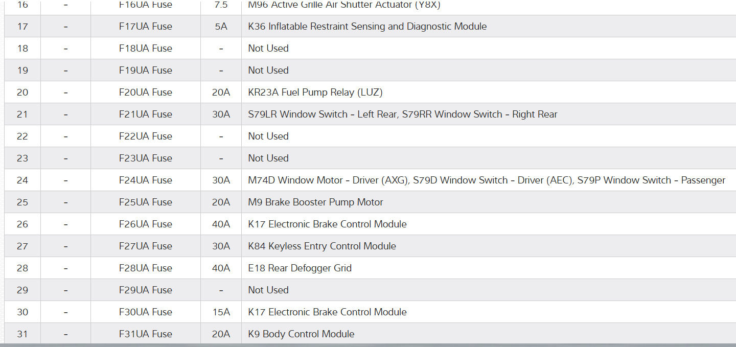

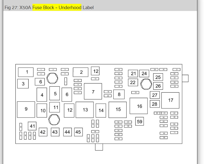

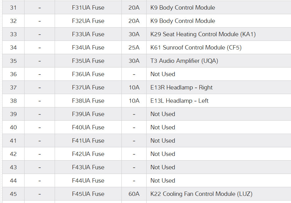

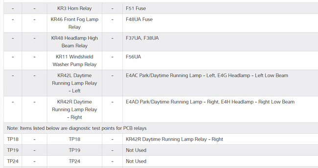

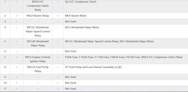

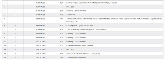

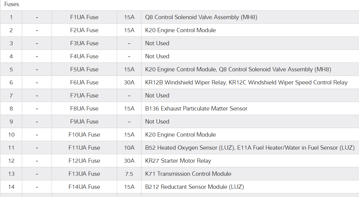

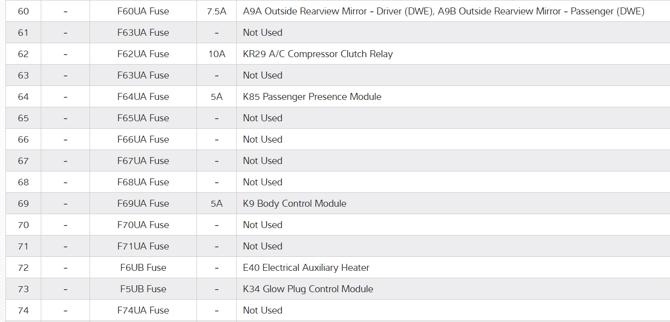

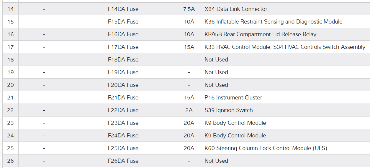

It sounds like you have a fuse out can you please check fuse # 52 5 amp in the under hood fuse panel? Here is a guide and the fuse location:
Jun 18, 2019 at 11:34 AM
ROB7267
I pulled the #52 fuse it is good what else can I do? The DIC works i just can't change anything.
Jun 20, 2019 at 4:00 AM
  • 55,433 POSTS

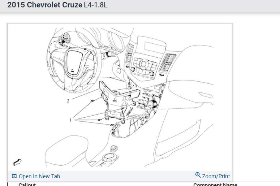

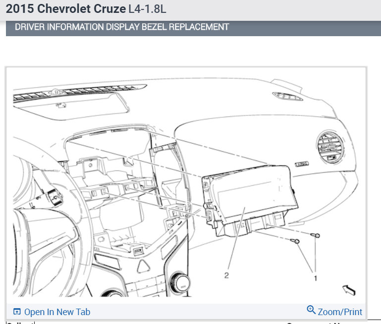

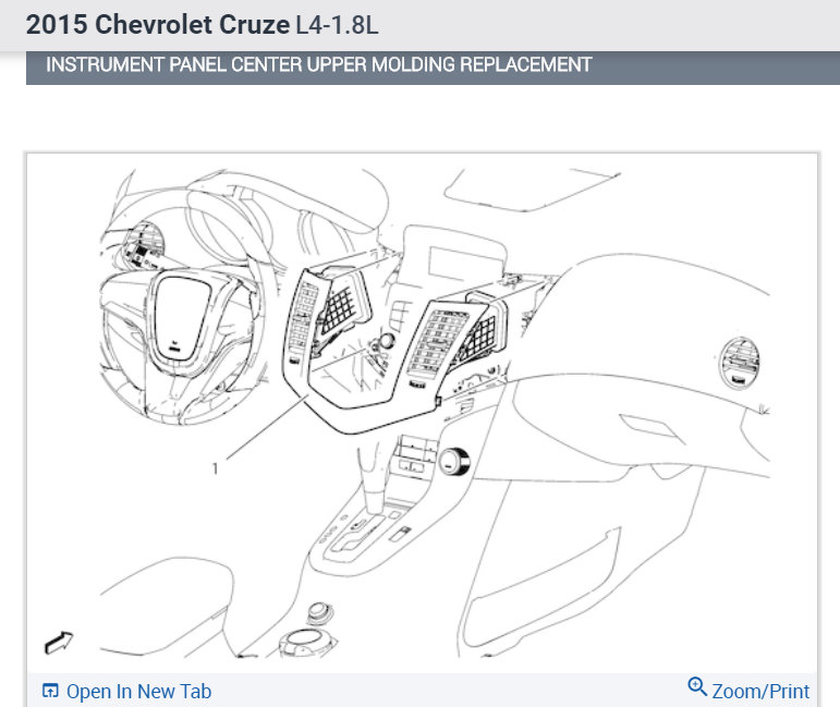

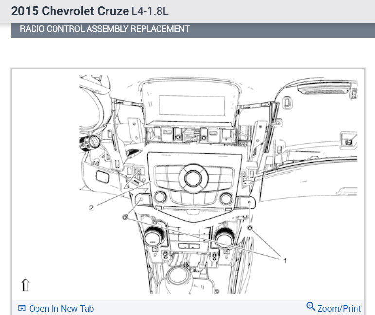

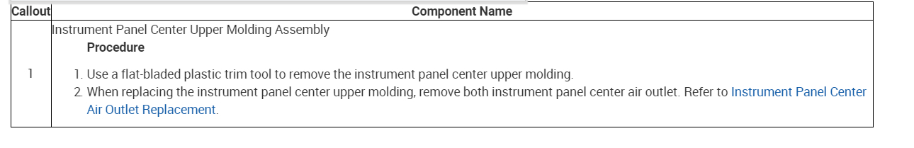

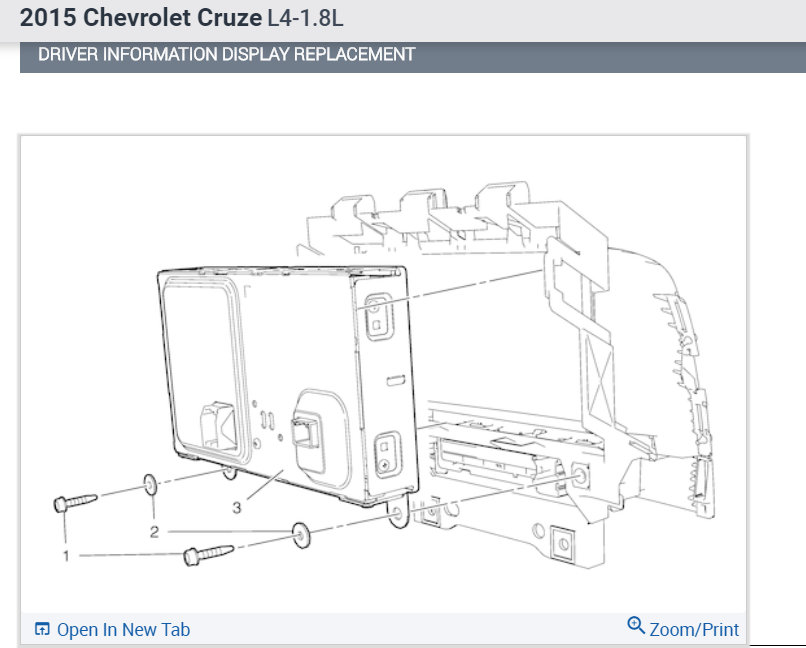

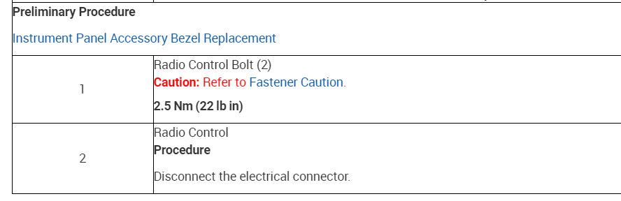

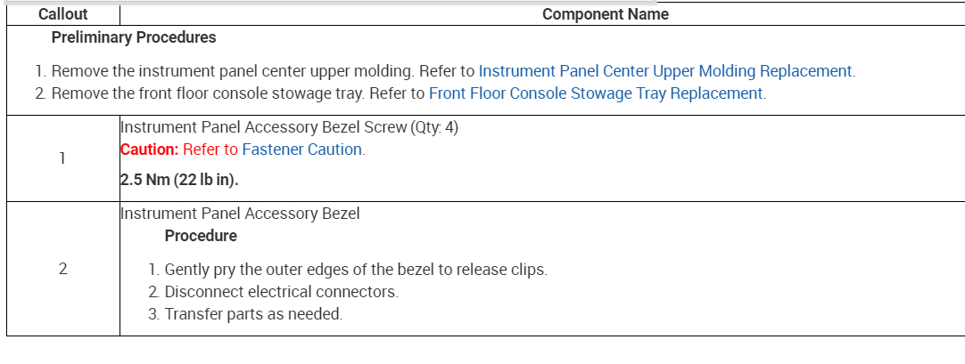

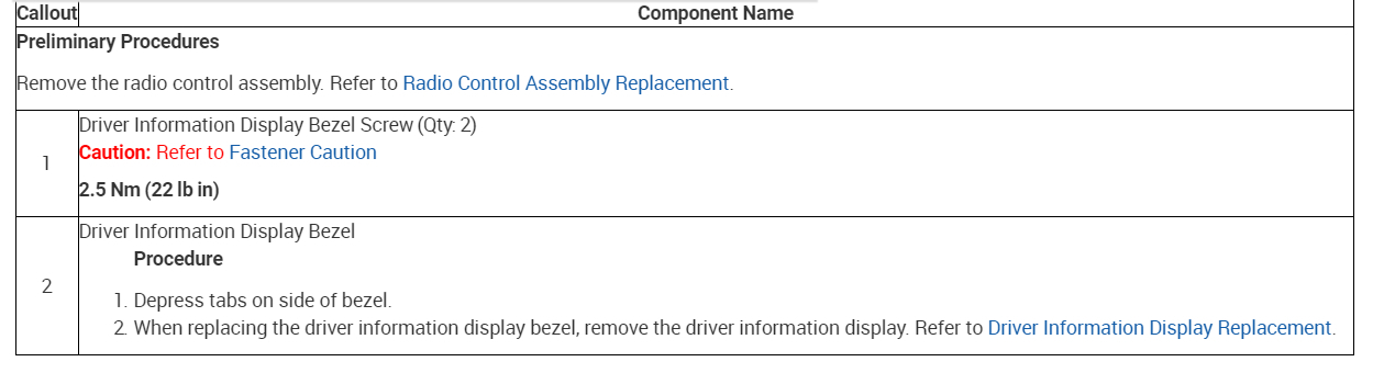

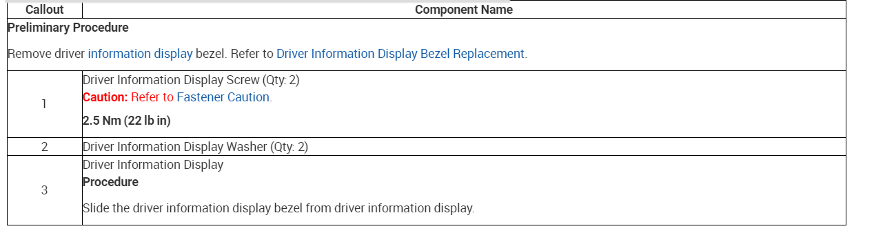

Okay, it sounds like the drivers information module has gone out here are instructions and diagrams to show you how to replace it. Also it should self initialize. Check out the diagrams (below). Please let us know what happens.
