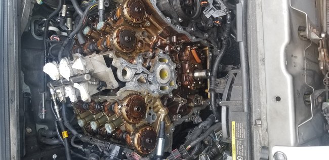

My car will not start. I took it to Cadillac and they said that a bearing on my crankshaft spun. I have changed the timing chain on the car myself hoping it would fix the problem. That was an epic fail.
I can take all the parts off up to that point put I would so love a diagram on how to take the crankshaft out from there. Thank you.
Aug 23, 2018 at 10:09 AM
Good morning.
Are you prepared for this? You need to remove the engine from the car and put it on a engine stand. Then you will need to disassemble the entire engine down to the crankshaft.
This is a major job and you may have well rebuild the entire motor as you will have it all apart.
