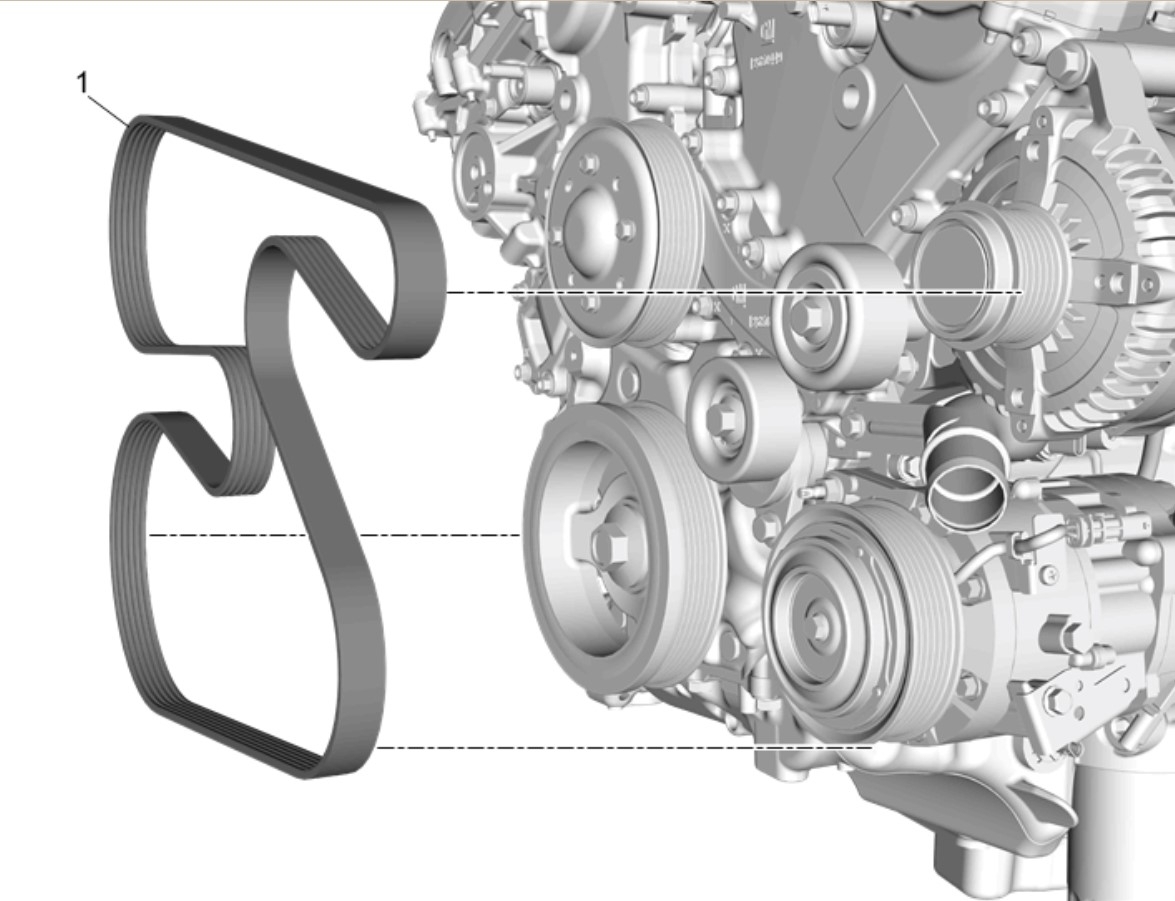

Looking for the layout of the Cadillac xt5 serpentine belt.

This is the 3.6 belt routing.
