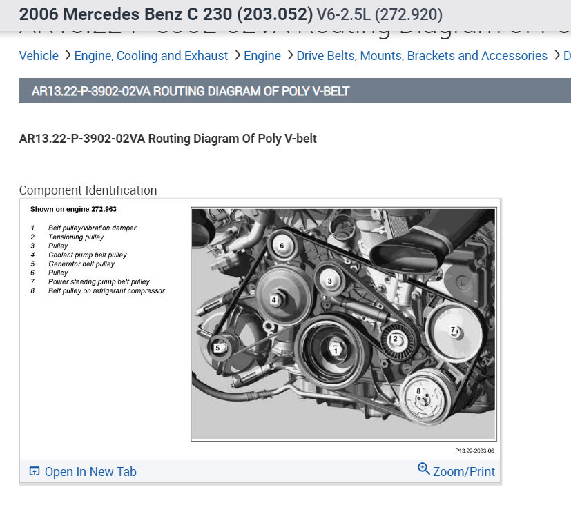

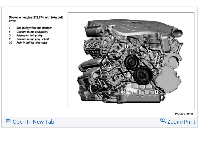

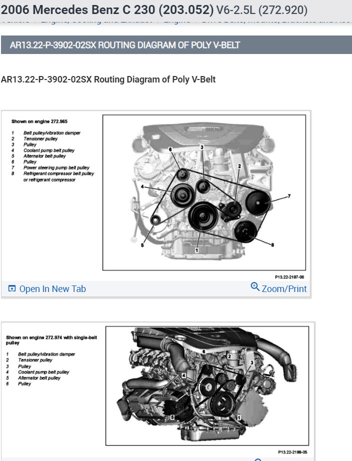

I need a diagram of a Mercedes C230 2006 serpentine diagram of the Sport edition.

Sure, here are the serpentine belt routing diagrams so you can see how the installation is done. Check out the images (below). Please let us know if you need anything else to get the problem fixed.
