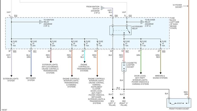

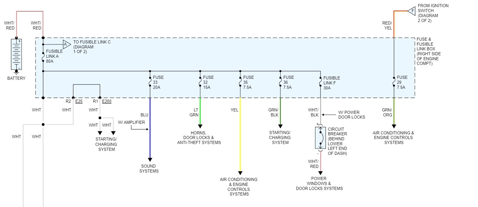

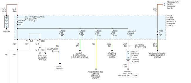

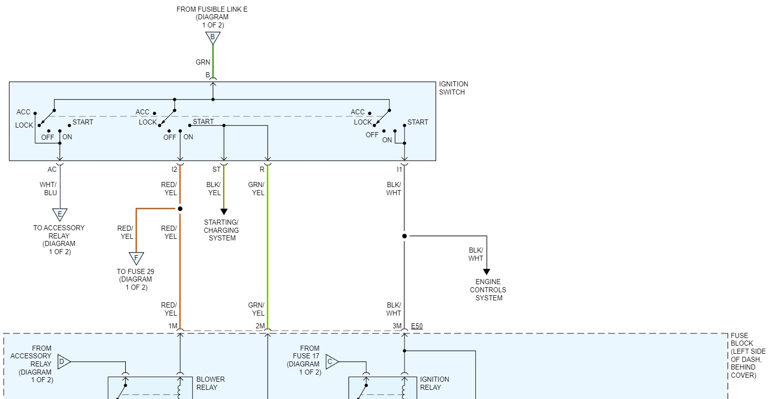

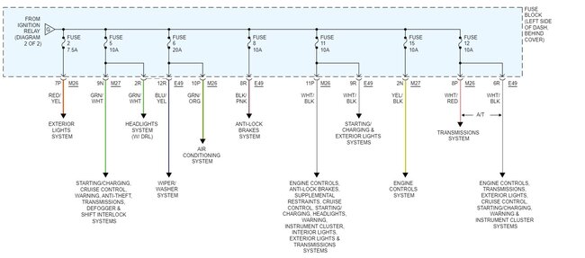

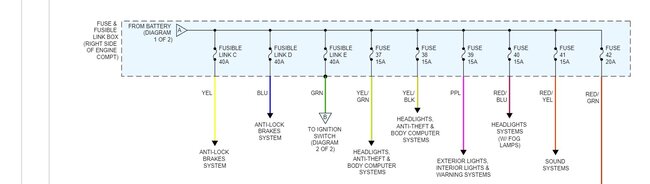

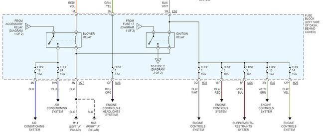

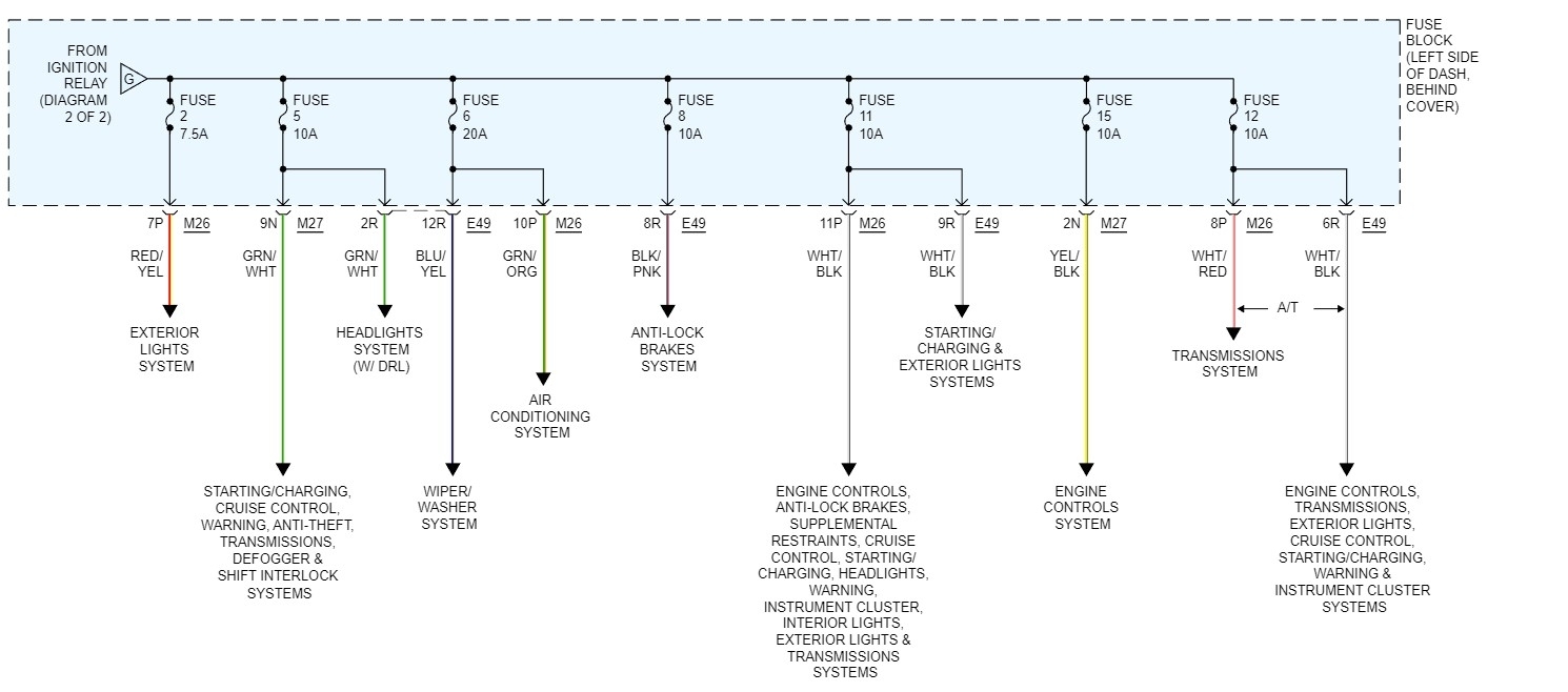

diagram of fusee panels and relays needed?
2004 NISSAN FRONTIER
262,000 MILES • 2.4L • 4 CYL • 2WD • AUTOMATIC
DODGEBALLGUY
I can't find a diagram of fuse panel and relay switches for the vehicle listed above XE. I'm wanting a very detailed list of what each fuse and each relay protect.
Dec 4, 2022 at 8:26 AM
STEVE W.
  • 15,347 POSTS
These are the diagrams for the fuse box and its relays. What is the issue you are having?
Dec 4, 2022 at 10:23 AM
