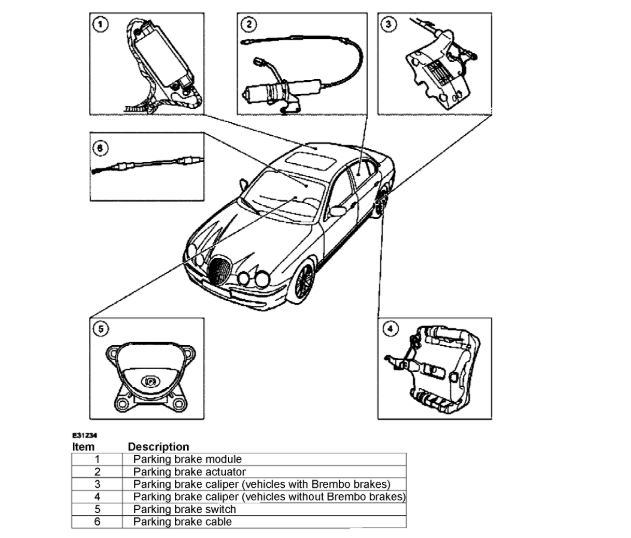

I found a picture for you to view plus a description of how it works.
Hope this helps
Electric Park Brake
The operation of the electric parking brake (EPB) system, is by a pull/push switch, (pull for parking brake activation and push for parking brake deactivation), which is mounted on the floor console. The EPB calipers are activated via cables by an electric motor and actuator unit which is mounted on the rear subframe. Overall control of the EPB is from a control module which is located in the luggage compartment behind the right-hand rear luggage compartment trim panel. On vehicles without Brembo brakes, the parking brake is achieved through the conventional rear brake pads.

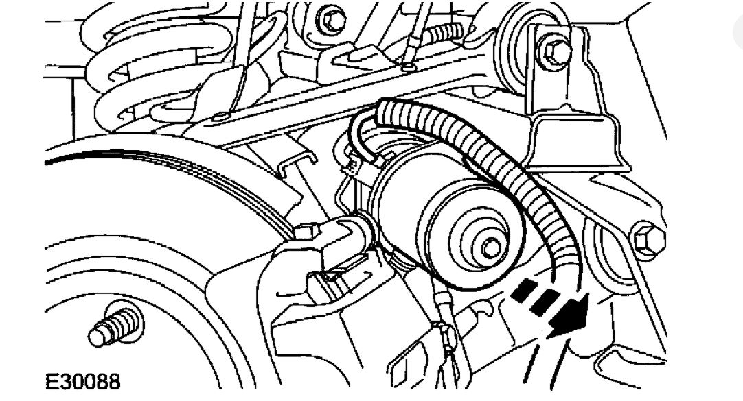

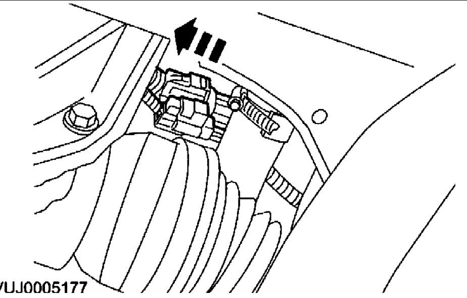

3. Disconnect the parking brake release actuator electrical connector.
ImageZoom/Print

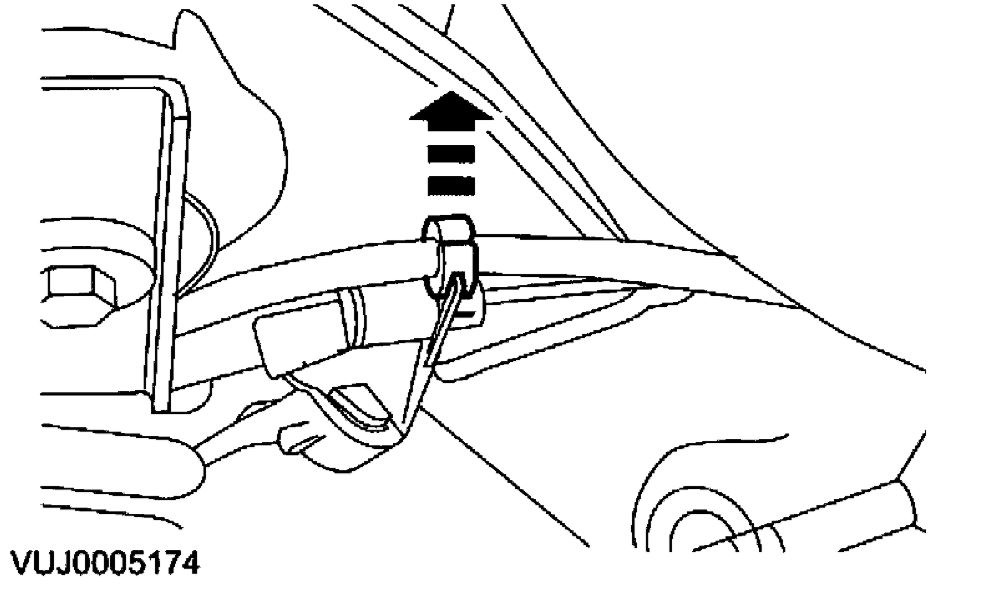

4. Detach the parking brake release actuator wiring harness retaining clip.
ImageZoom/Print

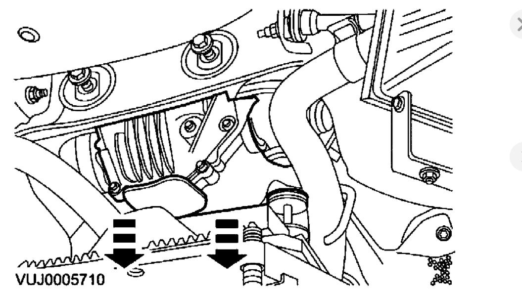

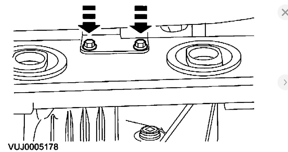

5. Remove the parking brake release actuator retaining bolts.
ImageZoom/Print

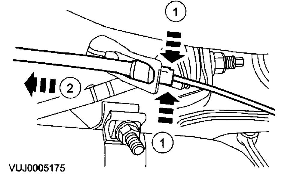

6. Detach the parking brake cable.
1. Reposition the retaining tang.
2. Detach the parking brake cable.
ImageZoom/Print

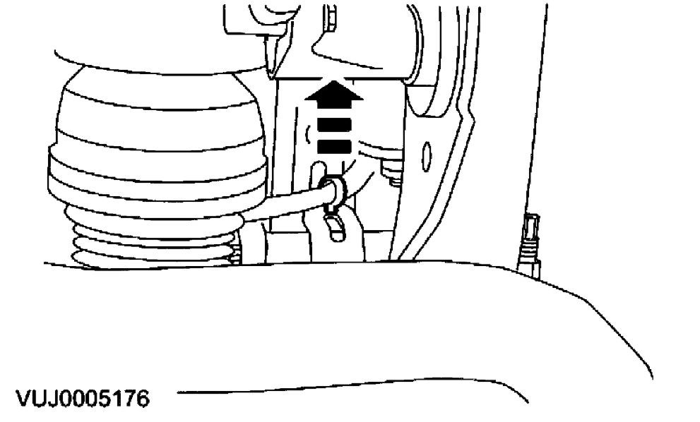

7. Detach the parking brake release actuator cable.
ImageZoom/Print
8. Detach the parking brake release actuator cable.
1. Release the retaining tangs.
2. Detach the parking brake release actuator cable.
ImageZoom/Print
9. CAUTION: Place a suitable support stand under the axle assembly.
Remove the axle assembly retaining bolts.
ImageZoom/Print

11. Remove the parking brake release actuator.

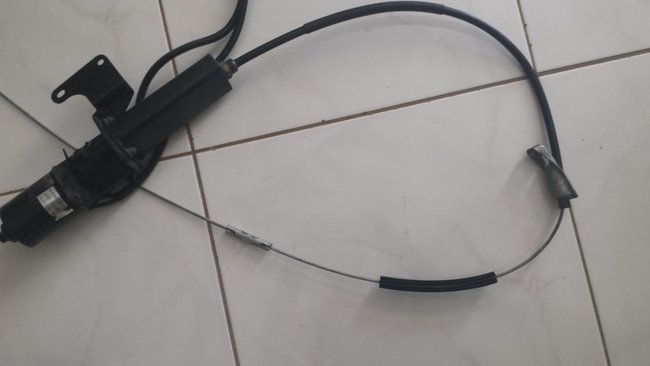

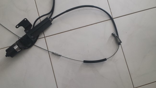

Hello, thanks but I just want to know how the cables connect and I want to know the bending position of the cable or how to bend it to connect to the other two cables. See images below please. Thanks.

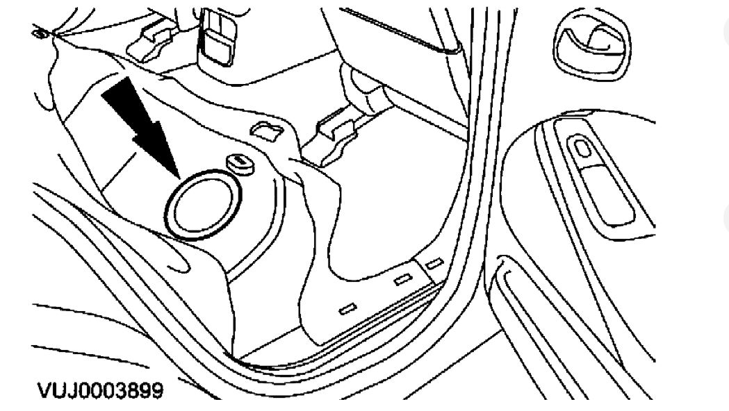

Hello good evening, can you tell me which side the fuel pump is located on? The car is left hand drive. I want to do a fuel pump replacement. Thanks
Wednesday, August 1st, 2018 AT 1:57 PM
  • 52,797 POSTS
The pump is on the right side under the rear seat cushion. There is a plate that you pop up and you will have access to the pump.

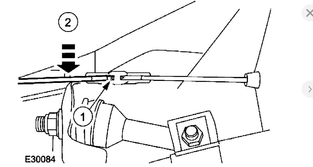

Been a while but as I recall the cable comes out and just loops in a U then turns so it is parallel to the rear axle. The cable connects between the P-Brake cables coming out of the park brake calipers. The adjusters need to be backed off and the actuator fully released using a specific tool that actuates the motor to release pressure prior to installing the cables. If I recall you can get it to release by applying power to the actuator as well. One direction retracts it, the other releases it. That is done at the control module connection in the trunk. The two connections should be in the wiring for the brakes, Green and Red come to mind, they are the larger wires.
Then it should prompt the owner on initial start to activate the brake to take out any slack. If not you disconnect the battery cable for 45 seconds, reconnect it, start the car, step on the brake 5 times and it should tell you it isn't calibrated. Step on the brake and apply the EPB, release the EPB then the pedal. Apply the EPB 5-6 times to verify no error codes.
The cables slip into notches in the two connectors. One end is a simple barrel that snaps into a sleeve 2, The other goes into a slot and snaps into place 1.
Not sure if that's any help. Jag uses the same system on a few vehicles (as does Ford)
