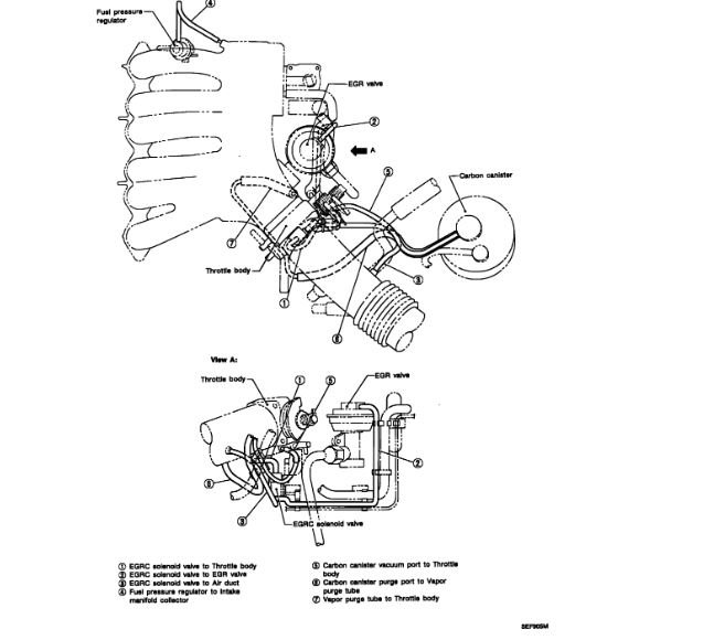

Diagram of crank and cam sensor location and vacuum hose connections

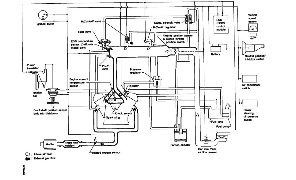

I still would like to know where the timing sensors are located and a diagram of the vacuum hoses.
Oct 25, 2018 at 8:32 AM
Okay, sorry. You did not state that in your post.
I will get them for you but that will not cause a miss like you have at the moment.
Oct 25, 2018 at 8:36 AM
Attached is the wiring and vacuum diagram you requested.
As far as the crank and cam sensors, you have a distributor. This means there is no crank and cam sensors as the distributor serves as both.
