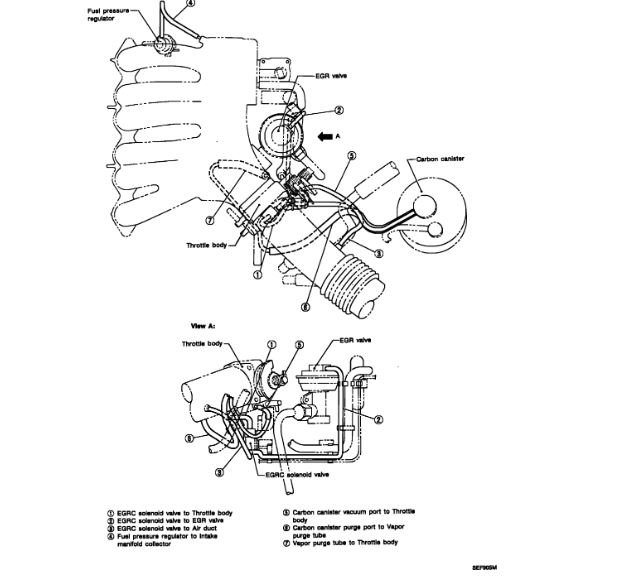

Suspect bent valves but want to make sure every thing is connected. Replaced timing belt belt had missing teeth engine starts and runs but is rough. Does not make any metal on metal noise. If all connections are okay I will do compression test next.

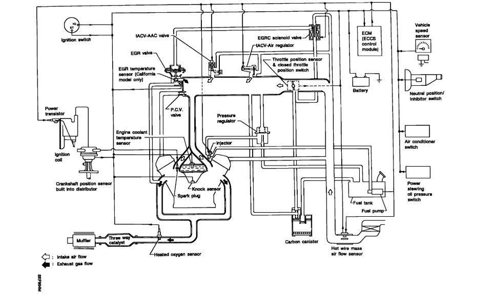

I still would like to know where the timing sensors are located and a diagram of the vacuum hoses.
Oct 25, 2018 at 8:32 AM
Okay, sorry. You did not state that in your post.
I will get them for you but that will not cause a miss like you have at the moment.
Oct 25, 2018 at 8:36 AM
Attached is the wiring and vacuum diagram you requested.
As far as the crank and cam sensors, you have a distributor. This means there is no crank and cam sensors as the distributor serves as both.
